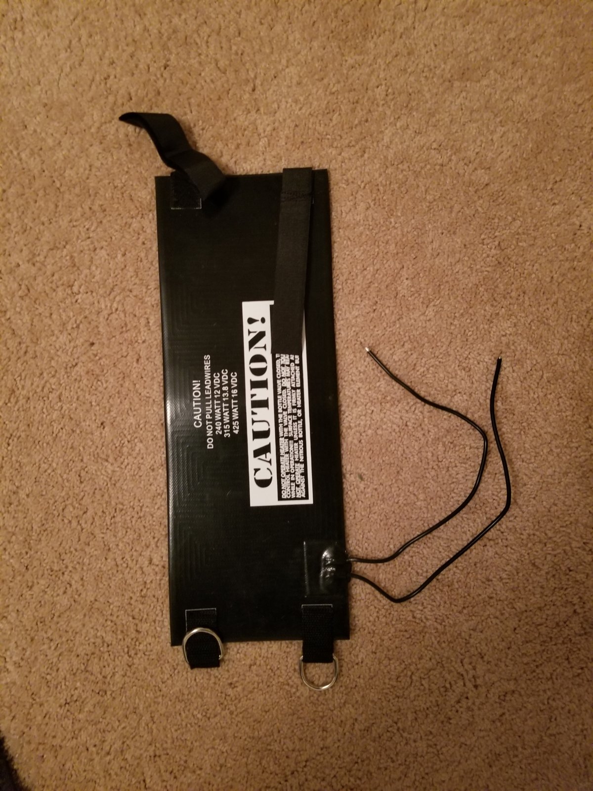

Got a bottle heater. Hopefully will bring faster and more consistant times. Still wanting to do a mild rebuild with 95tm heads and the 422 but likely won't have the time till at least this summer.
