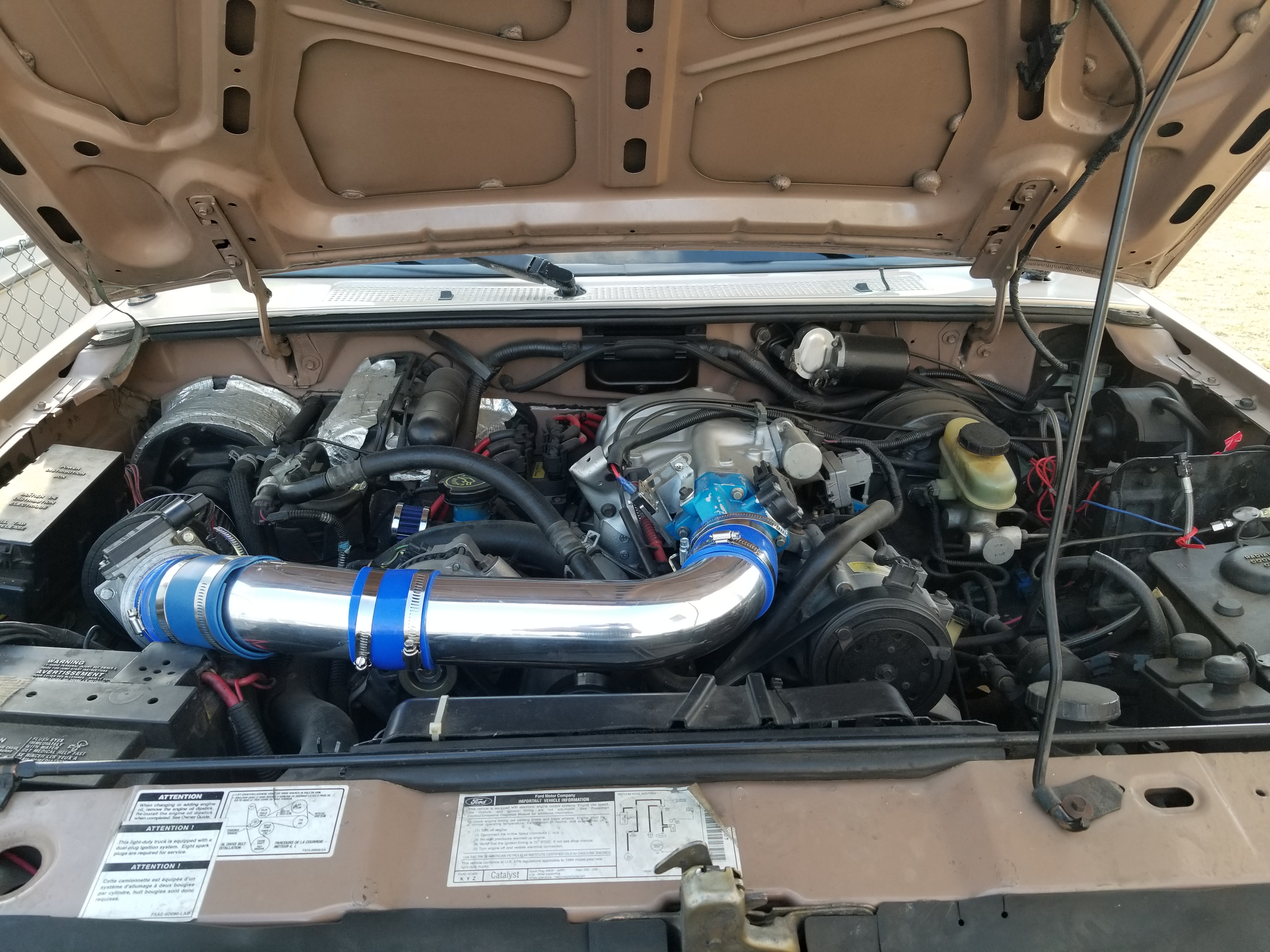

New intake is on. Works well with the BBK throttle bottle.
Two week ago I mailed in my solenoids to Nitrous Express. Once I get that back I plan on putting that back on as well as the bottle heater. April 14th is Julesburg Dragstrip's opening weekend. I'm hoping I'll be able to make it out there and make some runs at the lower elevation.

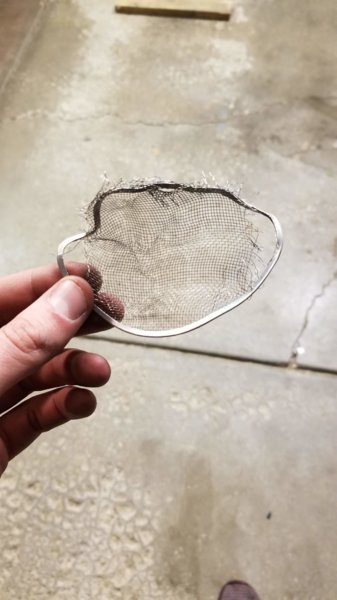

Scary night out at the track last night, came too close to destroying my engine. First run was solid, ran a 16.28 at 83 MPH. The next run I missed second gear and heard a loud pop which was my intake tube blowing off resulting in the wire mesh from the MAF becoming stuck inside the throttle body. Pretty scary. Is it safe to drive without that wire mesh in the MAF? I'm gonna go to the junkyard today to see if I can find a replacement..
