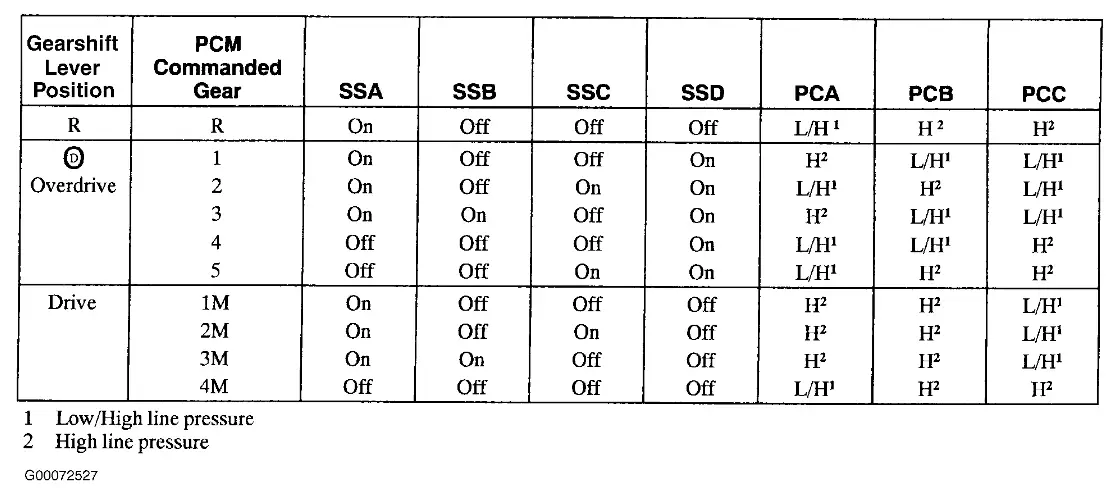

Does this sound like a bad solenoid, bad servo, bad band or bad servo....?
