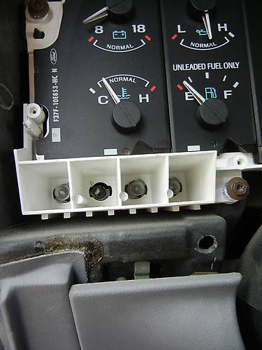

Lol! I actually just replaced the check engine light bulb today! How would you know to replace it if you always want it off anyways?
Before:
After:
The Charred Remains
There is always a possibility the light has gone the way of the Dodo. As far as the not running part there is also a chance that a silly battery fuse has burned out. I had one and couldn't figure out why it would barely run while showing super low amps on the battery. Turns out a cheap 10 cent fuse had burned out in the main fuse box.
Hope this helps!
After throwing up my hands and walking away from the project for a while I dismembered the dash (what a PITA) and found the CEL to be burned out. I replaced it and now have a CEL. Turn the key to the on position and it stays on until you turn the key off. Is that a good thing?
