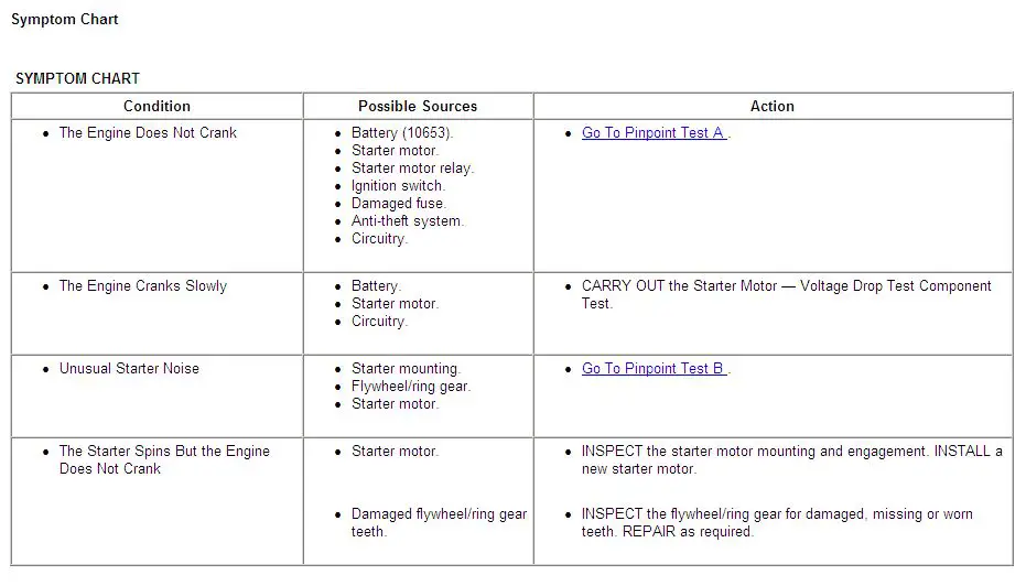

Here's the ford no star no crank procedure:

I think A11 in the pinpoint test above is a bypass, right?
