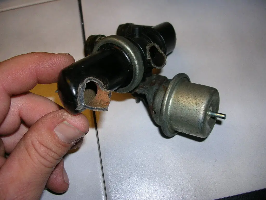

not sure if 92's came with a heater core de-verter valves.located right at the connection point that the heater core lines run through the firewall to the core . the valve is vac' operated and if the vac line is off it may be sending coolant back ....replaced mine last year lucky for me it died in the driveway instead of on the road.
idk ...your saying that the line only gets hot till a certain point on / in the hose that leads to the core ?? and that line is totally clear from cloggs ...is that right ?
maybe if yours does have the valve and if it is shut and not letting coolant back maybe the heater core it's self was not burpered from any air in and the pressure of the coolant trying to goto the core is getting stopped half way in the line .......here's what the valve looks like ( sorry the only pic i got and it's boke off two of it's ports ....)

Ok looked up pictures of different Explorer engine setups, and I definitely don't have that valve.
