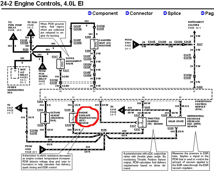

I've heard that a faulty coolant temperature sensor could be a cause for a rough idle when warmed up, is this true? And if the sensor is faulty, would the temperature gauge on the dash still function properly?
might want to clean your MAF sensor also.
IIRC, there are two separate coolant temp sensors - one provides the signal to the gauge in the instrument panel - the other one provides the signal to the PCM. The second one is called ECT (engine coolant temp) and should have two wires, a VPWR and Signal Return. The gauge sensor only has one wire, the ground is through the engine.
If the ECT is bad, the fuel air ratio may be incorrect, especially when cold, so it could affect the idle.

Ok, thanks for that dogfriend! So the ECT is located behind the thermostat housing correct? I talked to a mechanic and told him my problem and the first thing he said is to check the coolant level as if it's low it will affect the ECT and could cause problems. It's weird because before I cleaned the IAC I was having problems idling at startup but now it starts up great, idles nice and smooth for a few minutes then starts to get rough, I can feel it vibrating pretty good inside.
I think they are both in the vicinity of the thermostat housing, but the way to tell the difference is to look for the number of wires - you need the one with two wires.
