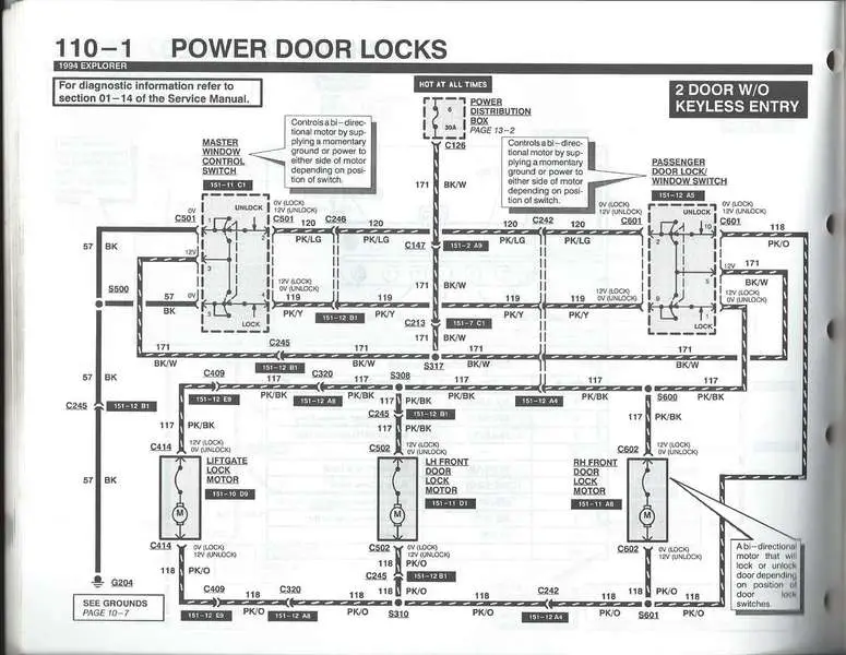

I have a 94 explorer I am trying to fix the power door locks on.I knew something was up with them when i noticed the actuators had been removed (before I bought it)..I have fixed power locks on other vehicles and it didnt really bother me they were missing as I am sure I can fix them..eventually..I am pretty sure they should always have power to them so they can be operated without the keys in the switch but when I tested with the test light at the actuator plug in there was no power,so i checked the 30A fuse under the hood and it was fine.Next I checked the contacts the fuse plugs in to and there was no power to the fuse.So now I am stumped as I do not know where its power is supposed to come from.I do not want to tear the harness apart just to track where a wire gets its power.Does anyone have an idea where to look on this issue?
