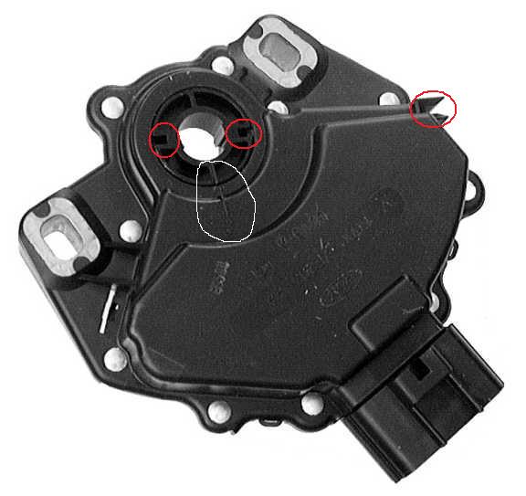

I don't think you will need a new switch as much as adjusting the one that is there.

first you need to confirm what transmission type you are, manual or automatic. Then you need to confirm that you AREN'T getting voltage at the lamps when you have it reverse. Of course, it would then be wise to see if you are getting voltage going (P/O wire) to the transmission range switch (auto) AND coming out (BK/PK wire) of said switch.
On a side note, there is no "neutral switch", only a transmission range switch IF you have a auto tranny.

i have the automatic 4R55E. As far as the volts are concerned, I havent got under there to check, but i will. According to AllData the two parts are the same thing. The transmission range senor tells the ECU its okay to start because the car is not in gear (another problem i have occasionally). However according to AutoZone the part is labeled as a neutral safety switch. I'll crawl under the truck sunday with a voltmeter and see what going on.
For automatic transmission, there is just one sensor for neutral, reverse, sender of position to PCM... It is called Transmission Range Sensor or Neutral Safety Switch.
Alignment, with the transmission on "N" should look something like this:
