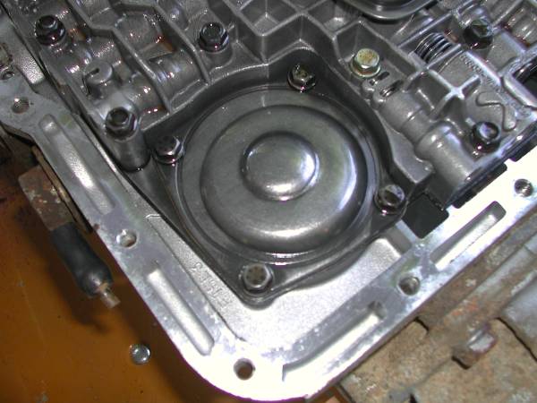

Thanks for posting the photo of the 5R55S valve body. Why does the cover have a ring?
This servo is a separate housing, the piston mounts in the housing rather than in the case. The round ring is a screen over the servo check valve to keep debris out I guess.
The only issues I have seen here is worn or hardened seal on the piston itself or the small seal in the housing. Which is what might be going on for "boominXplorer"

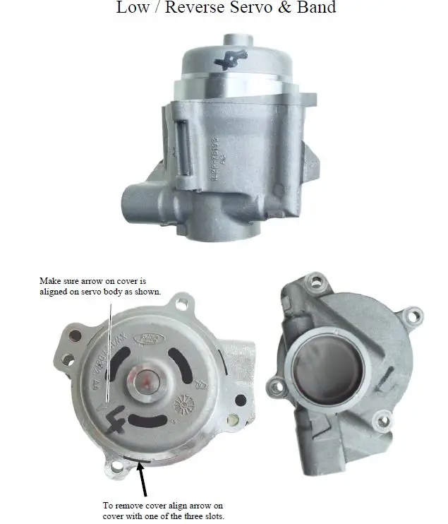

It looks like Ford went back to using a spring on this servo. Is the housing on the 5R55S used on the 5R55W & 5R55N?
Yes as far as I know they are identical and should interchange.
Having a separate servo bore is a good idea. You could replace it as an assembly if it wears out. I wonder why they didn't do this to the two servo bores on the side of the transmission that are so troublesome.
