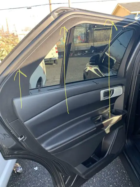

I’m experiencing a loud popping/cracking noise from the rear driver side door. The noise is observed when traveling over uneven pavement. It sounds as if adhesive is separating and reconnecting. I took the vehicle to a local Ford Service center. Technician there acknowledged the problem and took the panel apart. He said that he didn’t see anything wrong and that similar models also made the noise. If I push on the panel itself near the window, it sounds as if there is a gap where the window sun screen is. Has anybody else experienced this noise or found a way to fix it?

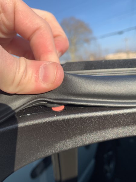

Not sure if anybody else was having this problem? I started taking things apart and realized what the issue was. The foam/rubber on the door is held in place by pink plastic “trim panel retail clip” type of things. When they move, they scrape the panel and make noise. I took the foam/rubber off, cut and slid tiny orings under the gap and used gorilla tape to make the clips immobile. Drastically reduced the noise (from the door panel area). Rubber retaining clips would have also eliminated this problem. Two Ford service centers were unable to determine what the noise was and either said “unable to duplicate” or “characteristic of the vehicle”.

I didn’t take it completely apart. The rubber strip is held on by tension. I wiggled a couple clips out to see what was going on but that’s as far as I went. Taking that rubber stripping off is very easy, just requires some patience.
