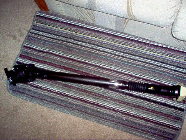

picked up the front shaft today! looks pretty sweet, test it out tomorrow. again, this is off an f-150, shortened, with a double cardan added to it. yoke to yoke its 33 1/2".

Very good, it looks just like mine, but with more fresh paint.
