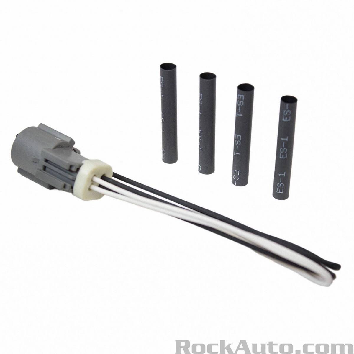

previous owner told me the transmission have been changed and since then one of the O2 sensor doesnt work, now i've found the problem, its the front O2 sensor passenger side, sensor is ok, but the plug on harness side is smashed up and need a new plug and soldering
2 questions, where can i buy that plug?
and is there a way to pull the harness out of in between firewall and transmission to do a proper soldering job?
Rockauto Has Motorcraft
http://www.rockauto.com/catalog/moreinfo.php?pk=963079&cc=1414538&jnid=595&jpid=2
ooooh!!! YOURE THE MAN!!!
