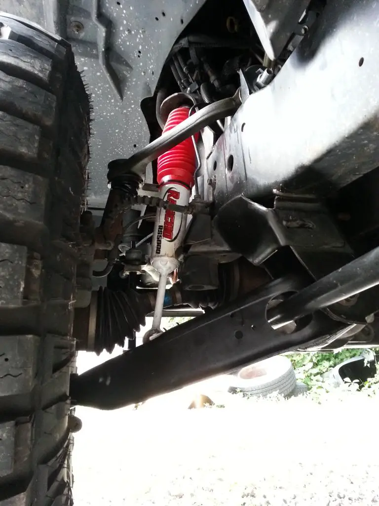

Replaced the front Rancho RS5229 shocks today with the RS5374 ones designed for torsion lifted Explorers. Sooooooooo much nicer to drive now :D
I wrote a more in depth review here: http://www.explorerforum.com/forums/showthread.php?t=388725

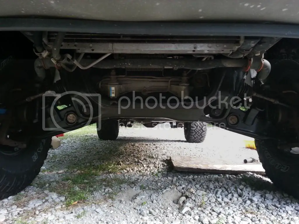

Yuck. Five and a half hours and all the suspension parts I got changed were the drivers side upper control arm and outer tie rod end. Torsion bar adjuster bolt rounded off, then the twist socket wouldn't work. The grinder got that mounting plate about halfway cut before I ran out of room. Then I tried going at it with a sawzall and that was slower than rubbing two sticks together. Tomorrow I'm gonna borrow my buddies ten inch cutting wheel and go to town. I got the passengers side lower control arm off but ran out of light to put it back together. Luckily, I have torsion bar parts spare from the other Ex.
Also got my trans flushed, coolant flushed, and fuel filter changed. Tomorrow I hope I can get everything done, then head over to get an alignment and then get to work. Should be a fun Sunday in the gravel driveway :(
Good luck and hang in there!
We've all had days like that...:D
Seth K. Pyle

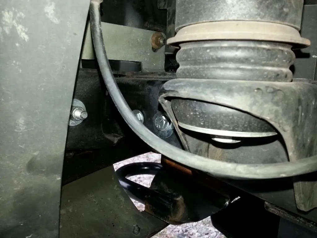

Done with everything except the brakes! :thumbsup: All four control arms, camber/caster adjusters, both outer tie rod ends. Gonna limp it to the shop tomorrow for the brakes and the alignment and grille guard brackets. I also wound up going to Advance and getting the Moog one piece control arm for the passengers side. After getting the Moog two piece one, I realized that it was just the one arm, not both. So the bushings would still be shot. I bought a bushing set from Advance yesterday, but when I tried to press them out today the press kit I rented wasn't big enough. So, I'll see if Rock Auto will let me send the two piece on back.
I also sprayed undercoating wax wherever I had stuff apart at. I haven't done the whole truck yet, but I still have time to get that done before fall.
Sixteen hours of crawling around on a gravel driveway and getting sunburnt made me say screw the brakes, someone else can do that.
I wound up getting that torsion bar out by getting a short two by four I had and putting it on my floor jack and putting tension on the torsion bar between the two control arm mounting legs. Then I carefully undid the mounting bolts and then pried the torsion bar out, then just cut and chiseled and hammered and pried the adjuster bolt and nut plate out. Seemed to be the safest way, but that stupid thing probably took about six total hours to get out. It's also a ***** to get the insulators and plate perfectly lined up to get the torsion bar installed. Quite a bit of prying and hammering and adjusting the two piece puller and adjuster bolt back and forth. I hate torsion bars. :mad:
I also think the torsion bars will need to be adjusted again. Despite measuring the bolt head to nut plate with calipers and setting them back to exactly the same distance, my front ride height seems way higher. It could just be that the suspension needs to be cycled a bit before they'll settle in.
Can't wait until I'm ready for coilovers, gonna be soooooooo much better.

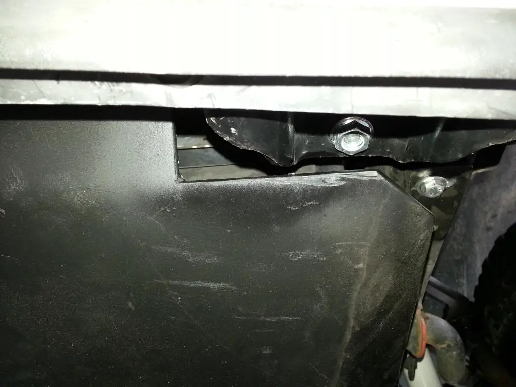

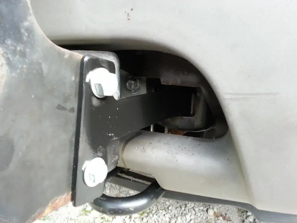

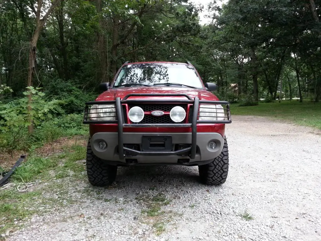

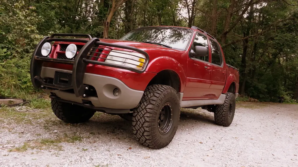

Done son! Grille guard installed, and those brackets are beefy as hell. The whole truck shakes when you give it a tug, zero slop. Great job by the bodyshop guys, way better than I could do. They did the brakes and the front pinion seal as well, I didn't want to wait until next weekend before I could tackle them myself. Also put my new Wix air filter in and new Motorcraft wiper blades, just the finishing touches on the maintenance. More driveway pictures, haha.
The skid plate had to be notched a bit to clear the tow hooks.
Also installed my Hella 500s. They're bro lights for now though. I won't have time to wire them up until the weekend, but I wanted to see how they fit on the grille guard.

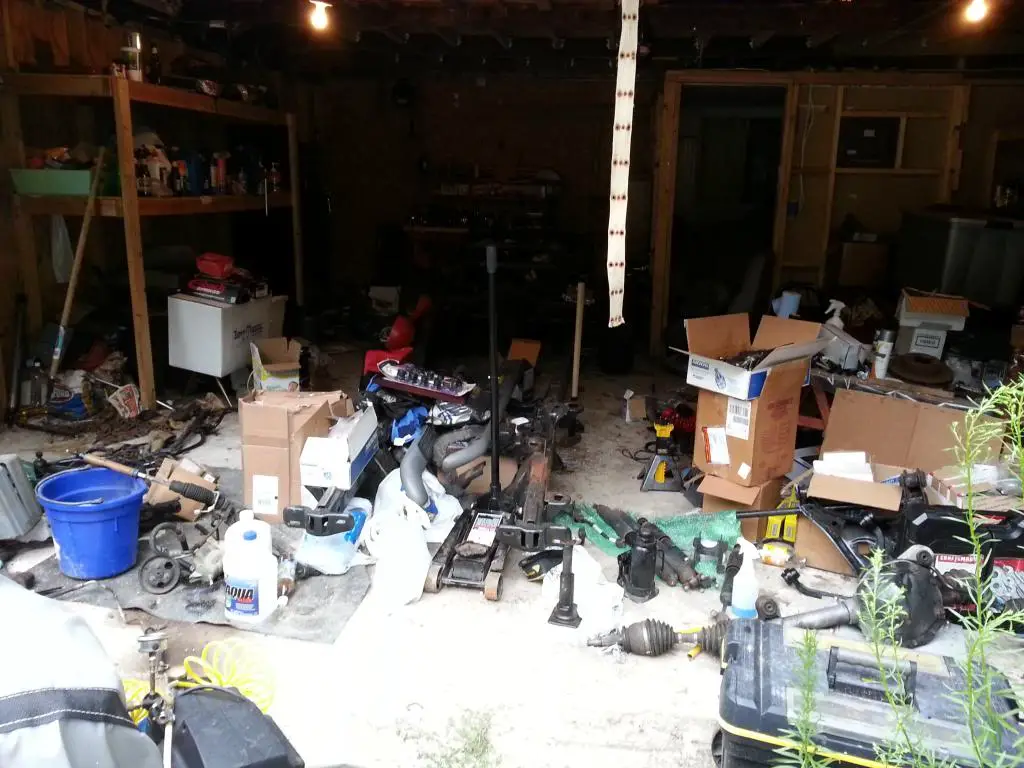

And, just for giggles, the current status of my garage, aka, why I had to bust my hump in a gravel driveway for an entire weekend: (You can just barely see my frame in there, haha)
