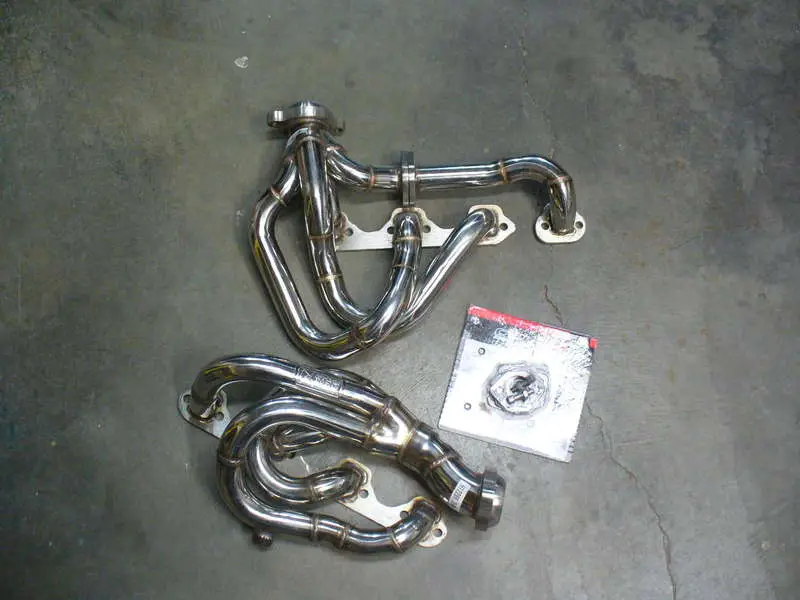

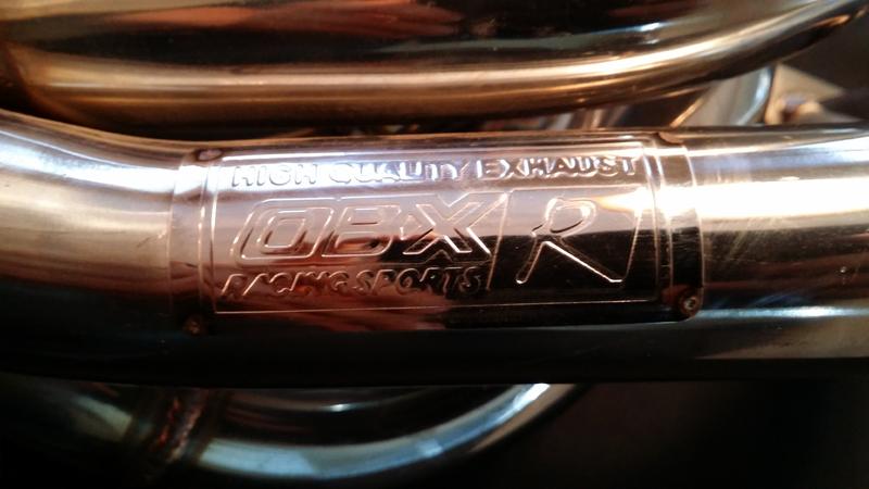

OBX Racing Headers have arrived for BIG WHITE
OBX Racing Headers have arrived!
Up until recently the only headers available for the 5.0 2nd Generation Ford Explorer were Torque Monster headers (allegedly currently made by Al's Headers in Anaheim, California). The problem with Torque Monster headers is many people have reported that Al's Headers is not responsive to any inquiries or telephone calls and will no longer make these headers for the 2nd Generation 5.0 Liter Ford Explorer. Torque Monster headers sold for $789 to $889. Torque Monster claimed that their headers "showed an increase of 20 horsepower and 35-40 ftlbs of torque" and "obtained 21.4 mpg"
I noticed several months ago via some mentions on some of the Ford Explorer forums that OBX started offering a set of headers for the 5.0 2nd Generation (1995, 1996, 1997, 1998, 1999, 2000 and 2001) Ford Explorer at only $399.00. Initially there were not many reports about the quality of the headers offered by OBX. Prior to "Black Friday" a few reports started coming in that indicated that these OBX Racing Headers might be the real deal. During "Black Friday" OBX ran a special for $100.00 their headers so I decided to go ahead and pick up a set and see what they can do.
I'm not sure if you can (or would want to) powder coat headers but I am going to do some research on that before installation. I intend on doing a before and after dyno to see what real world performance numbers can be had from the OBX Racing Sports headers. These headers are the only option currently (and fortunately) available for the 5.0 2nd Gen Ford Explorer.
More photos at the truck's Facebook page link in my sig

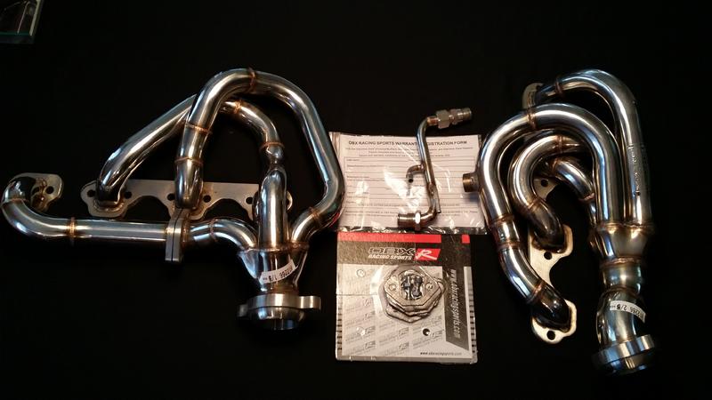

So I just got my set yesterday.
Planning on taking them to get ceramic coated.
I got a pair of OBX!!
So I got the OBX headers for my 99 mounty and they've been running fantastic!! I followed mountaineer green and another's install. They work perfectly!! Fit on like a charm. They are the same style as TorqueMonster. Ill post pics tomarrow.
Results? I can spin the tires from a start now. Instant torque gains! I had my mounty Dyno tested before the install. 177 hp and 220ftlbs *at rear wheels*
I'm going to get it Dyno tuned and tested before and after the tune to see the results of the headers.
One thing I'd have to say though is BUY A NEW SET OF GASKETS! The ones that come with it are single gasket per tube. TERRIBLE. very hard to work with.
Also, it took me like 3 freaking days to instal these damn things... I'm so happy with them though!
ANY questions about the headers and I'll try to ask them.
PICS SOON!
PICS SOON!
