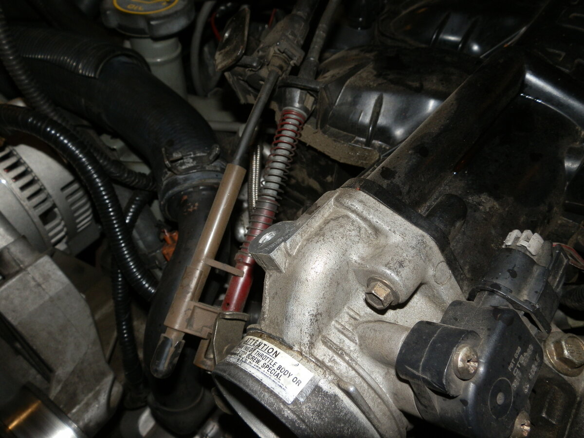

Since the Cruise Control was working before, check the free-play on the CC Cable that goes to the throttle body.
There is a clip that allows you to adjust out the free play as the cable stretches.
Over 16 years I had to do this two or three times when my CC wasn't smoothly & seamlessly engaging.
As years go by, if the cable is left unadjusted, eventually so much cable stretch will develop that the arc of the
CC Motor (by the passenger firewall) can't take up all the slack, and you will "lose" your cruise control.

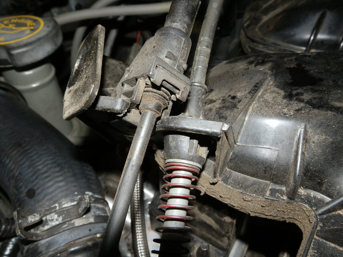

Look at the cable on top that has the clip on it - note the number of "steps" on the plastic adjustment point.
Those adjustment points take up the slack that develops in the cable over 20 + years.
BEFORE ADJUSTING, if memory serves me correctly, you should be able to pull on the "protective but movable BROWN PLASTIC sheath"
(2nd Picture) on the CC Cable to see how much free play has developed before the arm on the throttle body engages.
Hope I'm making myself clear - you've been here long enough (2007) to stand back and take a look at the
whole CC Cable arrangement and figure out what I am saying ;)
Hope that help brother and report back :)
