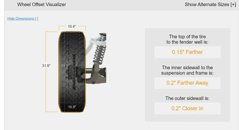

Do you think 18" rims 35 off set with 265/65 tires would work? I want to go up a tire size and get a bit of the off road look.
Yes that should work. Below is the comparison from my setup to what you are suggesting. You will have more clearance in all directions
Tiresize.com has a many calculator tools that you may find useful

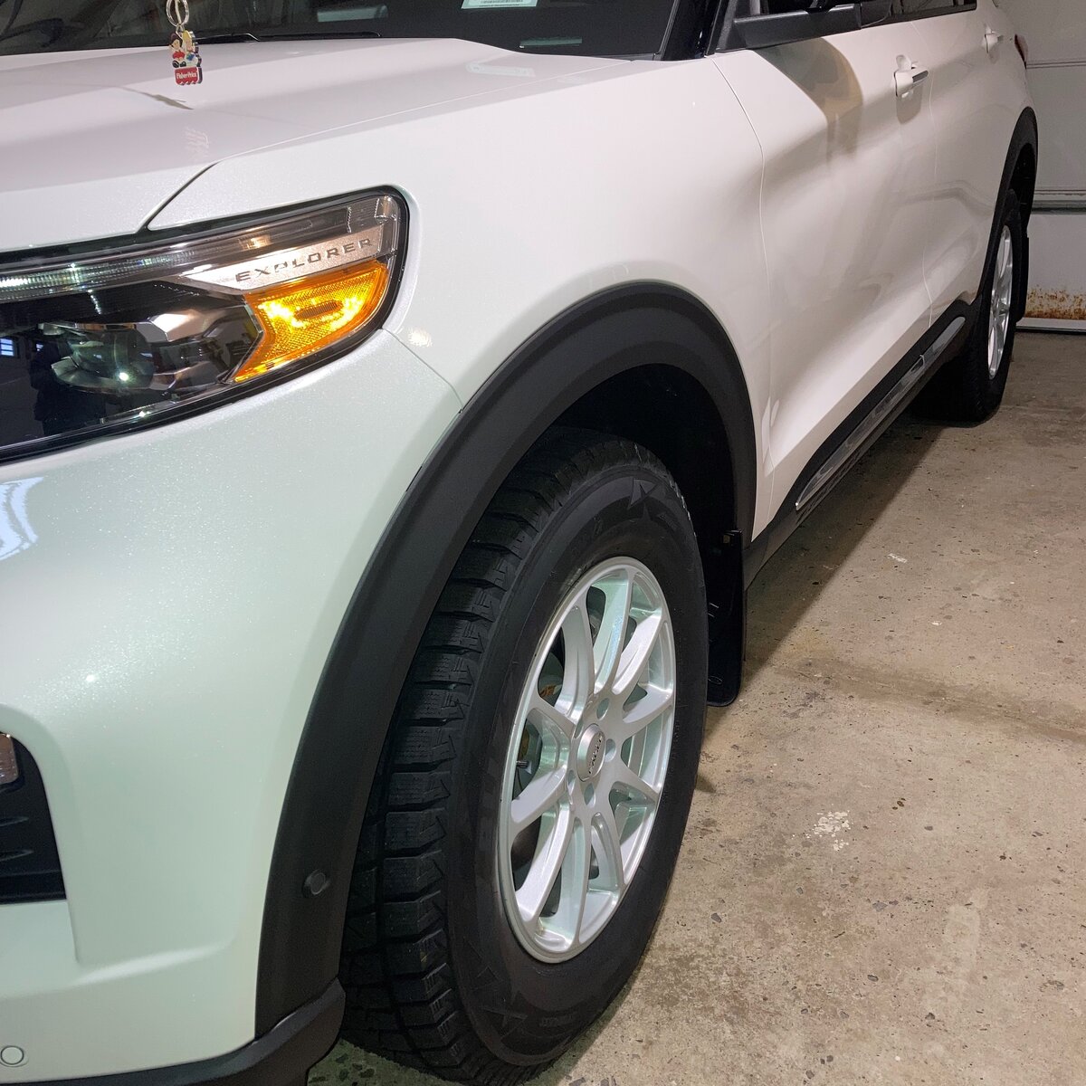

That's the exact size aftermarket rims and Blizzak tires I recently put on my 2021 Platinum. Purchased from Tirerack and the wheels come in black also.

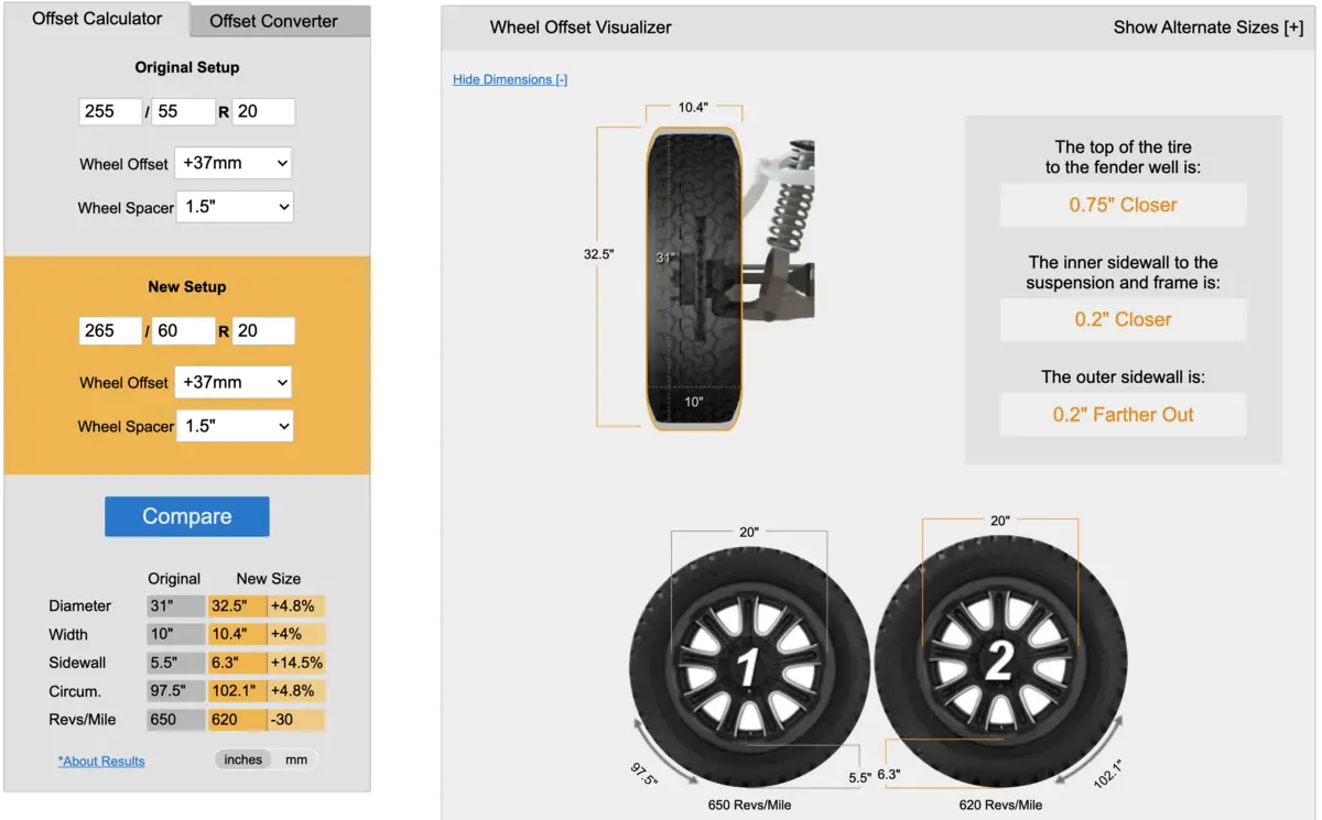

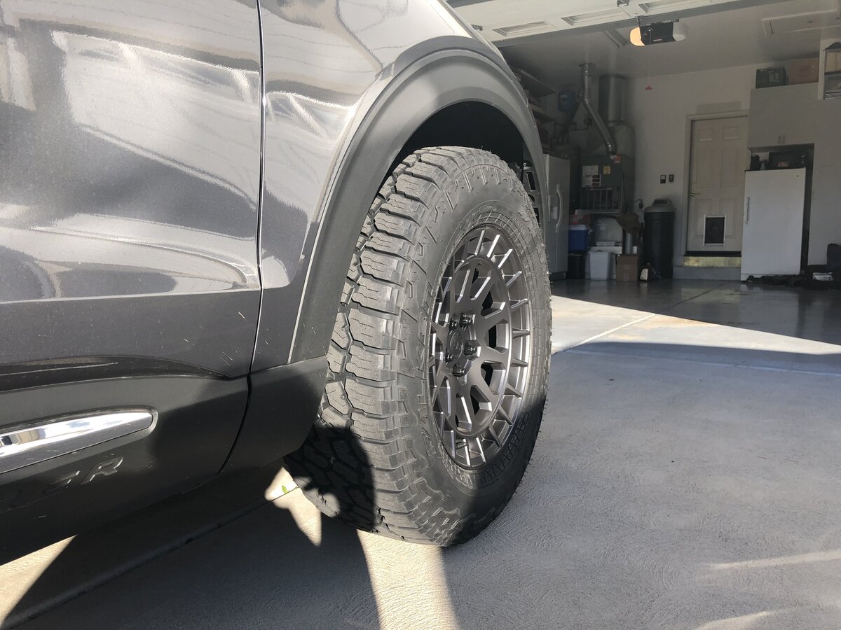

On my '21 Limited, I'm going with the 1.5 Traxda lift and 265 60/R20 Falken Wildpeak AT3W which is a 32.5 inch tire, 1.5 inches taller than stock. I also am using 1.5 inch adapters which will make the new tires have just a smidge of poke. Right now, the stock Michelins with the adapters sit flush with the fender and look great. I have test fit coming up in a week or so (need to install the lift first) to make sure everything fits with no rubbing.
I'll also recalibrate wheel size using Forscan to account for the larger tire diameter size.
With 3% being the generally accepted nominal maximum difference in diameter, you are quite a bit over. Even modifying the size with FORScan, won't reduce the extra weight on the suspension or brake system. It may help features like ABS and Traction Control.

Yup. Understood. Adding about 20 pounds per wheel/tire but I'm willing to take the "risk". ;)

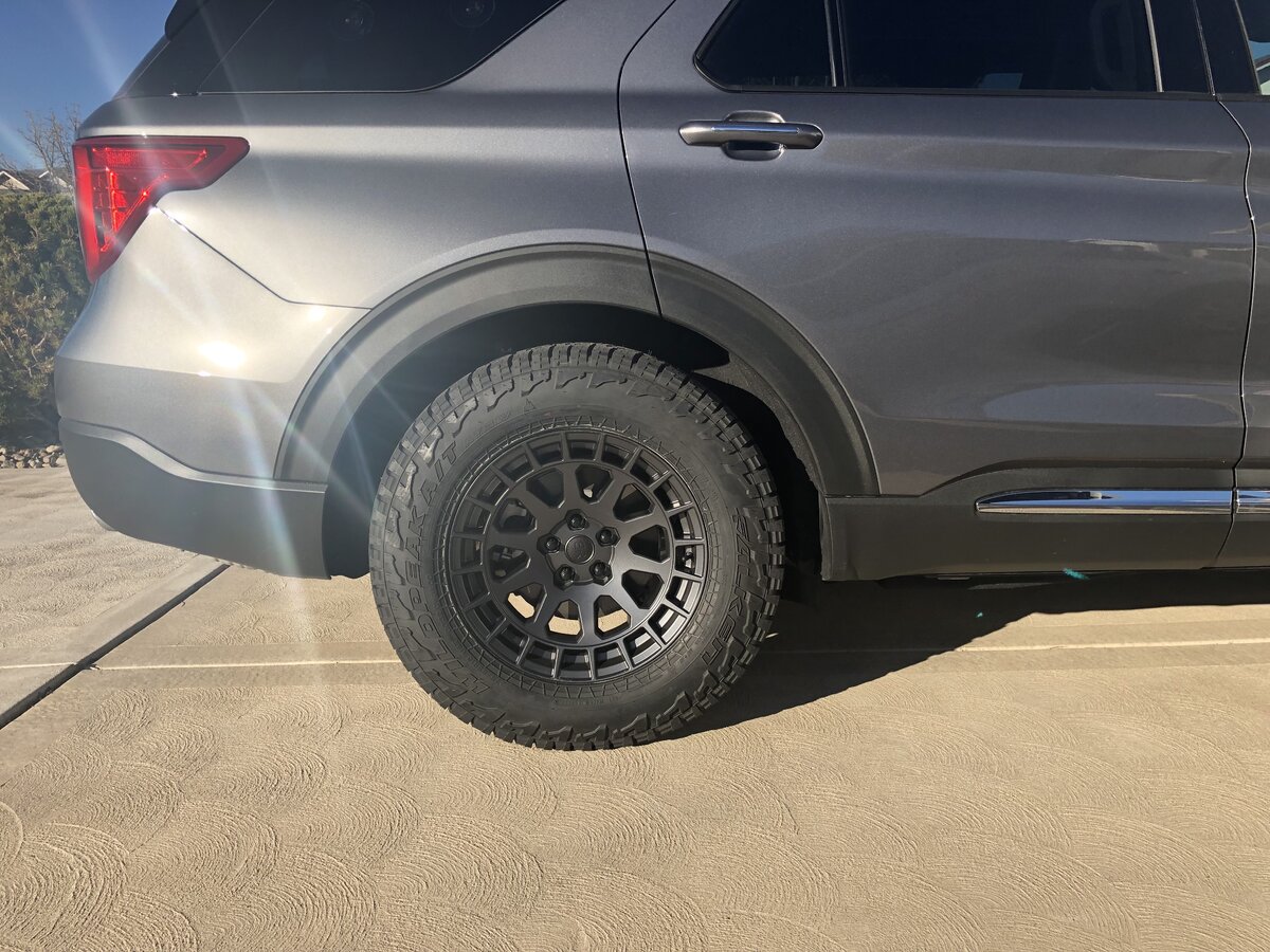

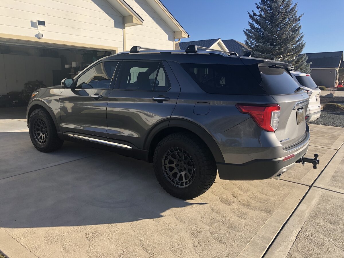

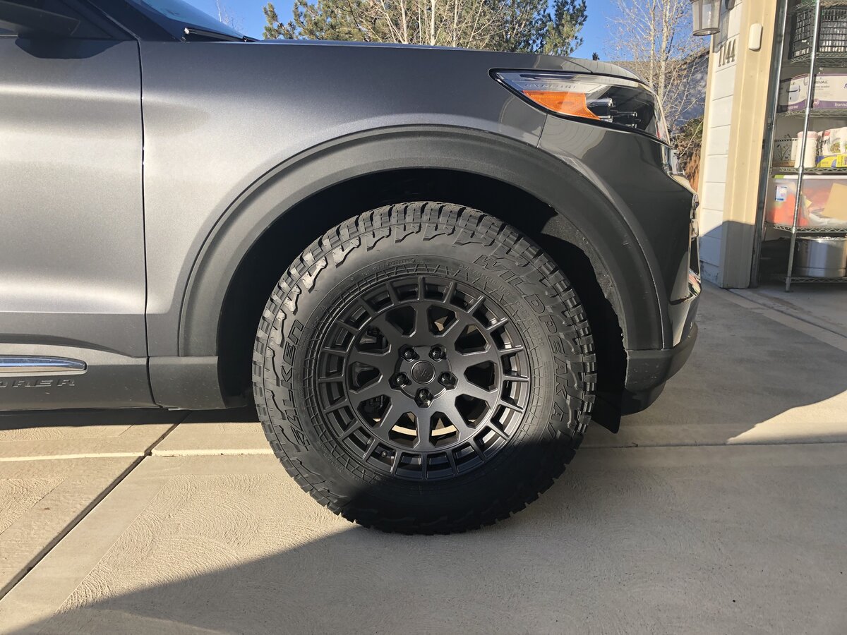

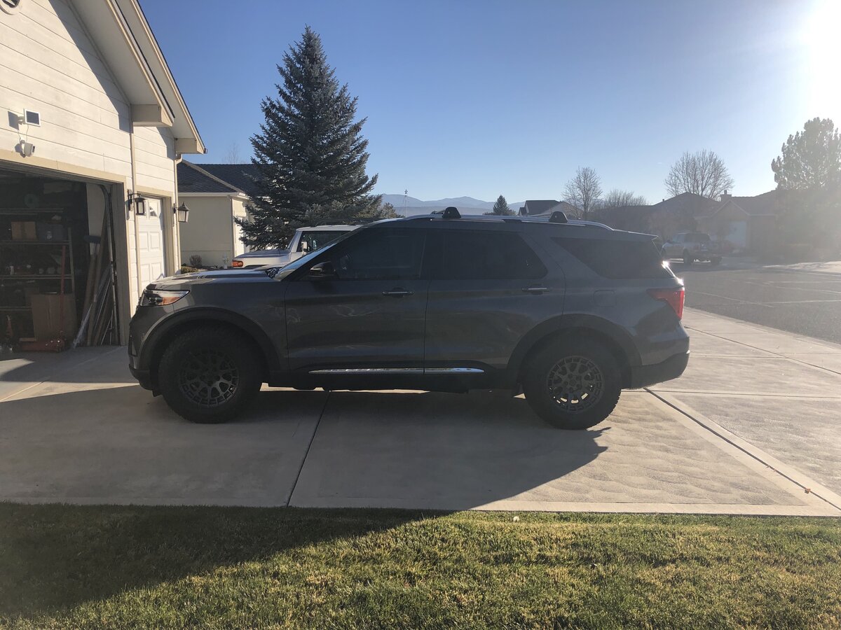

Just a quick update. I ended up going with an 18x8.5 +12mm offset wheel and 275 65/R18 which is a 32" tire rather than the 265 60/R20 which is 32.5". Waiting on the wheels/tires to be shipped to me. When I get them, I will install the lift and post pics.

Speedometer info/comparison to WAZE navigation.
I have P265/65 R18 Blizzaks on in place of the 275/45 R21 oem wheels/tires. Even though the Blizzak is a larger tire from a circumference perspective, about 2.5% using tire specs from the manufacturers, the speedometer is very close.
When using WAZE navigation on a connected iPhone/Apple CarPlay it reports the same speed as the vehicle speedometer. That's at 45 mph. Perhaps WAZE has a tolerance so results may not match as close as I'm seeing.

With those tires, you'd be going 61.6 mph when the speedo reads 60.
