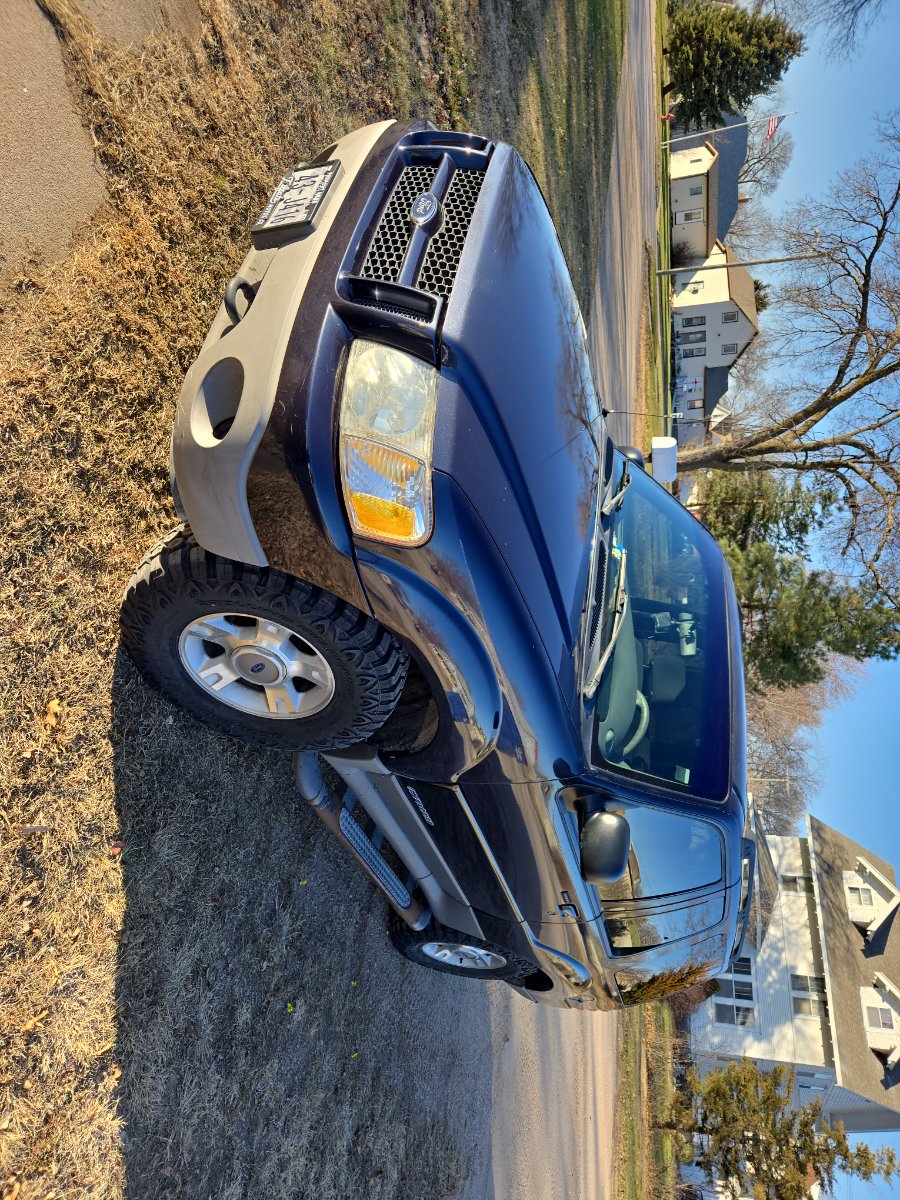

Hey all, I currently run an 01 Explorer Sport and I am looking for an offroad bumper I figured I'd post here as the Sport and Sport trac share the same front clip. I'm not sure if one from a Ranger or standard 4door Explorer would work the same with the obvious trimming to the bumper cover of course. Any help or direction would be appreciated.

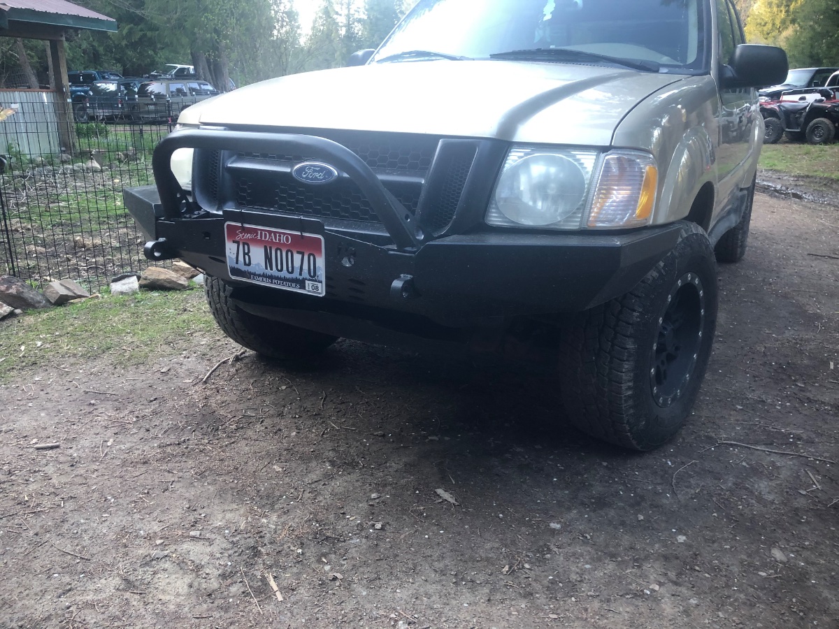

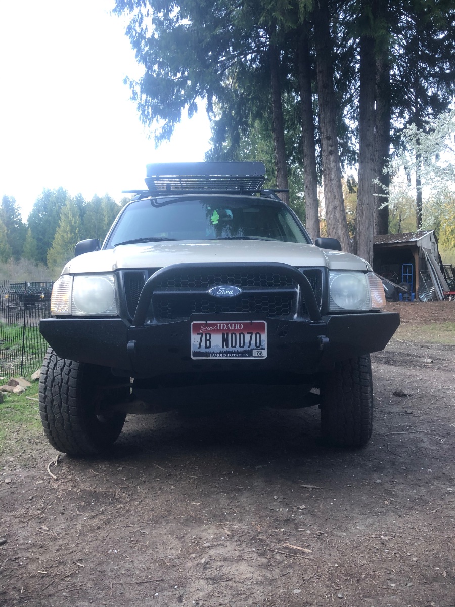

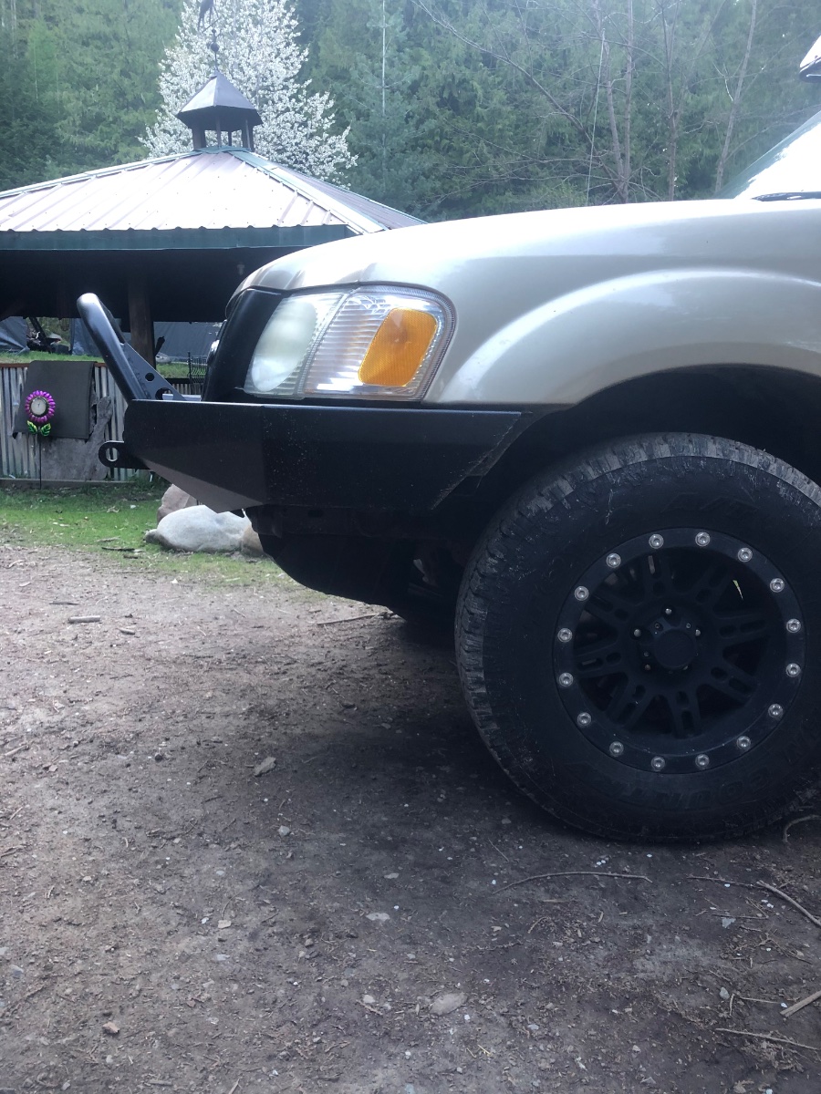

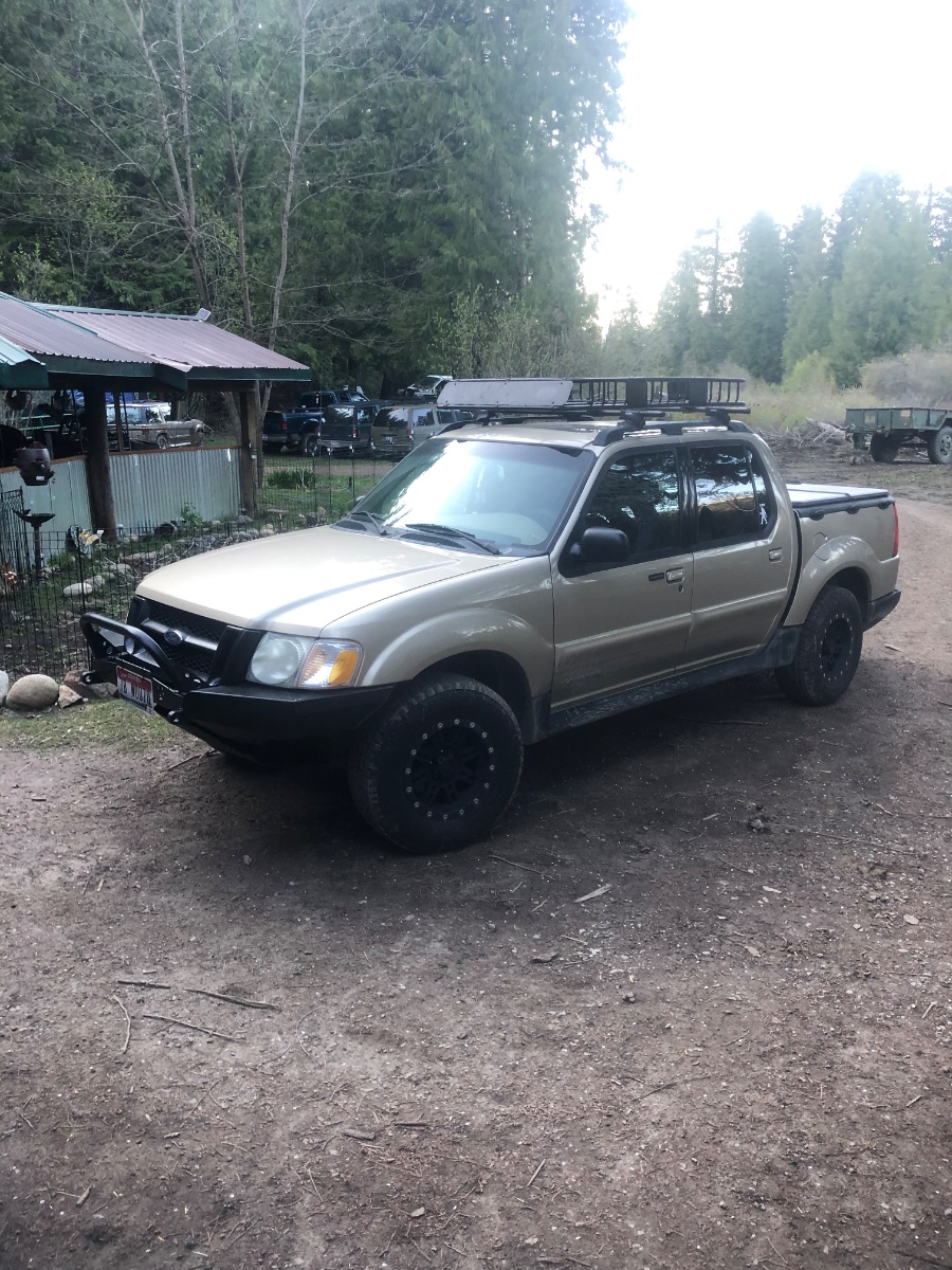

I have installed a rock ranger style bumper on a sport trac
I had to modify the brackets
A ranger bumper when installed on a sport trac requires the mounting holes on the truck side to move up exactly 2”
You can drill the lower hole but the upper
Hole must be added. I simply welded a piece of angle iron on top of the frame horns and drilled the holes into that
The plastic nose / bumper of the 01-05 sport trac and sport will have to be trimmed for the new metal bits
Basically you keep the grill all else
Goes bye bye
A multi tool makes short work of slicing through plastics
Worked out awesome
