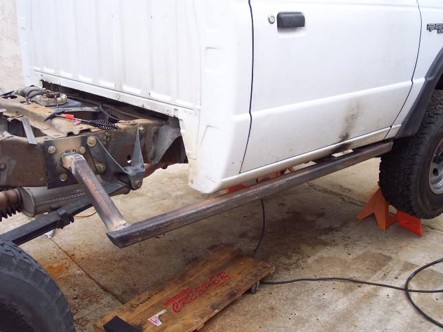

Here are a couple of pix of the sliders I'm building for Ben (Blee1099). This morning I welded the endcaps in place and ground 'em down smooth. The sliders are 2 x 3 x 1/4" wall, the supports are 2x2x 1/4" wall, and the mounting plates are 1/4" plate material. More pix will follow next weekend when we do the install.
BTW, material costs are right around $100, at least from the Amish shop I deal with.
