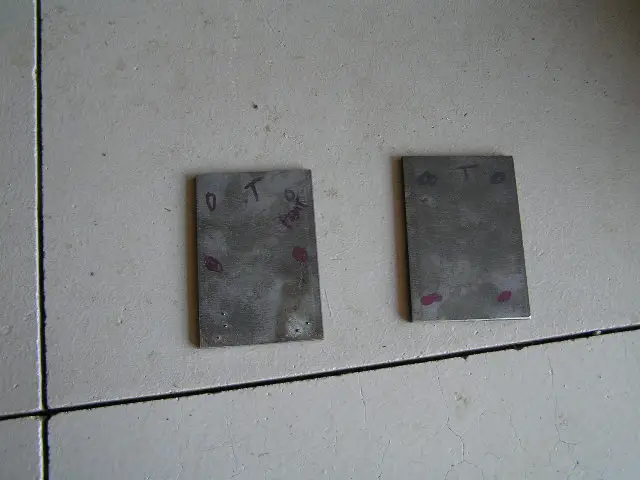

The mounts we made for the frame:

After doing 3 sets of these, IMHO, the easiest way to build them is to first get the frame mounts in place (just a piece of 1/4" x 4" wide flat stock) and temporarily bolted down, then bring the slider into the location you want it, measure the distance from the frame mounts to the slider and cut your outriggers to that length. While the slider is sitting in the position you want, mark it as to where the outriggers are to go. Take everything out and weld the outriggers to the sliders. Then, reposition the sliders and tack weld the outriggers to the frame mounts. After that is done, remove the frame mounts and finish the welds.
I also recommend using a stiffener between the top of the frame mount and the outriggers. It made a big difference on Ben's sliders as far as vertical stiffness. Check out http://www.explorerforum.com/forums/showthread.php?t=133670 for more pictures. Scroll down to the bottom for close up of the frame mounts and the stiffeners.
