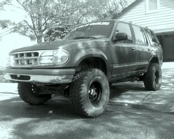

Here is my XLT With the basic torsion twist, shackles and body lift

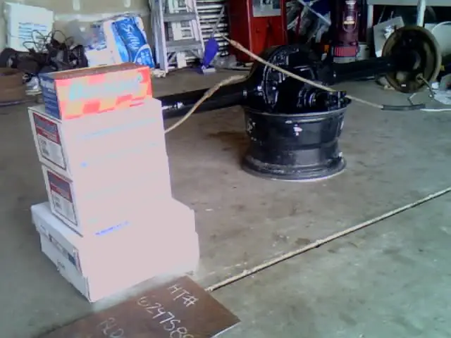

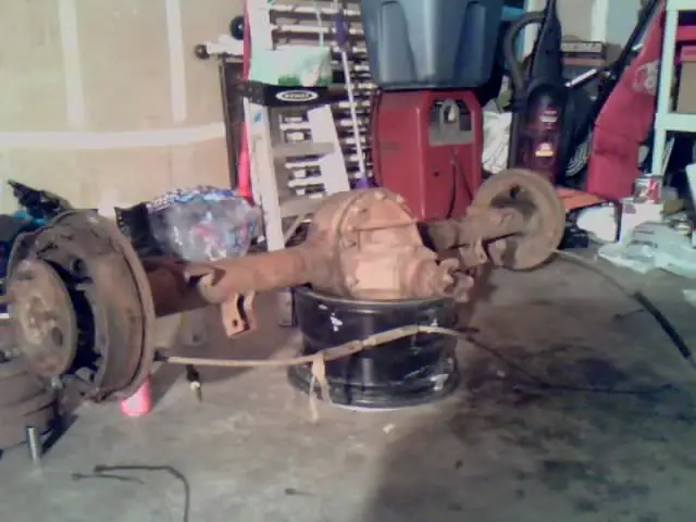

Here is the 9" that i will be running (been sitting outside)
ahh much better :)

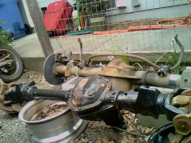

HP 44

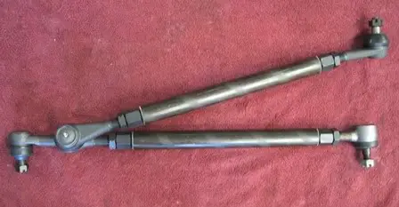

My steering witch i will be running with a first gen box..i also have a James Duff drop pitman arm for a first gen made for a 5.5" lift

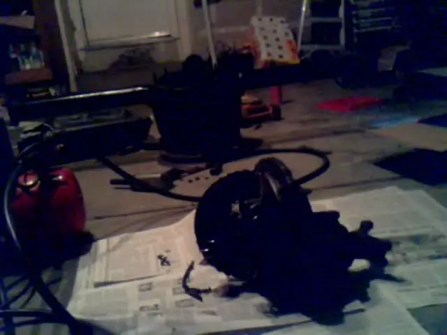

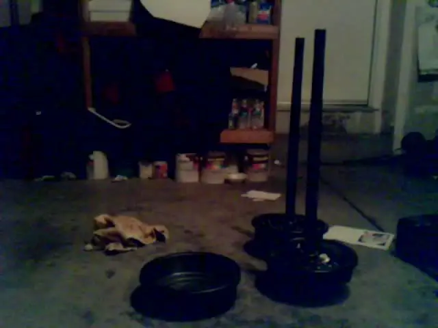

sorry for beaing so dark but this is pulling the 9" apart
new gears :)
i do not own a vice so this is where my redneck engineering comes into play with torqing the ring gear to the spool

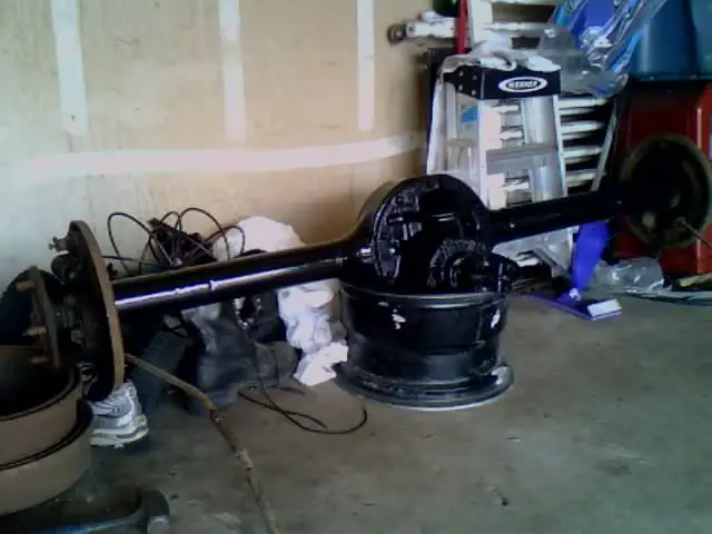

progress..
got the backlash and pinion depth perfect now on to the next axle..the next pic really doesnt have anything to do with this build but this is what happened to my jeep last weekend..yes pinion gear sheared clean off of a dana 35..this truck is my girlfriends baby and her daily driver and yes she was driving and yes she loves the skinny pedal :)
