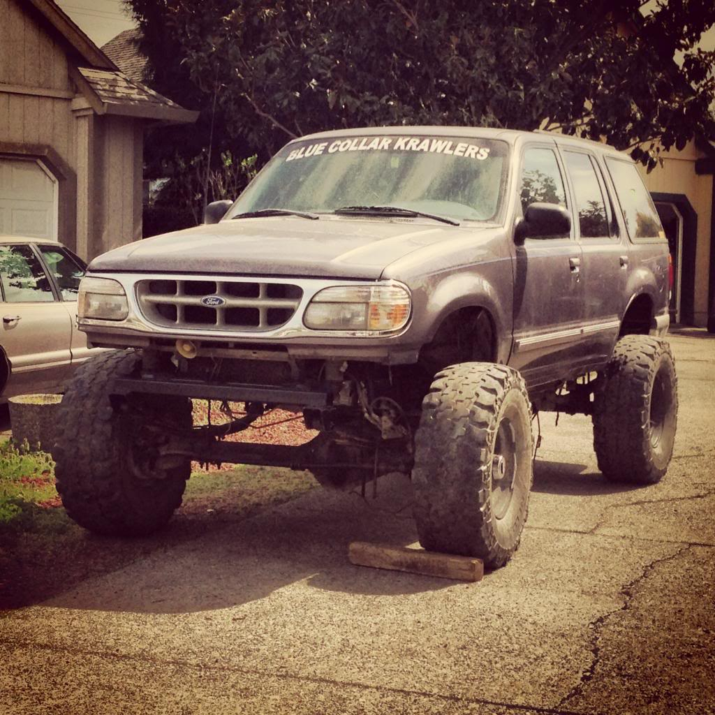

haha ya! it is comming together! the tires on there now are 36x14.5..kinda thinking about leaving the body lift on..what do u guys think?

You have a pic with the 36s? I wouldn't take out the BL but that's just me and I don't know how it sits right now. Only thing is if you make bumpers and sliders you'd have to modify them if you changed your mind at all

those are 36's in the pic..im thinking about taking the BL off..the only reason its on there is so i could clear 33's when it was IFS

Would that affect how much you can flex at all? I looks like the tires might hit the fenders if it was lower. If its good ditching the BL will lower you COG a little at least. I like the look of it as is but that's jmo

oh my god get rid of the body lift! they only give you problems.
if the tires dont fit get smaller ones or bust out the saws-all. as for sliders, to get more gound clearance just cut the rockers. thats what i did on my first go round and it not only looked better but worked better too.
Do you plan on driving this on the street? if so what tire and size were you thinking about using?

Problems? So many people run them here without issue. Plus they make it easier to work underneath. Besides who wants to run smaller tires? Lol

im sure you will be fine for light wheeling. but i saying if you roll it or flop it on its side that extra BL will fold.
not to mention it makes your center of gravity higher.
but do you thing its your rig. nice build!

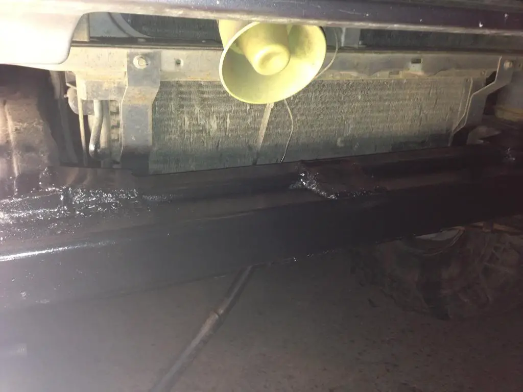

alright folks i have been busy..but here it is

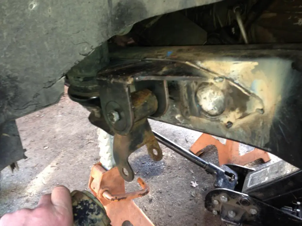

here is how i did my front shackles
Front Hanger

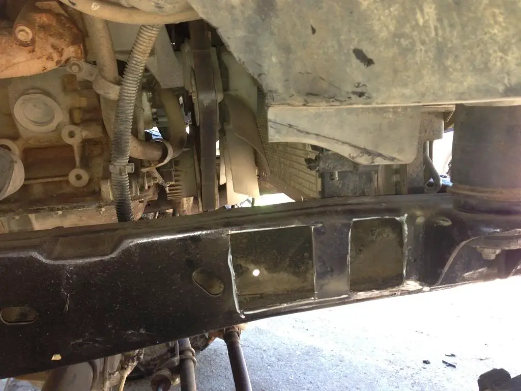

Bye bye crunple zones :thumbsup:
New plates welded in place
Muuuch better! :D

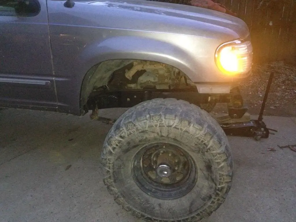

Stretched the front end..just gotta trim a bit 121.5 wheel base
this was taken before the stretch..but this is gunna be the ride height

Thank you! The tires are gunna be 37x12.50R17
