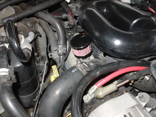

hey guys, 93 xlt, 70mm maf, borla muff, bbk throttle,kn filter,new tranny,
i decided 2 weeks ago to install a oil breather mod and cap off the intake tube, as seen on threads here using the search function....i did not know why the factory had the stock setup because you would think the intake is sucking hot oil gases back into your cold air mixture ....this is not my engine but the setup was the same oil breather but i didnt use pvc intake i use stock plastic hose with bigger throttle and bigger maf
now this is the problem i had a week after
http://www.explorerforum.com/forums/showthread.php?t=246461
experiencing what i thought was a surge in power turned out to be a increasingly worse day by day problem of it suddenly increasing rpm and power without pushing the throttle more
and then it goes back to steady...many here recommended to change my tranny, but its newly rebuilt 2 years ago and there hasnt been 1 slip yet and not a single power problem on freeway
the moment i took back off the oil breather and reinstalled my stock oil hose intake, the problem goes away, and i noticed a increase in torque (seems to have more pep from 0mph-50mph)
If i had a overdrive or gear problem wouldnt this problem be present now after i went back to stock intake system?
why only with the oil breather does this problem exists?
i read in a thread using search that the pcv valve will recirculate gases back into intake,so basically using the oil breather was causing a increase in built up gases in the crankcase thus slowing down performance
another guy tried this on that thread here and when he went back to stock oil hose he also noticed it was faster and idle was smoother
when i was using the oil breather my idle was HORRIBLE. i was about to change my sparkplugs because the steering wheel would vibrate so bad in idle...when i releaved the pressure in the crankcase by going back to the origiinal oil hose to intake setup, the vibration was gone
im going to stick with my mods but not use the oil breather...
so far the only positive ive read about this is that it keeps your throttle cleaner but thats not what ive been reading either, the pcv will release gases back into your manifold throttle thus making it dirty over time
something about smog emissions is also mentioned but it was vague...i cant tell if he was saying the oil breather increases smog during a dyno or decreases emissions during dyno
i always have to get that done during inspection here in texas
if you want a more detailed explanation, the first few days i used the breather i did notice a power increase , i loved it, but then i started noticing more and more vibration idle, and more and more upshifting downshifting at high speeds
i will say that gas milage seemed better using the breather, but right now without it i have more power and id rather have more power and pay for more gas
