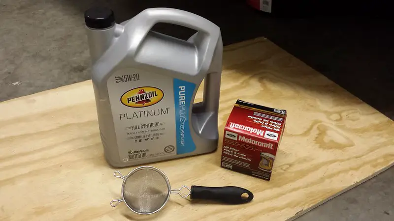

Found a deal, 5w20 Penzoil full synthetic for $22,
With the possibility of two rebates. It has a $10 mail in rebate, Making it $12!
My friend said they are still honoring an expired $1 off per gallon of shell gas so if that's true, it makes it $2 for the oil! I'll try that first, if not then I'll do the $10 rebate.
So, I got the oil, a filter and a strainer (First oil change since owning it)
the strainer is just to look for sludge and debri as it drains out the pan.
If this $10 rebate is my only option, then its still great for the oil at $12!
But hopefully this works, at 20 gallons it'll make the oil $2!!
So I change the oil and everything is fine, Since it has larger wheels on it I don't have to jack or raise the explorer. Awesome! Level ground and now raising it. Easy!
