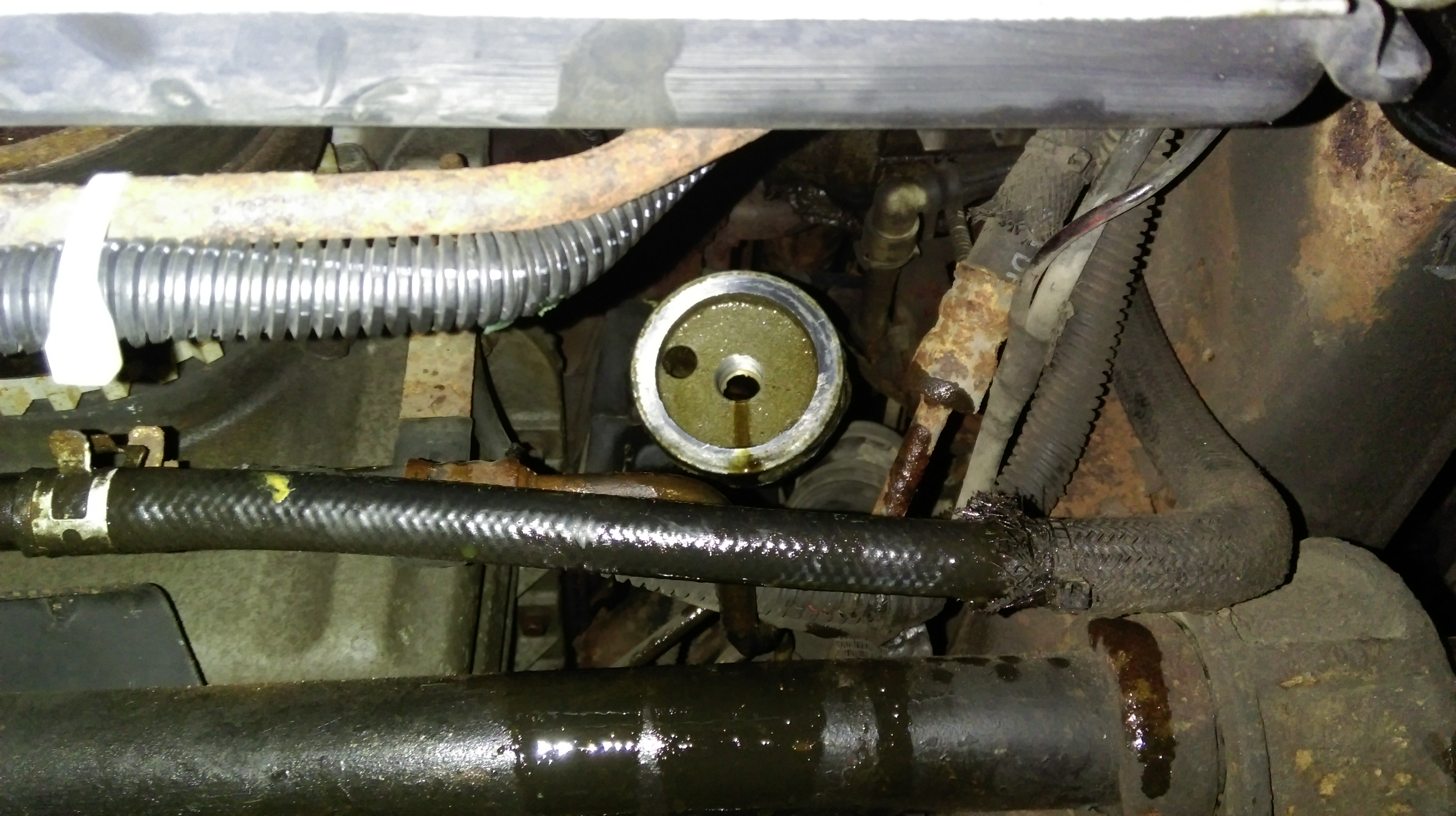

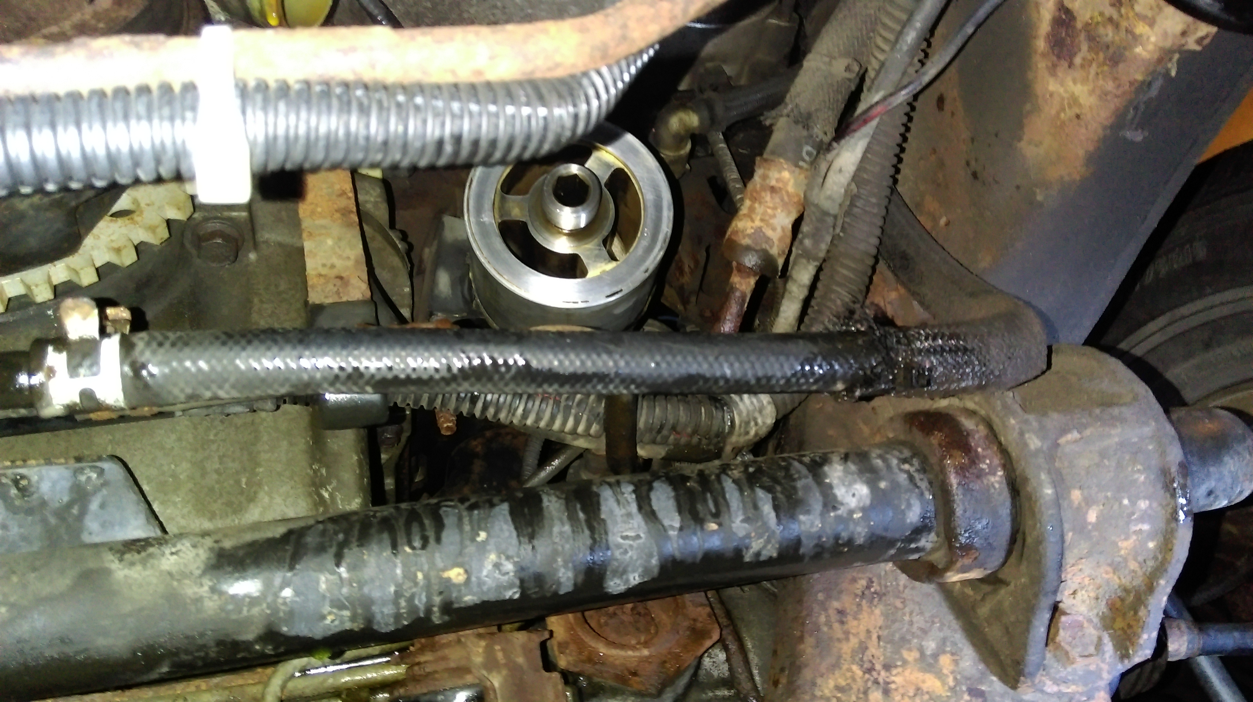

i saw on this thread from awhile back that you posted a photo but its no longer there. 5.0L Oil cooler delete, how is it done?
wondering if you still had a photo showing exactly what it looks like.
thanks.
The picture should show now. Let me know if it shows in that thread please, and, for now I will also post it here.

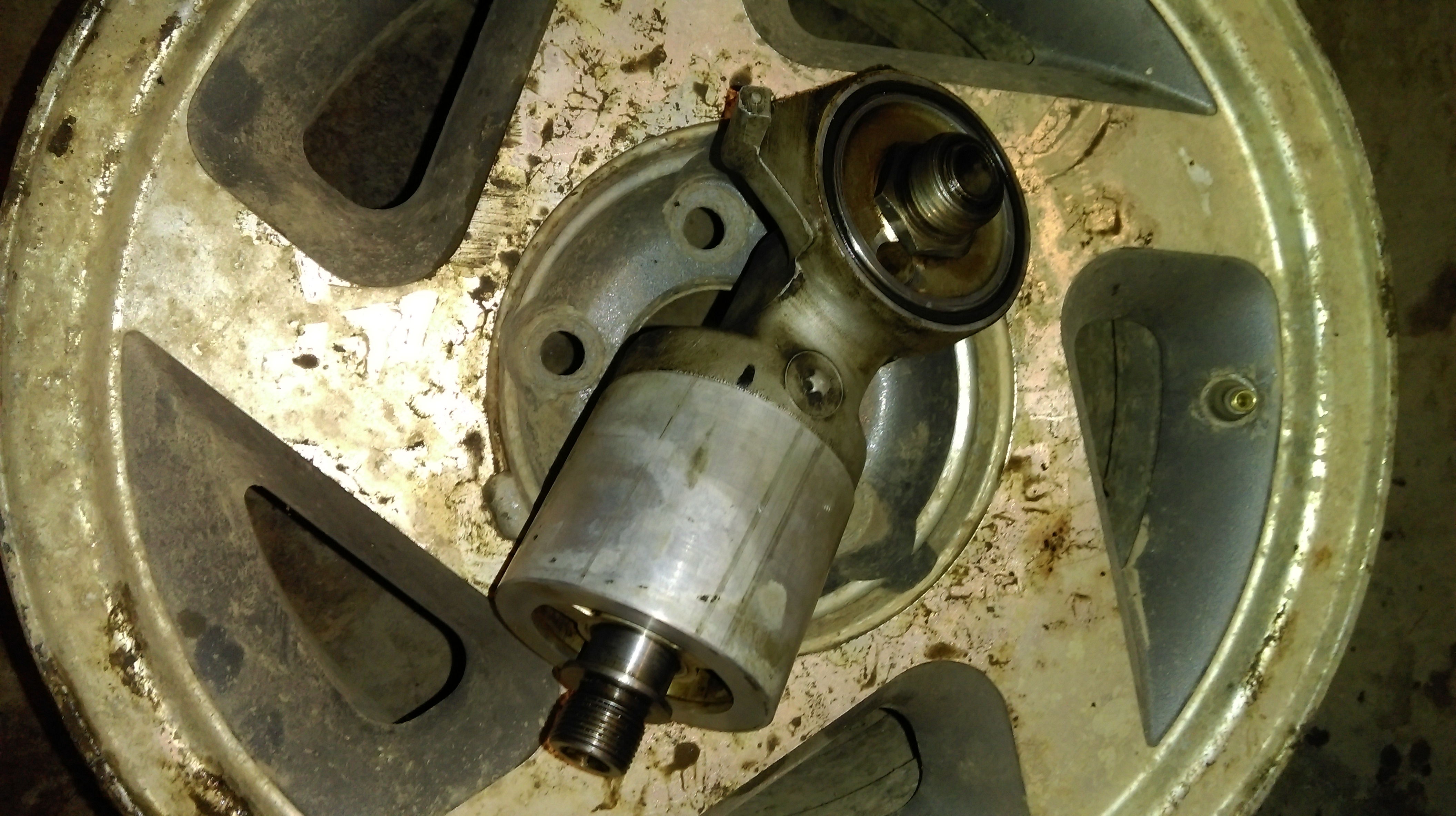

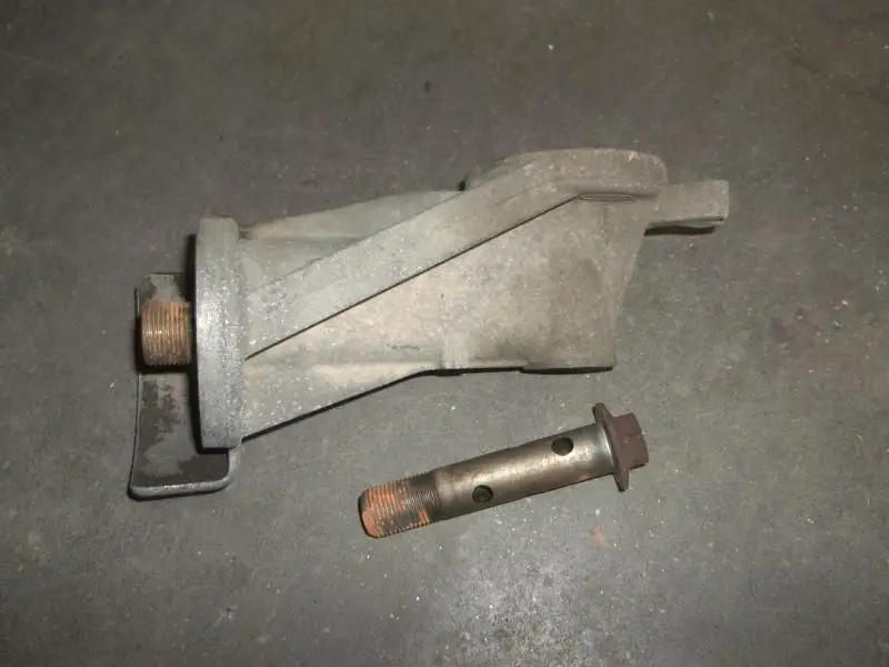

i was able to find a good used adapter without the cooler, it doesn't look at all like the one piece adapter like the posted off a later model like a 99 and up
this one is a 2 piece design and i lucked out and was able to just remove the stud and remove the cooler and leave the angled piece on the block and just install the aluminum piece off the one i bought so i didn't have to monkey around trying to get in there to get the whole thing off and i just installed a radiator hose from a 2000 model.
so if anyone can get a hold of an adapter like mine or at least just the aluminum round piece you have a little less work to do.
Great work, and I know how tight it is in there to remove that block bolt.
Wow, nice find! I wish I had know about this when I swapped out my oil cooler - looks a lot easier.

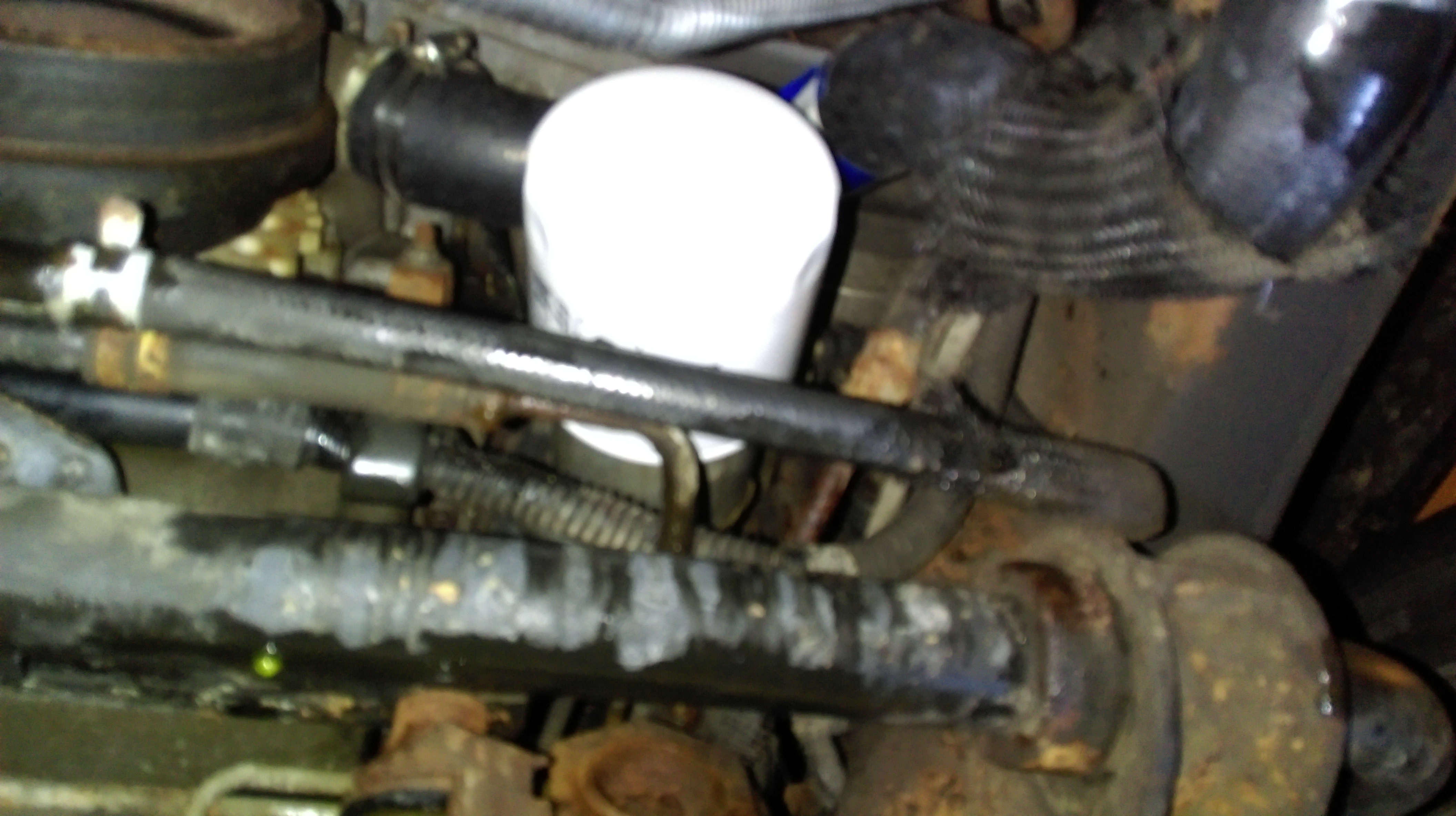

I replaced mine with Ford Performance Parts Oil Filter Adapter M-6880-A50 and male-to-male thread screw in adapter at the block, like PN ALL92003 (I got mine at the dealership and don't know the part number).
In case others find this in the future, and are not able to find the same adapter as Ford_Racing_Guy, the Ford Performance Parts 90-deg filter adapter works fine. It is much shorter than the mid-98 to 2001 filter adapter, but it takes FL1A oil filters which are much longer, so it evens out. It is a little harder to get the filter lined up when changing the oil, but it is worth the extra filter capacity. Be sure to have a filter installed when you are lining the adapter up before tightening the bolt at the block - there's not much room for lining it up wrong.
