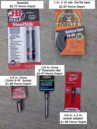

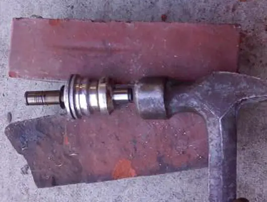

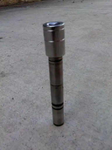

I made a cheap oil pump priming tool that worked great.
It won’t last forever but it served my one time use.
Here’s how:

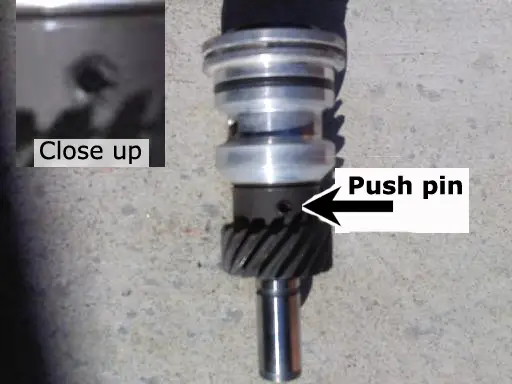

#1) Get another Oil Pump Drive Gear from the local junkyard.

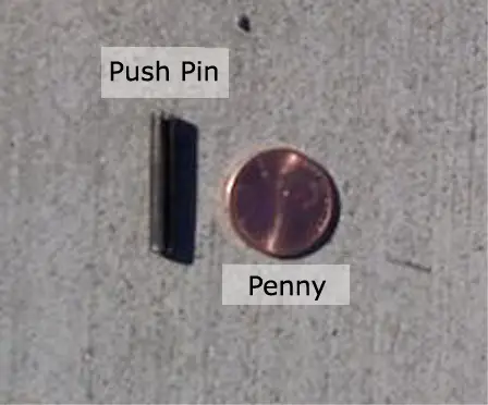

#2) Slide the push pin out of the main shaft with a punch & hammer. (I used a nail)
#3) Slide the gear & washers off the drive shaft.

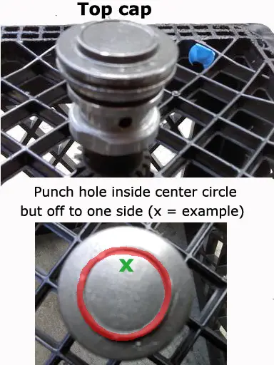

#4) Punch a hole in the top cap with a nail, screw or drill.

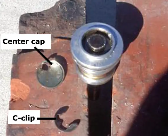

#5) Stick a screw driver in the hole you made and pop out the center cap.
Inside, you will see a C-clip.
#6) Remove C-clip with a screw driver.

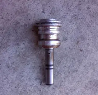

#7) Lightly tap the gear end of shaft out. (sliding shaft out the top)
Use a hammer or tap it on the ground.

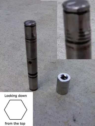

#8) Using a grinder, lightly grind the top, outside edge of the shaft to accept a 12mm, 6 point socket. (Basically, making 6 flat edges)
(I used a ¼ in. drive socket)
#9) Place the socket onto the shaft.
If you don’t have access to a grinder, use a ½ in socket. Fill the socket with SteelStik putty
(not allowing putty to go into drive part of socket)
and place shaft all the way into the socket & putty and let dry.
(This will make your socket unusable)
#10) I then wrapped the socket and shaft with Gorilla tape.
(It's the strongest tape I know of)
#11) Connect any length extension and/or universal-socket-joint that you need to the socket.

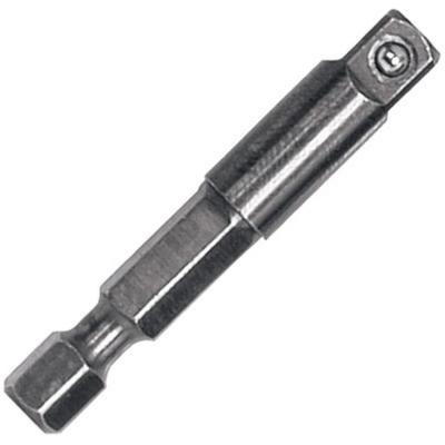

#12) Connect 1/4 "in dr. x 2 in. socket adapter" to your 1/4" socket extension to accommodate drill chuck.
#13) Spin oil pump with drill (reverse drill rotation)
I hope this helped someone.
