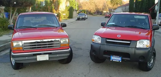

Hope I posted this in the right place.. anyways, a little history on this explorer. My mom bought it in 2000, my sister got it in '03 when my mom got a Frontier, and my sister seemed to have bad luck with it. 3 or 4 accidents.. made a left while a Toyota Sierra made a right, their fenders met, Explorer had a dent, bumper got a little messed up, and the fender was pushed toward the hood, while the Sierra had 4K in damage. My sis was in a parking lot waiting to park in a spot when someone mixed up the brake and gas smashing into her, they then ran. The lastest one, Explorer was parked, at 2 am some drunk girl can't go straight and smashes into the left rear, this bent the leaf, axle, put a few scrapes on the body, and destroyed one of the wheels. Thus far the explorer had been fixed after each accident, usually insurance paid for it, that one hit and run was out of pocket. The drunk girls insurance totalled the explorer this time, we bought it back and swapped out the rear axle, and picked up a set of Bronco II wheels for it.
Here's the Explorer along side the Frontier in '03
