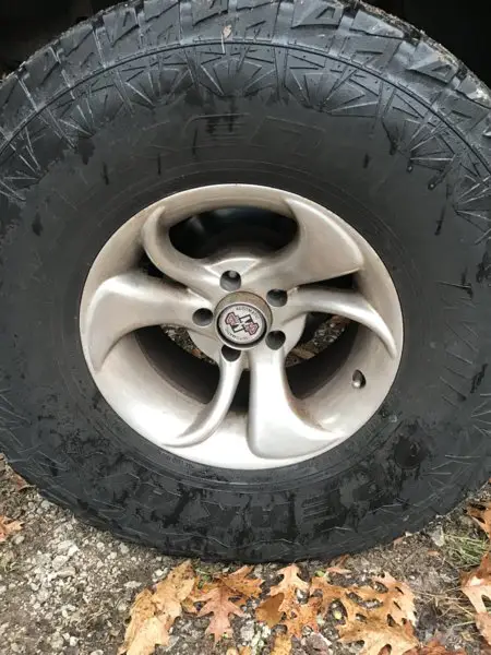

i will as soon as i find my camera. thanks the rear coils do look newer than the other stuff under there, as well as some shock like units under the front. I took off a front wheel and was amazed at how little effort it took to remove all the lig nuts. What is the correct torque? and the front auto hub just came off with the tire and wheel! isn't there something else supposed to be securing it? there also is a thin metal open ended cylinder with a backing plate also sticking out of the wheel hub hole surronding the hub? it is to lose and thin to be there for support. so it seems the wheel is LUG centered and supported? is this right? i'll post some pics ASAP. thanks, jmczzz

thanks but i think they are to take up space in the center wheel hole and the trucks auto hub. the wheels measure from the outside almost 10 inches wide and the center hole is approx 3.5 diameter. the lugs take all the weight and centering effort. jmczzz

1st gen stock wheels are Lug centric.
Most aftermarket wheels are not hub centric, and rely on centering with acorn lugs, and some use thick washers on deep lug bodies, such as old school Mag Crager wheels, to center them.
Yours are aftermarket wheels, and you have 3.5" opening, so they are 1/2"-20 Lug centric.

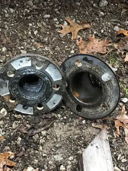

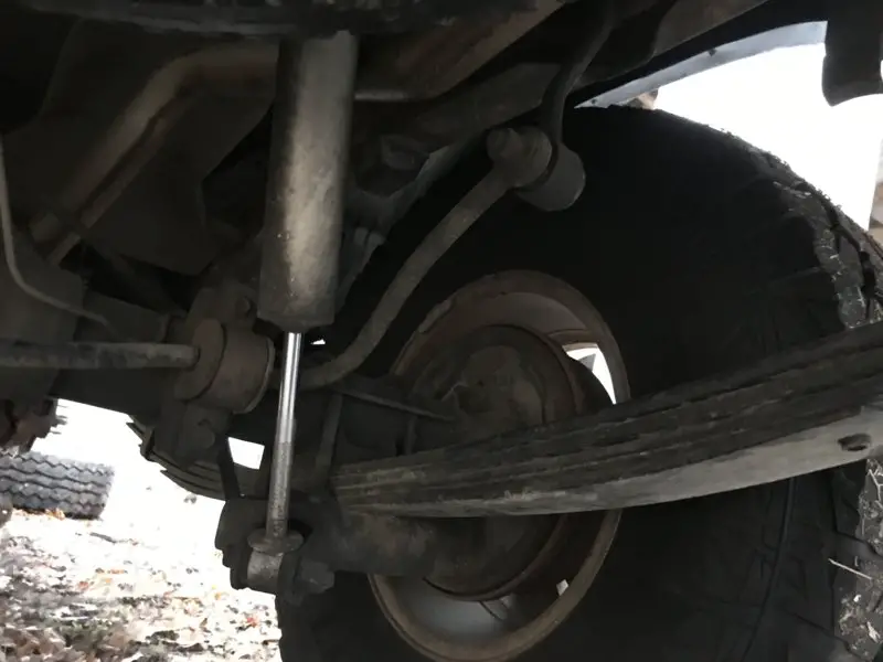

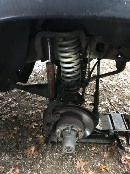

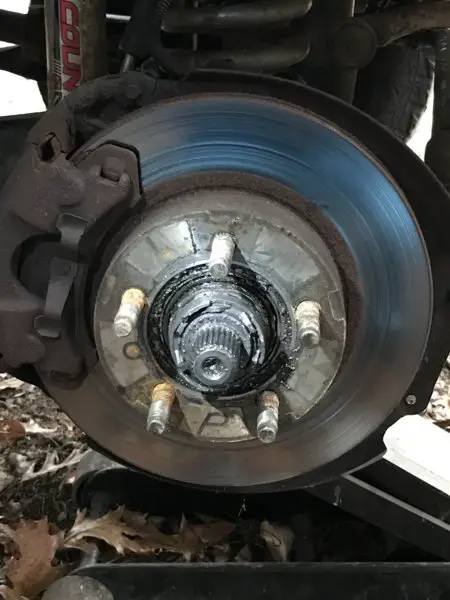

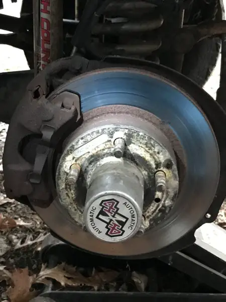

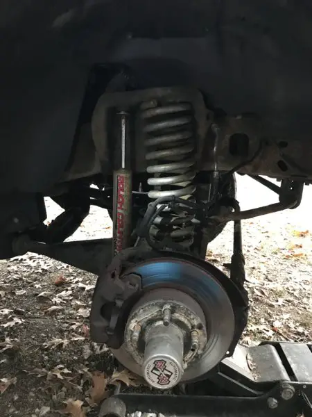

you guys will have to ask me about these pics cause I don't know what these parts are stock or aftermarket. I do apreciate all comments and discussion about them. I would like to know what I have.
thank you, jmczzz
Albino 94LTD
Recovering from Moab 2016
June 24, 2003
3,895
100
Newcastle Wa
White 94 Limited
Callsign
KG7PKQ
That is a Rough Country 4" suspension lift.
The hubs are the OEM automatic hubs (think about replacing with manual)
Ideally, the rear swaybar end links need to be longer.
Otherwise, check the gearing, replace the speedometer gear to correct the speedometer reading and drive the heck out of it.
Albino 94LTD
June 24, 2003
3,895
100
Newcastle Wa
White 94 Limited
Callsign
KG7PKQ
Actually, one of those hubs looks like the internals have been removed (the clean one).
IF u mean the pic of the two, the one the piece of wood points too is the ring like spacer that surronds the actual autohub. see the pic of the assembled wheel with tire, hub and the surround spacer thing all installed. I thought it was unusual but it looks ok just needs cleaning up. the hub is not packed with old hard grease as i read in some of the old post. it looks to me like sombody was servicing them. thanks, jmczzz
how do i do that? get longer ones and install? do you have a scource and what sizeo i need? good infor about the 4" lift. is it the coil springs and the strut? the colil is approx 14 inches top to bottom. thanks, jmczzz

OOoh I like this truck. I like those wheels I would keep them.
It is a standard 4" drop bracket lift kit, nicely done it looks to be properly installed
You NEED to remove those auto hubs and replace them with manual hubs, that would be my first "mod"
Next count the rotations so you know what gears are in your diffs!!! We must know!!
Next time you do brake job on the front replace those slide pins they look to be 1994

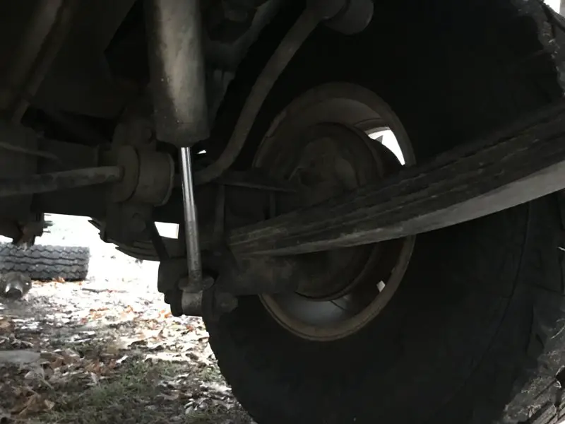

Can you get a picture of the back of the leaf springs, right below/front of the rear bumper? I want to see if you have lift shackles in the back

here are the back of leaf springs pis>

i got the front tires jack up off the ground and got under and turned the front axle. the pass side tire did not move (that;s the one I took off earlier for the lift pics before) the drivers side did turn. It seemed I could here clicking from the front diff. I could stop the drivers side wheel rotate the axle back and forth and it would click unlock sometimes, then I turned it in the forward direction and it turned the driver side wheel but not the pass side. I could stop it turning by holding or turnning the wheel backwards. I will try cleaning them both an lightly grease them to see if I can get them to work properly. I would rather not buy/replace with manuals at this point. Let me see what else comes up during the rest of the check out. There seemed to ba a lot of clicking coming from the front diff?

Sounds like the front diff is working, you have an open front diff..the two tires/axle shafts work independently from one another
Clicking noises in the diff may or may not be normal, as you spin your axle shafts (halfshafts) from forward to backwards you should hear some clunking/thud noises
What you are looking for is excessive "slop" or play between the hubs and axleshafts, and the axleshafts to front driveshaft and back to the t case.
The hubs should auto lock the wheel to the axle shaft as soon as you start moving the axleshaft inside the auto hub.
If it does not engage, then the hubs are likely bad.
You can get manual hubs, and hardware at the junk yard, many Rangers and some explorers came stock with them. Plus over the years, many, many people convert to them so they show up in the JY often.
I can't wait to see what gears you have, its like being tuned into your favorite show...."on this episode project old guy sport, we finally reveal the gear ratios!"
I want to know how long shes been running around with 33" tires and 3.27 gears OR if they did the right thing and re geared.......so far it seems like your still stock
