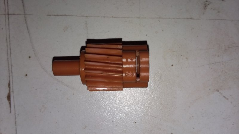

I have a few of these gears in the tool box. I found a used 19 tooth RH. Motorcraft will say RH or LH on them. This is a RH.
This size will get you close to the proper speed with 33's. I have found that the 20 tooth works best with 33's & 35's. If you want this 19T, you can have it, just send me a Private message with information on where to send it. It's not perfect, but it still works fine.
