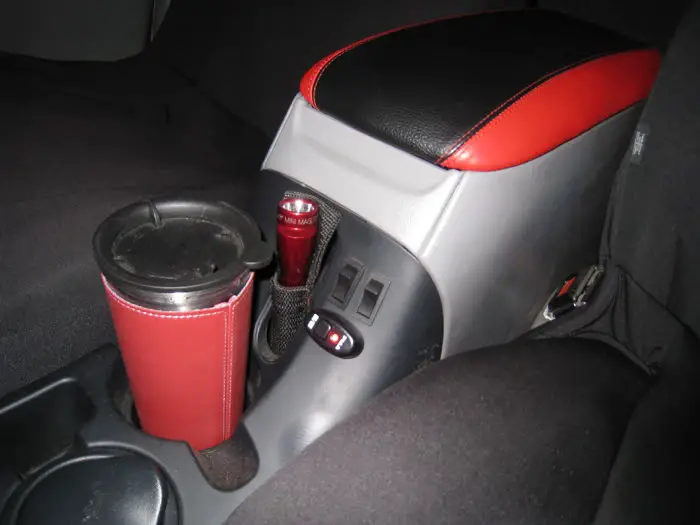

Perfect Maglight mini holder. :D
Jason, I've never thought of that- stellar idea!!
Oh, I take it that they're one size fits all then and therefore don't fit very well?
Yep, OSFA. They were only supposed to be a temporary offroading thing, but I liked the way they looked and they've been on for a while now. They fit OK, but they kept popping up in the front, so I punched some grommets into them and tied them down underneat the seat. Big improvement.
Thanks man. It's just one of those things that happened. "I wonder if this would fit in - PERFECT!" :D The nylon sleeve couldnt fit any better, and it doesn't move around at all.

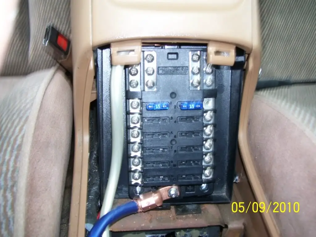

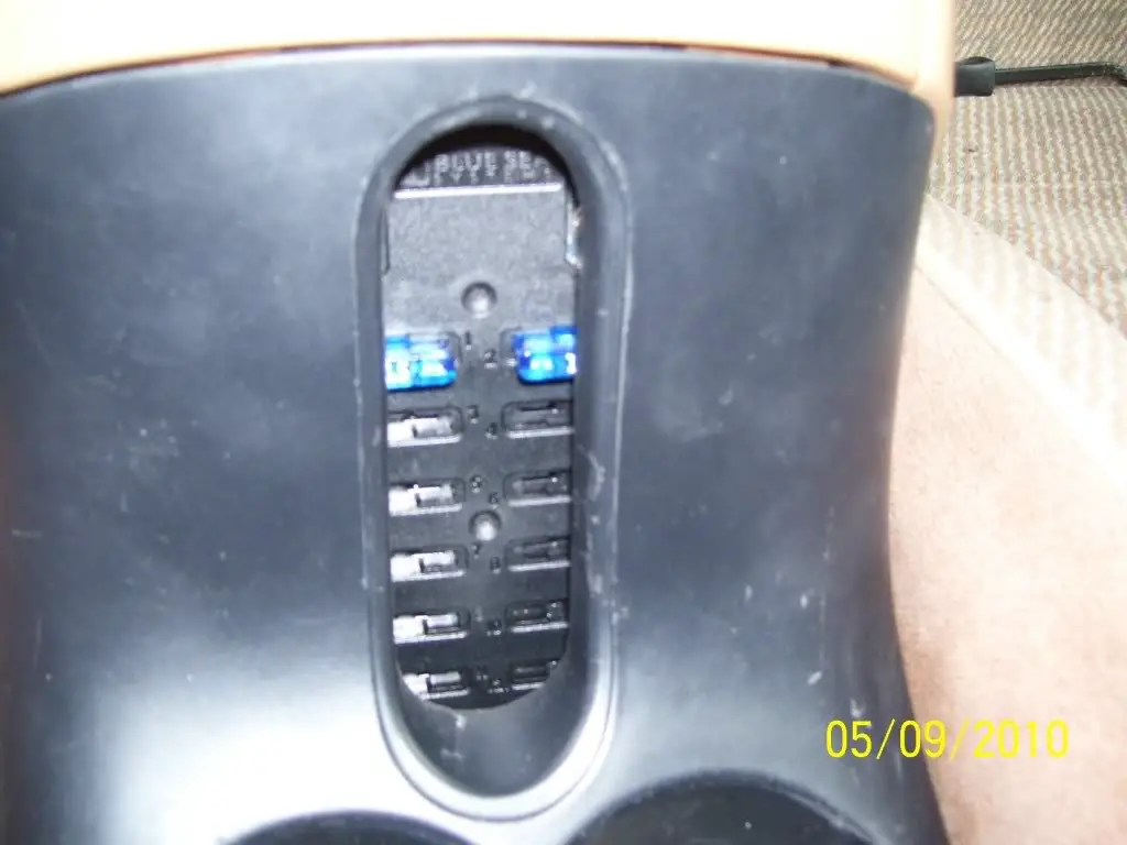

what is this?
A 12 point fuse block to run accessories with. 4 ga wire ran to the battery and 4 ga ran to the chassis for ground.
Wires can be ran inside the full length console to hide, and this is a simple way to check fuses. Perfect for stereos, CB radios, lights, etc....
I never once used the tissue holder for what it was meant for, so dead space was utilized to accommodate the extra fuse block.
