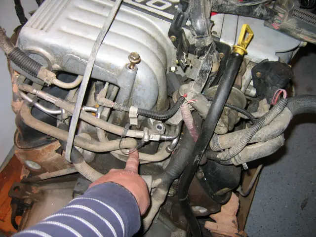

Where is the PCV located on this bad boy?
This should help.
http://www.explorerforum.com/forums/showthread.php?t=157568
Look at post #7. by 410Fortune
This is the picture from post 7.
That picture is of the rear of the engine.

WOW!!!!!!! of course it couldn't be easy to get to, lol. Any ideas or tricks for gettin it out of there? Do I need to pull the top end?

Did you get at that PCV yet? I have read about problems with the rubber grommet that it goes into.

Yea, got the PCV but can't get my hand back behind there enough to replace it so I think I'm gonna take it to the shop and let them mess with it. Didn't really want to spend the cash, but gotta get it fixed. Any idea how to check the fuel pressure?
