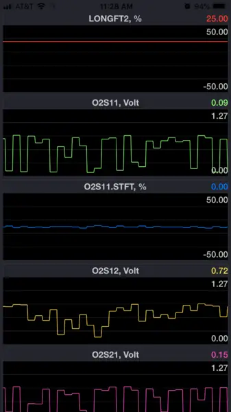

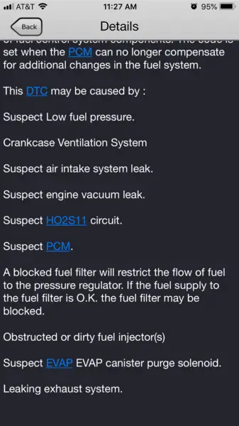

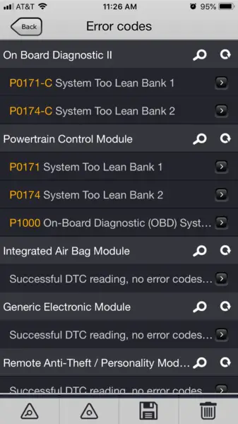

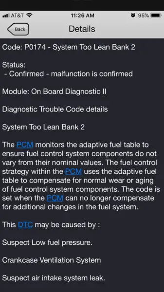

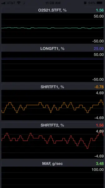

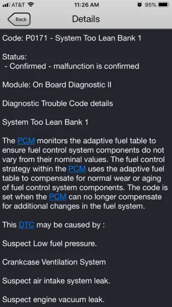

My 40.L SOHC 1995 has these codes. I already sprayed the MAF and changed the IAC valve which had generated its own error code.
I have attached the FORScan app screen grabs showing fuel trim at idle and the error codes and explanations.
A year ago when I had a similar problem I checked everywhere for a vacuum leak with propane and found nothing. I plan to repeat the vacuum leak test with starter fluid. If I find nothing, I will probably change the intake manifold gaskets anyway. Or would DPFE sensor would be a better second step?
