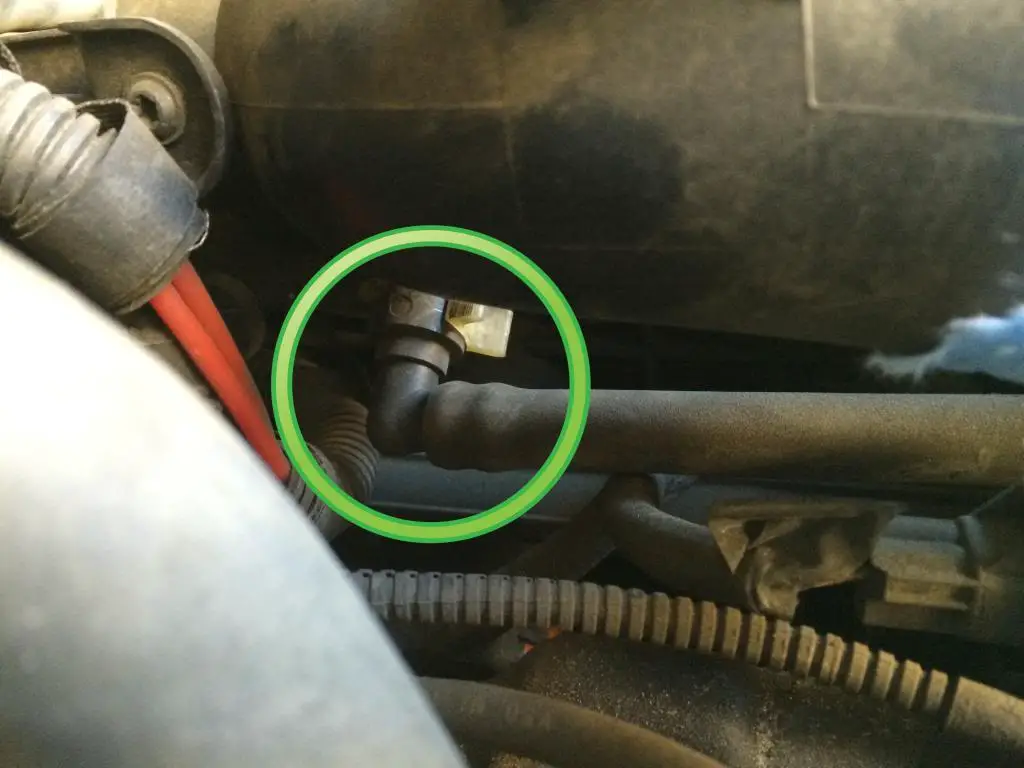

OUTSTANDING!!!! Pic ID'd it perfectly. Entire top of bend was semi-collapsed with a big nasty slit.
Hats off to all the contributors to this!!
Update: With with check engine lite getting consistently tripped after 5 minutes of driving time, placed a strip of electrical tape over the opening and problem hasn't occured with 100 miles of drive time. Nice way to verify the problem.
Update to the update: Amazon's link for part is here:
http://www.amazon.com/gp/product/B000V50D3I/ref=oh_details_o00_s00_i00?ie=UTF8&psc=1
(also realize the parts pic doesn't represent the item you're gonna get, but it is the correct p/n)

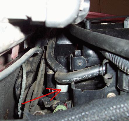

It's amazing how much vacuum is present in the suspect elbow. I've had the codes for a few weeks now and after checking this forum, I decided it was time to get it done. I started it this morning and was somewhat surprised to see the elbow pretty much totally collapsed by the vacuum - I touched it and could hear the rush of air.
I removed the elbow and tightly taped it up with rubber tape - reset the DTC's and drove it for 60 miles. All is well and I've ordered a complete new hose to be installed next week.

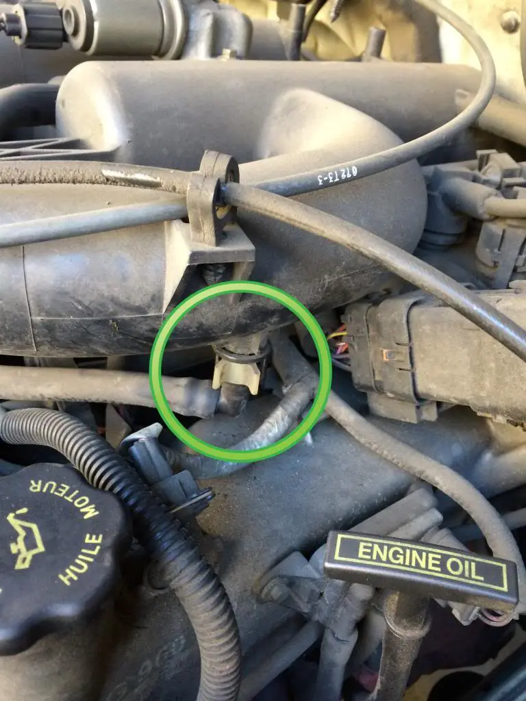

Hello all, I've read through this thread and am having some trouble. My fiance's 2001 ford explore sport is throwing a P0174 code. I reset the code last weekend just to see if it would come back and it did several days later.
I tried searching for the PCV elbow that people have been finding cracks in and replaceing. I really feel like a fool b/c after searching for a long time I could not find the PCV elbows. What I did find was these two elbows.
Is her engine model different then the ones in this thread? The elbow I found are plastic and they have a T connection in the middle of the hose heading to another location I could not see.
Am I looking in the wrong place for the PVC elblows ? If so could someone help me out and point me in the right direction?
Is this model a Job 1 ? I saw Job 1's were sport tracks but is the sport also fall in the Job 1 category? If so what should I be checking.
Thank you

. . . My fiance's 2001 ford explore sport is throwing a P0174 code. I reset the code last weekend just to see if it would come back and it did several days later.
I tried searching for the PCV elbow that people have been finding cracks in and replaceing. I really feel like a fool b/c after searching for a long time I could not find the PCV elbows. What I did find was these two elbows. . . Is her engine model different then the ones in this thread? The elbow I found are plastic and they have a T connection in the middle of the hose heading to another location I could not see.
Thank you
Those are the connections for the fuel vapor management valve hose. The two hoses combine into one hose at the front of the engine that is routed down and then over to the fuel vapor management valve below the battery tray. The PCV valve is located behind the upper intake manifold.
See this thread for more info: SOHC PCV Valve Mod thru 2000
Thank you, I'll look at the linked thread. could the PCV valve be the cause of the P0174? If so I'll replace it for sure, the car has 208K on it so I'm sure it could use a new PCV.
