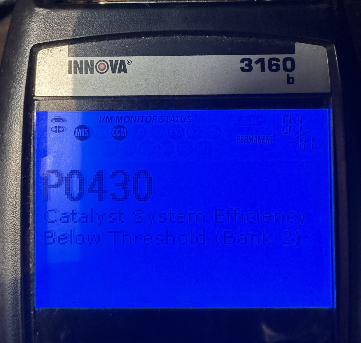

Hi,The codes read as follows:
P0430: Catalyst System Efficiency → Below Threshold → Bank 2
P0420: Catalyst System Efficiency – Below Threshold
It seems your bank 2 catalyst is the problem. Before replacing it you could try a catalyst cleaner like cataclean. You could also run a couple of tanks of premium gas, it would be ideal to drive in the highway/freeway. A road trip would be ideal.
We don’t have catalcean here only liqui molly. Will give it a try and see results. For fuel we have PG-91 and PG-95 here in Saudi Arabia. I use PG-91 on my explorer 2013.
So you want me to add PG-95 half tank with liqui molly ?
