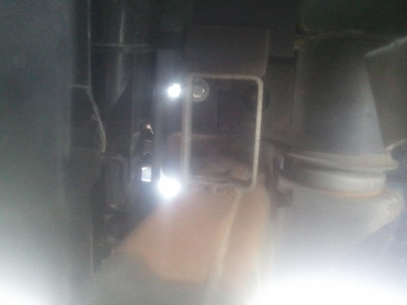

i just put my pa 853 on my 96xlt and had a question. what can i do about lower radiator mounts. they dont line up and i want the support under too not only from hanging off the brackets...
Do you know anybody with a welder? If so take the the rectangle lower mounts that came with the kit and line them up on the frame and to the bottom of the radiator, and weld them on the frame. Thats what i ended up doing on my 96
do you have pictures of this??

hey i will send u picture by email if you want,, u should put the rubber inside the bracket to hang them ,,you'v got to do some grinding.... or i can text to you.954.647.4790..
