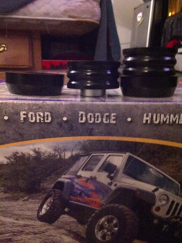

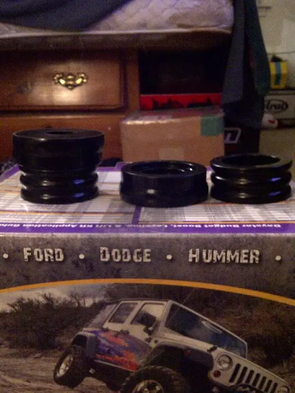

Couldn't take any pics tonight by the truck because its raining out but i did take pics of the bushings themselves.
Here's the kit lay out
As in the instructions, here's what they recommend front to back.
Very front of the truck
Behind front wheel wells
These are the ones used beneath the seats about the middle of the truck and also used in the very back as in the instructions.
These ones would be used underneath the storage compartments as in the instructions.
Not sure what the little tiny ones are used for yet. Also i'm not saying all this will work in the places the instructions states, however i believe the majority of them can work. They may even have to be "rigged up" so to speak with the possibility of using longer bolts. I'll get some pics next to the stock bushings on the truck itself. Also this kit may lift it just a little bit more if you were able to use these bushings where the instructions want you to use them. Example would be the uppers beneath the seats look too tall with the 4 ring bushing, the 3 ring would fit better there. I'm just saying you may have to move uppers to lowers, fronts to backs etc etc. I'll know more later as i try to finagle this kit.

They will work you just can't use the directions they say like the order from front to back. Use your best judgement and match up the bushings with the ones that look like your trucks bushings.
