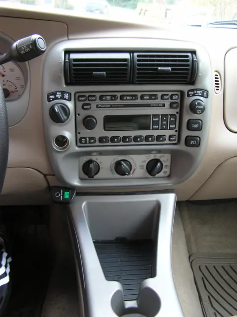

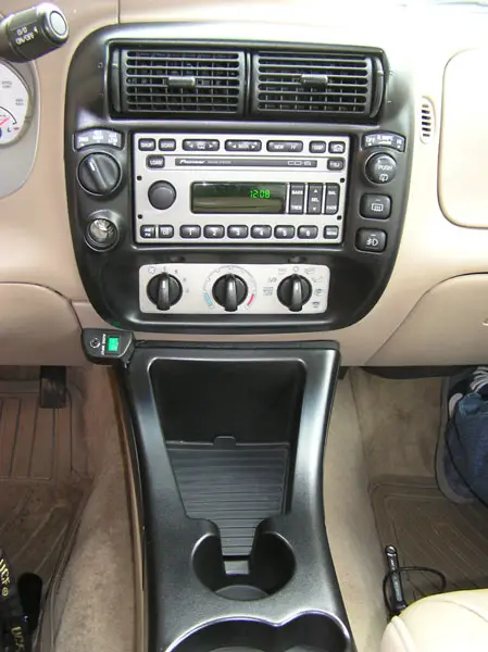

Had annoying squeak in center console so when I finally got the console out (Big Thanks to ncranchero) elected to paint the console and radio bezel black. Motivated by postive results from others and new look it would give the truck. When spring comes will do some door trim and other plastic bits as well as this is some easy work.
EZ job once I had the console out. Used Krylon fusion left over from the exterior tupperware job. Had more flat than satin so laid down initial coat with flat, let dry 15-20 minutes then second coat was satin. Dried 1.5 hours and gingerly put it back in the truck.
Was easier to unscrew the 4x4 and Rear wiper/controls than worrying about masking them. Gently put everything back, got a big thanks from my son (it's his truck) and done for now.
Did want to do the silver bezel around the instruments but it is attached to the vinyl part of the dash, removed the top three screws in the instrument cluster but the silver bezel did not pop out. Would love to paint it black but looks like the whole piece must come out and over the steering column to remove. Thoughts? Ideas? Anyone painted that piece?

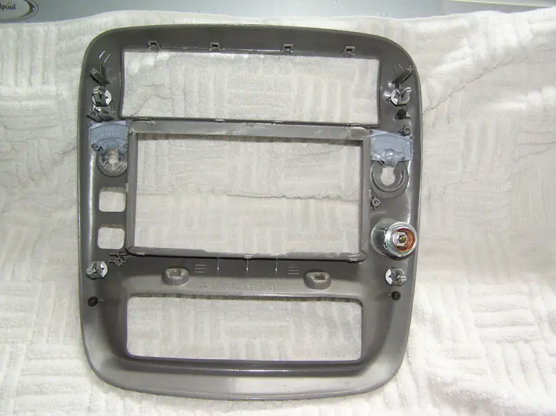

Here is the radio bezel taped off and prepped for painting. Std blue masking tape. Of note is that there is clear plastic melted to the bezel, this clear plastic acts as a conduit for the lights to illuminate the 4x4 and Rear wipers during night driving. I could have protected these better with tape but ended up removing the paint afterwards with a q-tip and goof-off. Either way will work.
I also stuffed some paper towel into the cigarette lighter so paint wouldn't ruin the contacts.

That silver bezel and console actually looks pretty cool didn't know they came in that color. Good work on the paint job man.
Keeper,
the silver is fine but the black really makes the gold exterior and tan "pop". Also the fresh paint freshens the look and there were a couple of scratches that I made disappear with the fresh paint as well. My son likes the effect and I think we keep going more and more towards black and gold. Maybe he'll become a US Army Golden Knight! I think their colors are gold and black.

The silver against the tan does look a little washed out. The black looks great...I like the contrast between the silver radio and black bezel too.

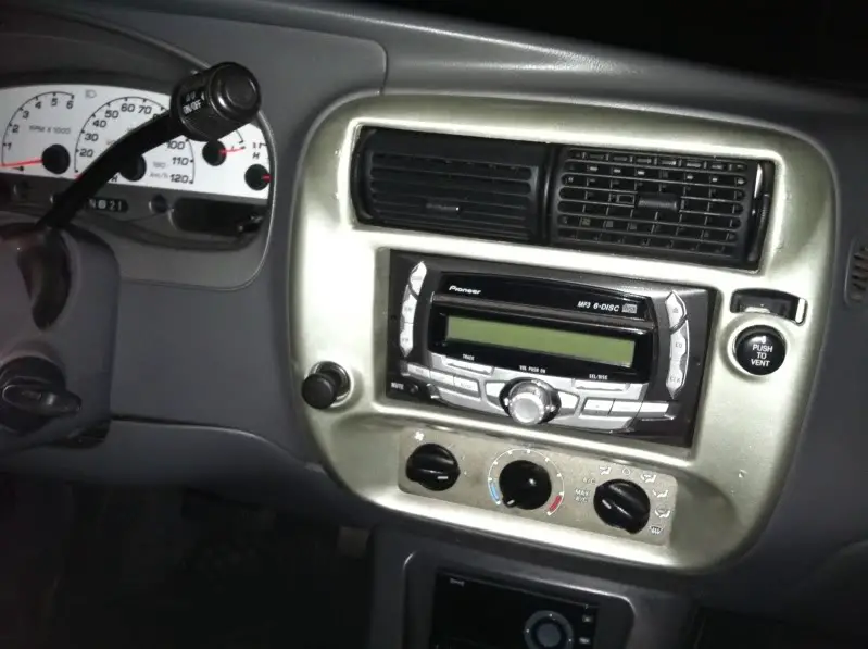

Got this painted... I think the flash from my phone makes the color look a little off... Maybe I'll change the color... but it's better than the peeling silver that was on there..
