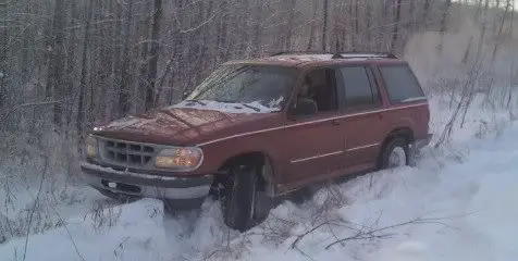

I really don't like the chrome look of my bumper and grill so I was thinking of painting them.
My truck:
Yes? No?
And any opinions as to flat black or gloss black? Bedliner for bumper maybe?

You should paint it the same color as the explorer, red. I think that looks best.

Well I was considering going for a black theme. Painting my rims black, tinting my headlights and tail lights, painting my grill/bumpers, re-paint the trim and get new window tint. I just can't really picture it, so I need someone to photoshop a pic for me

my experience with this is that it's tough to get anything to stick to the chrome

it can be done, you have to sand blast it first, then you put epoxy primer on it, then prime it. i have done it to a few bumpers, and haven't had any problems.

I was thinking about doin the same thing, but ive got a 01 sport
i think it looks great
go for it:thumbsup:

try herculiner
