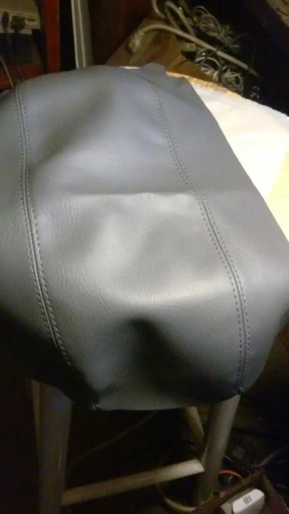

For like $16 you can get oem color center console lid (synthetic leather) covers....look actually look pretty good....key is accessing upholstery stable gun to achieve a nice tug fit. I have a new Explorer light grey spare one someone can have for ground shipping... SEE HERE:

/\ Hey boss....just found it going through some stuff..... Sent you P.M. but that format doesn't allow pics...
The seller folded it for shipping so it has minor crease... have flat weight sitting on it now to diminish crease...and then once pulled tight and stapled should look fine.... Let me know via here and or P.M. if still needed.
