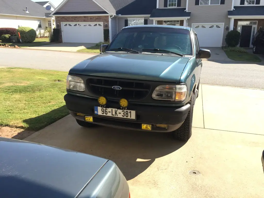

Thanks! You have some good advise as well. RandomNerd2000, you might want to go black, instead of body colored. Even a 100% correct to the color code spray can might not match your body paint, due to age, oxidation, and sun fade.
Both of my Explorers have had black grills, and on the right color Explorer, I think it looks great. Here's my current '96 XLT, with green paint and a black grill.
(And yes, I know I still need to get off my lay hide and paint the lower front bumper chin thing.)
