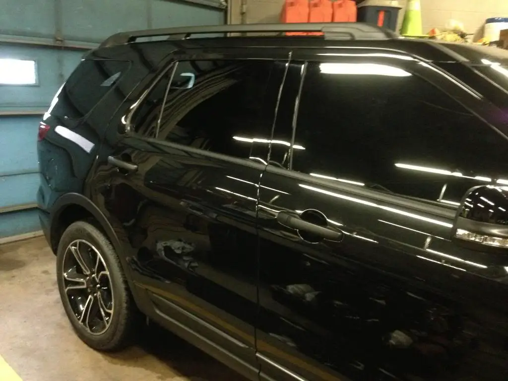

Plasti dipped my door handles black. I like them a lot better then that chrome BS. Also got the front windows matched to the rear, 20%.
That looks sweet. I bought some plasti-dip to do the door handles but haven't got to them yet. I know to mask around the door handle so that some of the plasti-dip will get on the paint and then peel the dried plasti-dip that is on the paint. Any other tips?
I was nervous and papered and taped the car so no over spray got on the car. But here is a tip... I did not spray behind the handle because it is already black in there. But if you do this project DO spray in there. I'm starting to get some peel because of grabbing in there to pull the handle. If you spray in there you will not have a starting point for it to start peeling.

Thanks the for tip on dipping the grab side of handles. I wondered about that.

There was only one key hole (drivers side), I cut a small piece of mask tape and pushed it in there. It was a little tricky getting it out, but it came out with, just have a razor handy.
I didn't mask the whole car, just around the handles. I can post a picture in a little while. I have keyless enty, Its on the B post, no where near the handles.
I think removing the handles will be a HUGE waste of time. I mean with having to take apart each door from the inside and all... It took about 5 minutes to mask each door, 30 minutes in between coats, 4 coats, 5 minutes to pull the mask off. Done!
