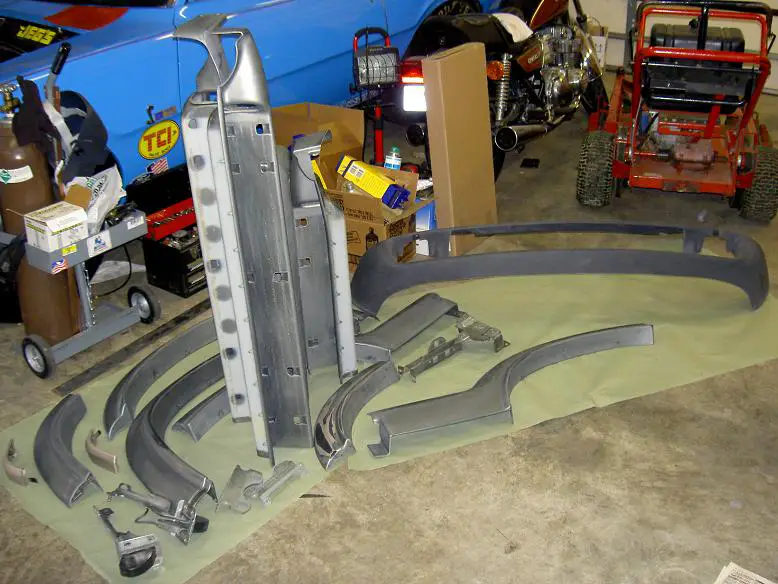

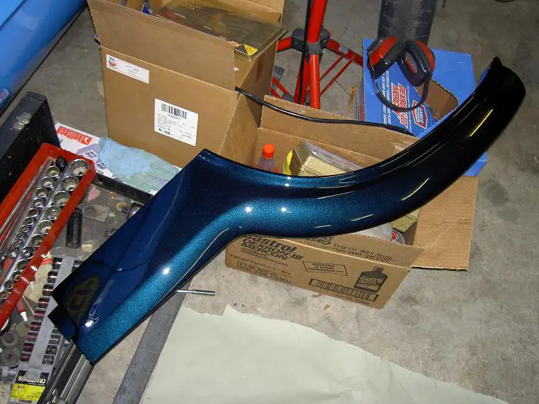

I have just painted the 99-01 flares, etc. There are ten main parts, plus the two tiny corners, and the center hatch trim piece. That doesn't include the four running board parts. They can take a while to remove also. Good luck,

We also painted a couple of other small parts, plus the hood. That all took a full quart of paint, a single stage urethane. The labor for the paint prep was easily four hours just for the flares, etc. People underestimate how much tedious sanding there is to do. I don't have much respect for some peoples idea of prep; scrubbing with paint thinner, and done.
BTW mine was for a work vehicle, so perfection wasn't the goal for me. Many smalls scuffs exist in the plastic, I sanded them hard with 220 wet sanding first. Choose base/clear if you can, clear is far easier to finish after cured. Regards,
