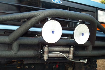

I bought a James Duff bumper in 1998, and coated it with Line-X. Back then, Duff did not make a winch compatible bumper that fit RBVs. So after a few years and the realization that a winch would be a requirement for the rig, I bought a Ramsey REP 8000 winch and had a local welder modify the Duff Bumper to fit the winch between the frame rails.
Here's a picture with the old roller fairlead, circa 2002.

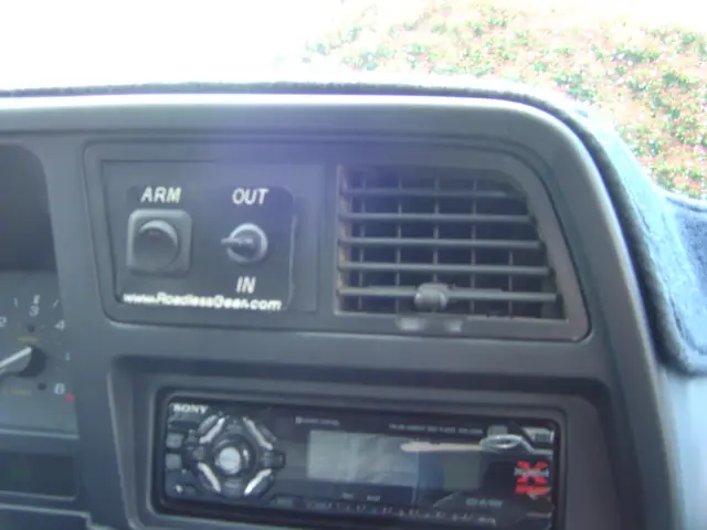

I have in-cab controls for the winch, but also have the control box located behind the grill, accessible to plug in (seen above in lower passenger side portion of grill) if I have to manipulate the winch from outside the vehicle.
Was a late convert to synthetic winch line, but once the steel cable was worn out, opted for the Warn "Spydura" in 3/8. Here's a recent picture, with hawse fairlead.

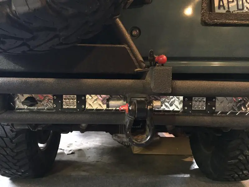

Rear Bumper

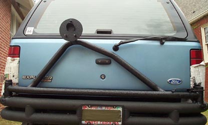

In 1998, I mounted a Smittybilt dual tube rear bumper, and a few years later (2002) added a swing-away tire carrier, and here's a picture of that effort.
Although not a terrible option, it was not hardy enough to withstand the rigors of off-roading, and failed a few years later. The Smittybilt really did not have the strength to support the extra tubing and weight of the 33" spare tire.

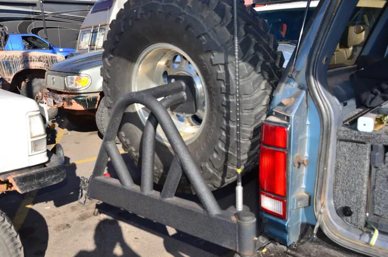

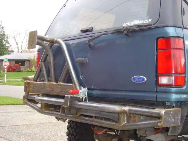

In 2009 I contacted a guy in Colorado that built bumpers for Early Broncos, and convinced him to build one for my Explorer. . . I sent the measurements and a few pictures and ended up with this:
Like the front, I had it covered in Line-X. Not much doubt that this thing has no issues carrying a spare tire. . .
Thread for newer bumper: New Mod. . .

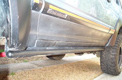

Rock Sliders
I attended my first "Serious Explorations" Run in April 1999 and met up with Rick, Jack Lobdell, Paul Gagnon, and Trace Allen in Blanding Utah - - where I promptly bashed my passenger side front fender. So, rock sliders were in order. A lot of guys mount sliders as "out-riggers" so they can pivot off trees and rocks, but I went with the "tucked-in" option, snugging them up under the body. Initially just spray-painted black, these have been covered multiple times in Hercu-Liner.
Picture from installation in 2002.

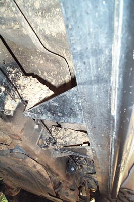

Some weld their sliders on, I opted for bolting (note cut-outs for E-brake cable).

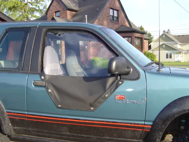

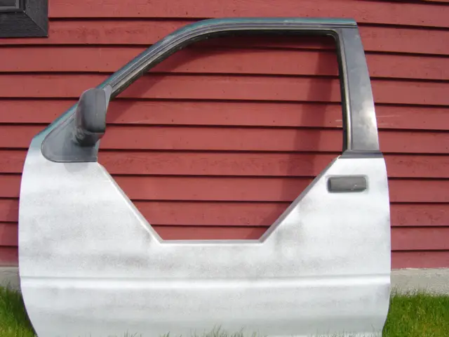

3/4 Doors
I'm built "low to the ground" so wanted the option of looking out to check the tire line on obstacles. Thought this might work. . .
Once painted and with windows attached.
Still looking good after 7 years; recent photo
Thread for the 3/4 Door project: Half Doors - Latest Project . . . Teaser

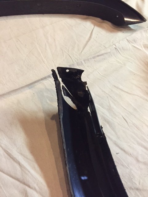

Bushwhacker Flares

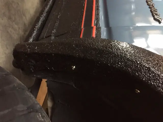

I mounted Bushwhacker's Extend-a-Fender Flares way back in 1998. Made of ABS plastic, they covered the wider tires and held up pretty well to light trail abuse. But . . . , they break apart when I hit stuff with them. . . So after 18 years of abuse I recently pulled them off and made some (hopefully) long term repairs. I had "Gorilla-Glued" and Hercu-Lined them multiple times, but this time removed all four and fiber glassed the insides to strengthen them for the long haul. Here's a look at how they were (front flare).

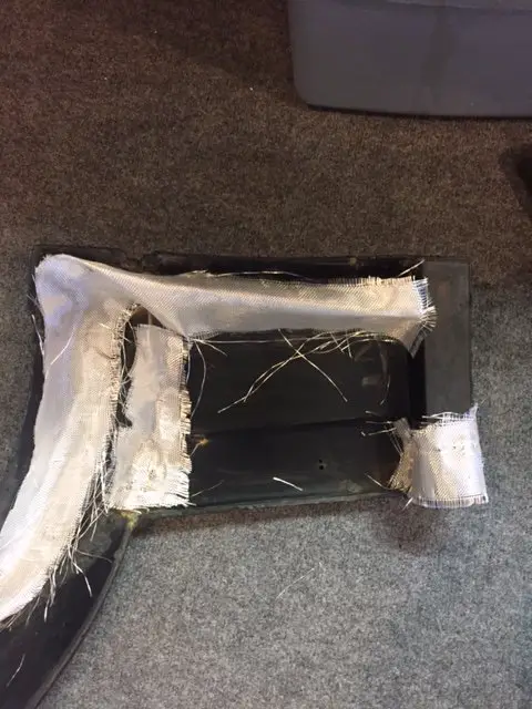

After peeling off the old residue, first used some rubberized gutter edging to reform the original shape of the flare.
This is the first time using fiber glass mat and resin - - luckily it's all on the non-showing side of the flares, but think it'll hold up. A look at the mat on one of the rear flares before applying the resin.
Once coated with another application of Hercu-Liner, I used stainless steel fasteners and finishing washers for the remount.

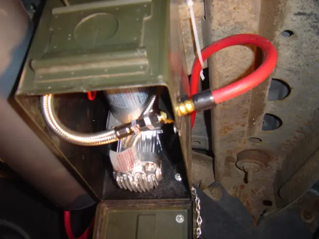

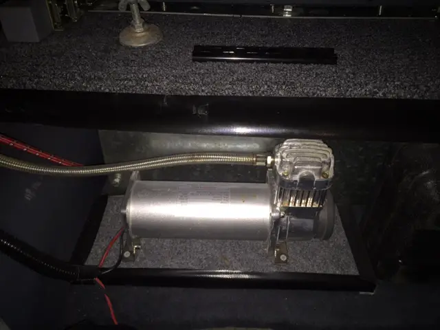

During the last several years, in addition to multiple trips to Moab, wheeling includes snow wheeling here in the Pacific Northwest and dabbling in Over Landing. The requirements of reducing significant air pressure for snow wheeling (and then re-inflating), coupled with the self-sufficiency requirements of Over Landing made on-board air a necessity.
At the time of initial installation, I did not yet have a cargo storage system, so I opted to mount the compressor, air tank, and solenoid in the void where the OEM spare tire was located. I mounted the compressor in a surplus ammo can in order to protect it from the elements.
Here's a look at the mounted compressor in 2009.
Thread on initial ViAir installation: http://www.explorerforum.com/forums/showthread.php?t=237321
I was not satisfied with my own work - - the fittings were leaky, and the compressor never ran as well as expected. So when I put together a storage unit for the rear cargo area, I found an ideal spot inside for the air compressor - - behind the rear seat at the back side of the drawer system. Here's how it sits now. Secure, well ventilated, and out of the elements.

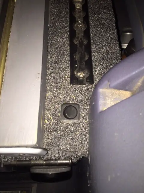

Since the ViAir is a "continuous duty cycle" unit. I abandoned the air tank (for now).
The unit is activated by a switch I placed at the rear hatch area on the deck shelf for drawers and sliders; air hose is stored in the cubby below.

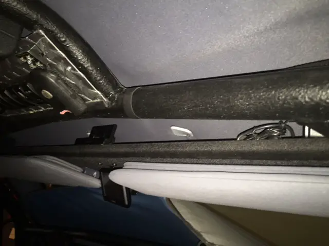

I stated that although my rig is not a "hard-core" trail rig, I have (through a combination of enthusiasm and questionable decision making) put myself in a few precarious situations while off-roading. Although I'm rarely going fast, the potential to roll multiple times if I did flop over made the idea of a roll cage a worthwhile upgrade. Since my welding experience can be summed up by two letters - - "J" and "B", obviously went to someone else to fabricate this. I had seen Josh S.'s work and was able to convince him to construct a cage for me.
Here's a few pictures of his welding and fabrication skill. . .
Cage mounted to the floorboard. . . nice welds.
I did not want to extend the cage all the back through the cargo area, but Josh added "tabs" in the rear passenger area for any potential future additions.
Thread on Roll Cage fabrication: http://www.explorerforum.com/forums/showthread.php?t=395318

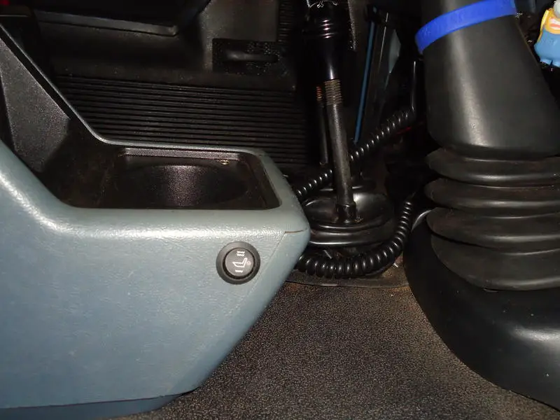

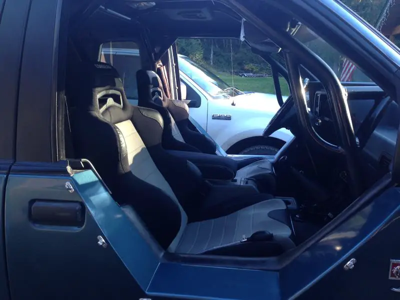

After 20+ years, the seats had seen better days, so while the cage was being worked, I ordered up a set of Corbeau seats, with lumbar and heat...
Took me a while to figure out where to wire the switch for the seat heat, ended up here. Easy access for turning the heat on, and I have never regretted this upgrade a few seconds after I activate the switch. Well worth the investment.

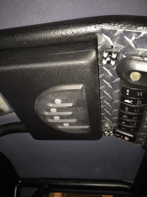

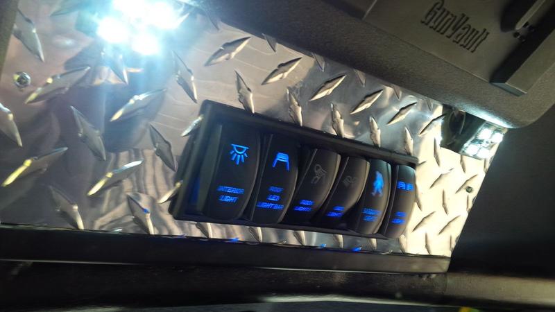

As previously mentioned, I had mounted an interior switch control for the Ramsey REP8000 winch, and since I had added the Atlas II transfer case, the electronic OEM 4x4 switch area was the ideal place for the in cabin winch control.
LED light bars and spot lights are all the rage, so needed to get in on the action - - big issue though, where to put the switches ? ? ? Not as if there is excess room in the cockpit . . . luckily this website provides a lot of great options, from guys smarter than me, so overhead they went, on some scrap aluminum diamond tread I mounted between two supports for the cage. Here's a look.
Thread for the switch upgrade: http://www.explorerforum.com/forums/showthread.php?t=437350

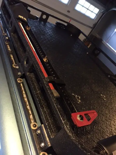

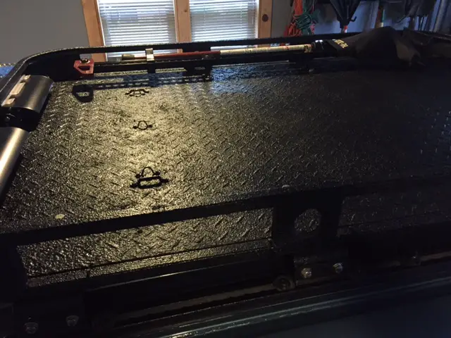

Con-Ferr Roof Rack
Installed the Con-Ferr Roof Rack back in 1999, and it has been mounted and removed numerous times, depending on whether I needed the additional storage. Like a lot of my stuff, it's been Hercu-Lined a few times. . . Since I've mounted lights to it, even with wiring quick disconnects, it's probably staying up there for the long haul. Here's a picture showing the Hi-lift jack, a pair of forward facing LED light bars, and some tie-down loops for fuel cans.
The rack also makes a good storage spot for the Hi-Lift - - nothing fancy for the install, just bolts. springs, washers and wing nuts.

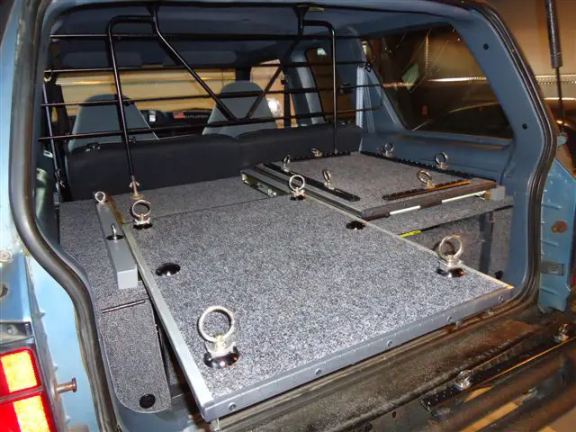

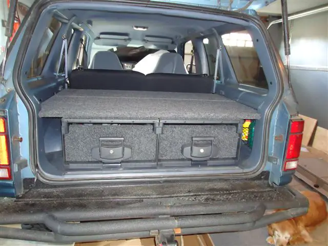

Cargo Storage System

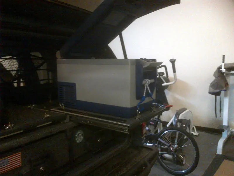

I had used a few different storage solutions for hauling camping and wheeling gear - - Action Packers, foot locker, milk crates, etc., but was really impressed by the ARB sponsored Outback Solutions drawer set. Although not specifically made for the Explorer, I co-opted a set for the Wrangler to fit. Here's a shot of them in the cargo area after I fitted them with a wood deck (carpeted).
When I purchased these, "sliders" weren't an option on these smaller units, and I wanted something to slide out for a toolbox, cooler, or fridge - - so I sourced some old computer stand trays and fabbed them to fit, using the original drawer "tops". Thought they came out well.
And with 37 Qt. ARB fridge.
These drawers are well built and have virtually no signs of wear after 3+ plus years of use (recent photo).
Thread to Outback Solutions installation: http://www.explorerforum.com/forums/showthread.php?t=372632

Gun Vault
With 3/4 doors and canvas windows, having something lockable in the driver's area was important to me; I don't even have door locks on the doors - - I would rather someone just open the door as opposed to cut the canvas... When Josh made the roll cage, one of the requirements was for him to install the small gun safe. It's located midway between the seats, just forward of the interior dome light.

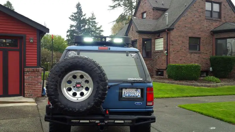

Roof Rack LEDs
Like the idea of more lights, so up on the Con-Ferr the went. Like the fact that the rack protects the lights for errant tree branches. They are set back a bit farther than optimal, but still good enough for my uses.

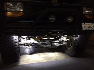

Rock Lights
Plenty of uses for these low priced LEDs, so had to put some in.

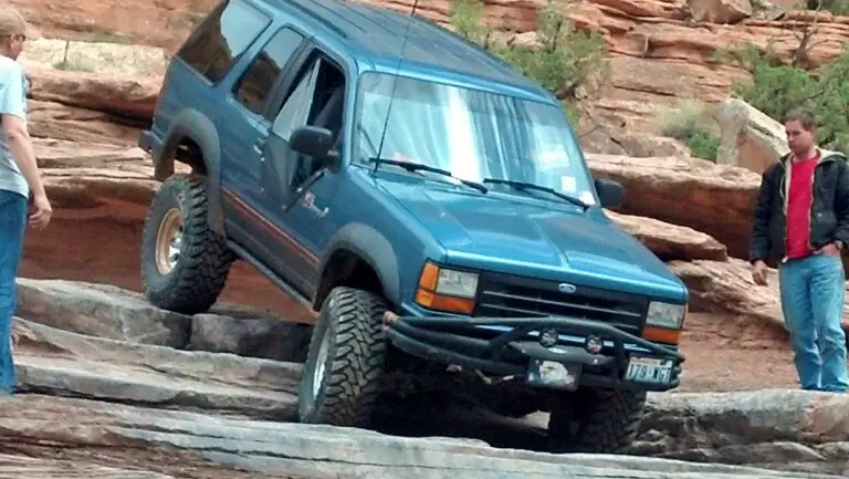

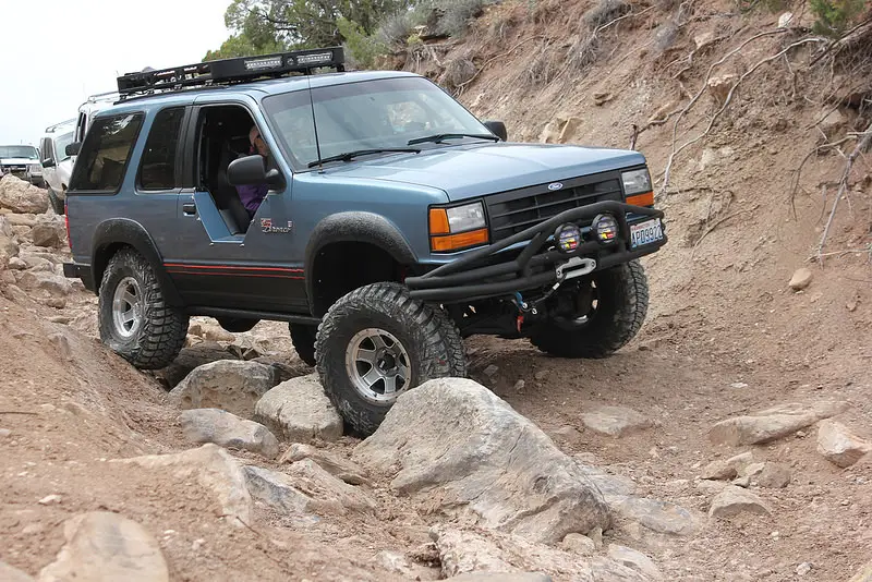

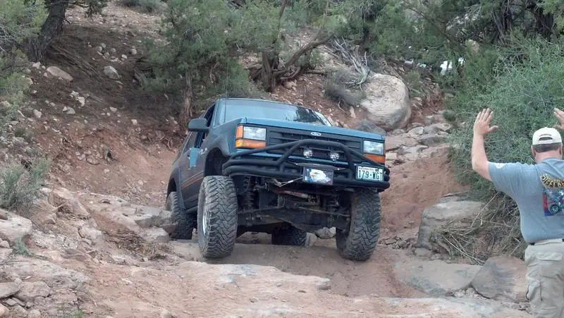

Wheeling Pics ! ! !

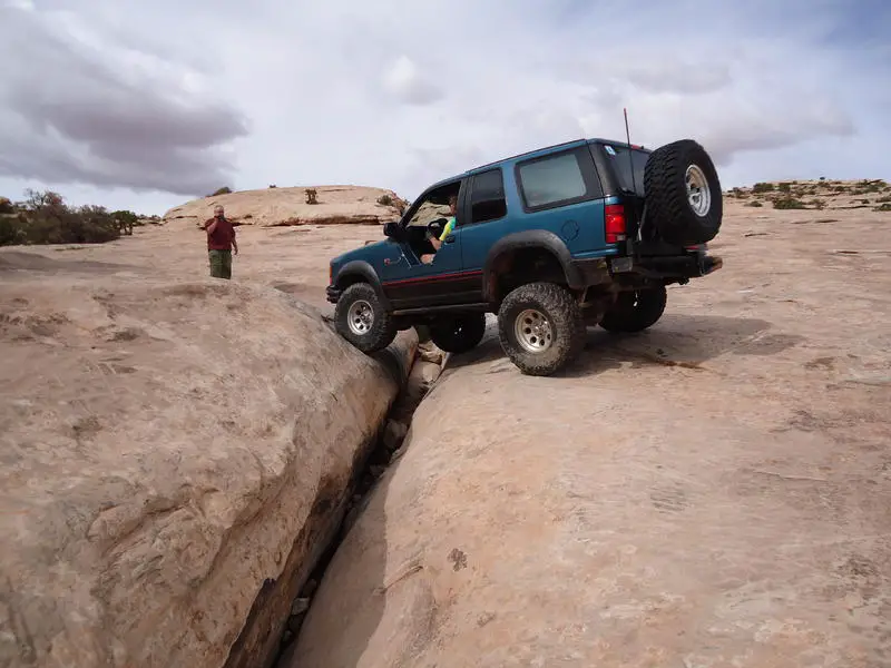

Fer Chrissake, just realized almost every photo on this thread was taken in the garage or driveway! ! !

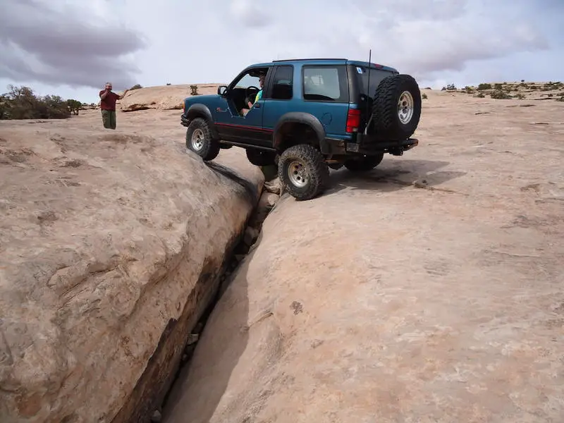

Here's a few action shots, all from Moab 2013. . .
Moab Rim, "Z-Turn" obstacle:
Green Day, hill climb:

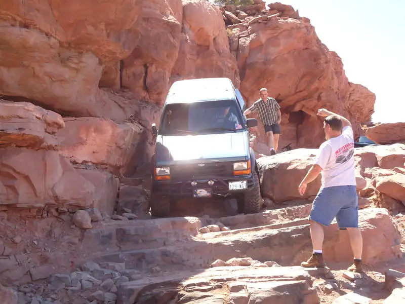

Golden Crack obstacle:
Cliff Hanger, coming down the big step:
Although not on this trip, this is the location where I muttered to my ground guide. . . "I'd rather plunge this thing off the cliff
than scrape the hell out of my passenger side sheetmetal. . ."
It's all about priorities. . .
Here's a look at the Cliffhanger obstacle from a distance; it doesn't look perilous until you're looking over the edge from the driver's seat. . .

Moab 2016
Probably the best photo of my rig from Moab (taken by Tracy, aka Jeep Girl, or Mrs. RockRanger) while going the wrong way on Strike Ravine. . .
Trip was a good opportunity to re-acquaint the "Better-Half" to four wheeling and Moab; her last visit was in 2000.

Paul I read nothing about the most important part of your front bumper! We all know why that front bar is up so high to hold on to. :)
Very nice write-up!

Paul I read nothing about the most important part of your front bumper! We all know why that front bar is up so high to hold on to. :) Very nice write-up!
Ryan! -
Hope this finds you well, and thanks for the comments; as you might expect, it's a "work in progress" - - at least that what 2 1/2 decades of ownership has gotten me. . .
The front hoop does help when nature calls, but haven't used it in that mode for some time, wouldn't want to soil that new synthetic winch line!

Well, been almost a year since this happened. . .
Stic-o
Elite Movie Star
September 1, 2002
13,942
762
Lake View Terrace, CA
'91 Navajo '99 XL '16 XLT
I heard about this, is it all back together now? I'm taking some notes for my sport build.;)
