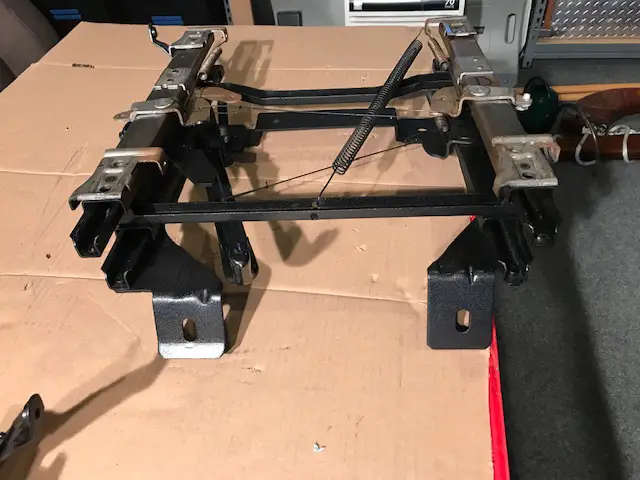

Seating Upgrade (Cont.):
Since everything is torn apart, thought I'd give the frame rails a fresh coat of paint:
. . . and threw some grease on the rails and some oil on the springs.
Switch location for the heated seats was a no-brainer - - just forward of the OEM lumbar and bolster switches:

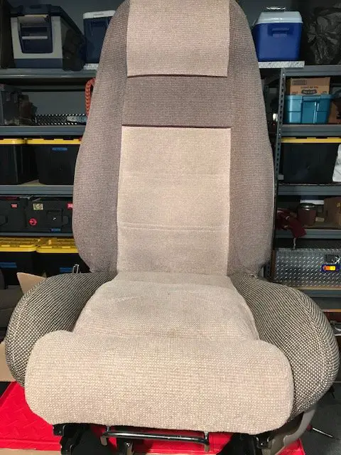

Finished seat, ready to go back in:
Going to spray them down with upholstery/carpet cleaner tomorrow before the install, and although the wiring for the heated panels is complete, still need to pre-run the other three wires for the as-yet-unused fuses in the fuse block in the center console.

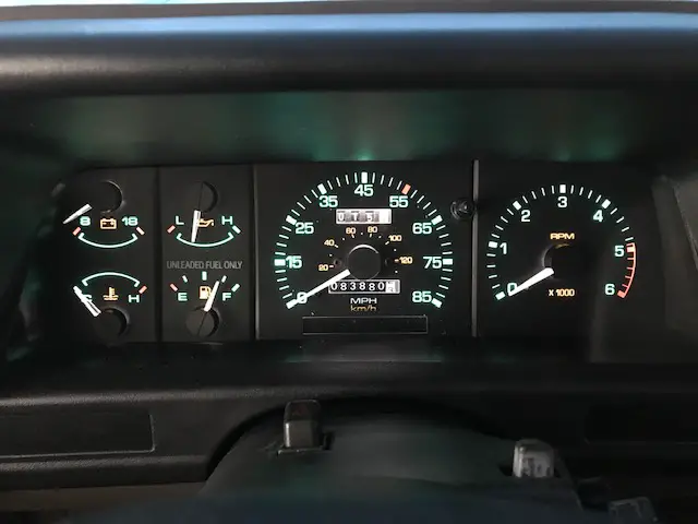

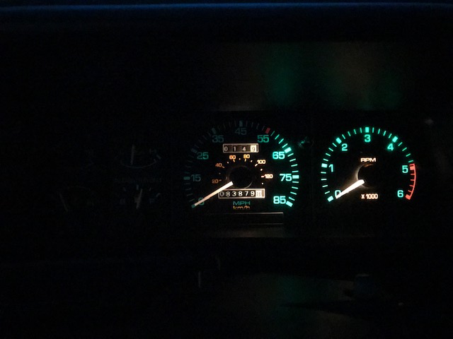

Dash Light Upgrade:

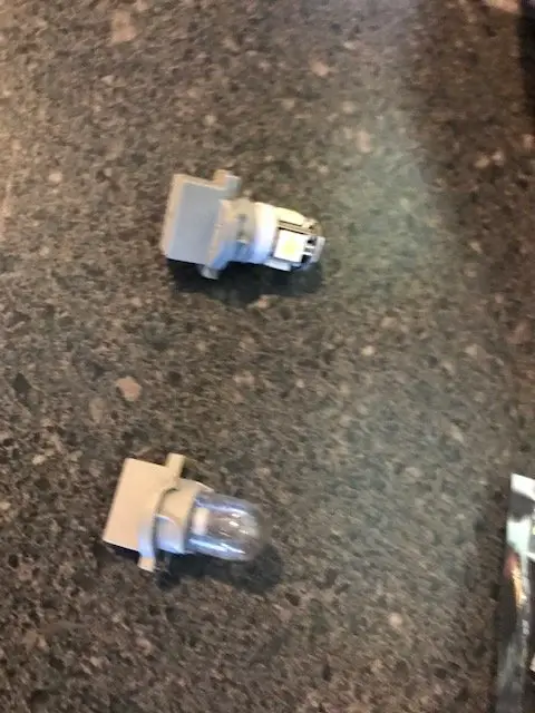

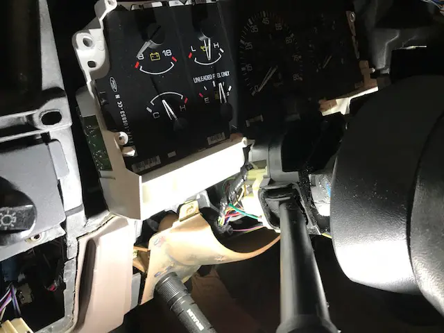

Knew the dash "idiot" lights were not all working, also a burnt bulb on one of the turn signal indicators, and half of the backlight bulbs for the dash were inop, so added an LED dash light upgrade to the "Drivability" List.
Here's the dash:
Swapped out the old bulbs (lower) with LED replacements (upper), but decided to keep regular bulbs for the turn signal indicators in case there was a resistance issue with the LEDs (turn signal indicator bulbs also replaced with new, just not LED).
A whole lot of effort to replace a dozen or so light bulbs. . .
. . . but worth in the end.
Noticed that the P.O.'s mechanic had been in the dash at one time - - a wad of electrical tape in the "ABS" light socket . . . , but worth noting to anyone considering digging into their dash for an LED upgrade - - the sockets for the bulb have to be inserted correctly. It's a simple quarter-turn twist, but if you line up the bulb holder on the 180, the bulb won't illuminate. Not certain the P.O. or last mechanic was aware of that, as half the bulbs were still "good" just inserted 180 degrees and not functioning. Since there is always risk when flexing 26 year old plastic trim pieces, don't want to pull the dash apart again, so used the new LEDs (except turn signals) no matter the condition of the older bulbs.
Paul
I do the same with the ABS light...you cannot remove the bulb on the 95+ trucks or you will get a warning chime, so I use liquid electrical tape to paint the back side of the abs indicator and then a wad of electrical tape like you said to block the rest of the light.
Looks awesome!!
Another reason to love the 1st Gens! ! !

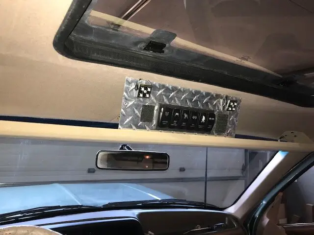

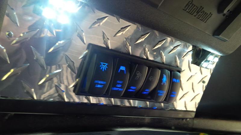

Yep. . . kind of a theme. . .
('91 Sport above, '11 Ranger below)
Just seems to be the best place to put them, at least for me. . . In the '91 Sport, started on the door panel (near window/door lock switches), that wasn't good, then knee panel, then under ashtray, etc., etc. The final option was visor shelf area (actually tied to cage, but you get the idea).
Visor also good for quick "out of sight" storage for pilferable items when I stop someplace - - phone, sunglasses, spare mags, etc. With this rig, really don't want to carve up the plastics, so the visor shelf "does no harm" to the interior. . .
Only drawback may be the lower sightlines for the driver - - not much of an issue for me. . .
Paul
Nice. Please give a how too, with pictures along the way.
I was searching today for a place to put a few rocker switches, and have been searching for a surface mount box to use. Thought of purchasing an A pillar switch mount made for jeeps, and modifying it to fit. That doesn't appeal to me, but was running out of options.
Your idea might work, or might not. 2nd gen has the overhead console between the visors to deal with.
Please give a how too, with pictures along the way. Your idea might work, or might not. 2nd gen has the overhead console between the visors to deal with.
Fairly simple install, but of course nothing is easy - - can't find a shelf for any RBVs (looked for awhile for the Ranger before stealing the black one out of the Sport. The one pictured above is for a similarly aged F-150, so I'll have to lop off about 4" per end, lengthen the lighting wires to the visors, etc. etc. etc. Will post some pics as I get to it this weekend.
Might not be an viable option if you have the overhead console in the "Black Hole", but once I get it installed shoot me a PM and I'll take some specific measurements and photos if you think that will help.
Paul
Paul
Thanks Paul! I do appreciate that.
The BH does indeed have the upper console. I took one apart at the salvage yard last weekend to see if it would hold a couple rocker switches (ARB), but it won't. I have literately ran out of places to add rocker switches! lol
rocker switches are so 1999
they even have bluetooth enabled relays these days...control all your lights, amps, accessories with your phone!!
You damn kids with your wireless controls and Depeche Mode rock & roll music! ! ! Now get off my lawn! ! ! Ha!

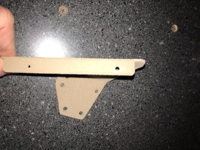

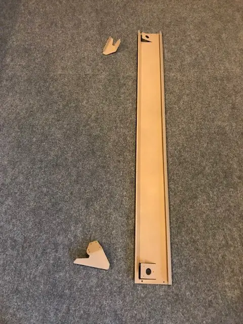

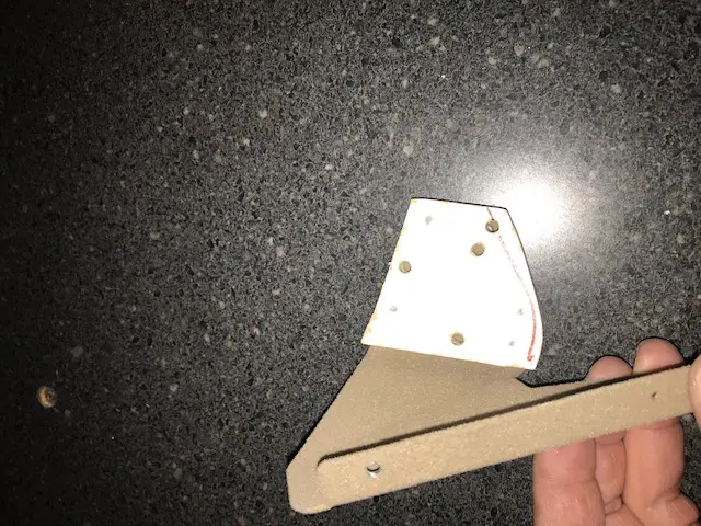

Visor Shelf Install:
As mentioned, the only shelf I could find that I figured would fit (or be made to fit) came from a 1995-96 F150, but it did come in tan to match the interior. Simple removal of visors and stems, then on to the modifications. . .
Three screws for the visor mount, bracket has five - - and of course none of them match up.
So into "template mode" to get the right fit:

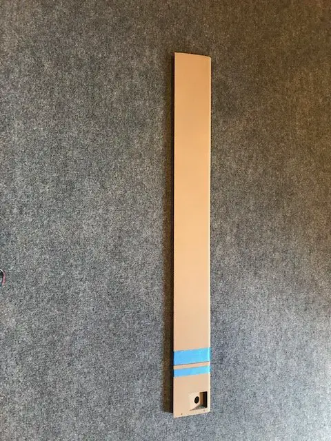

Mount the brackets and check distance to trim shelf.

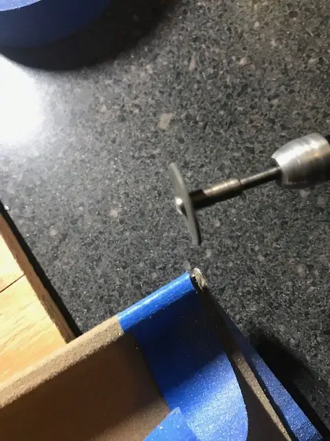

(blue painters tape protects the shelf from the jig saw)
Fine tuning with the Dremel:

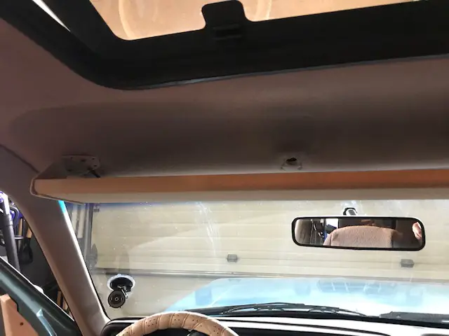

Test fit:

Visor Shelf Install (Cont.):
Too many projects lately, but got this project where it needs to be for now. . . Since I had to trim off the "ends" that had the pre-fabricated spots for the visors, had to make a few openings. . . The visor loses it's "cant", but still sits flush and folds down to block the sun.

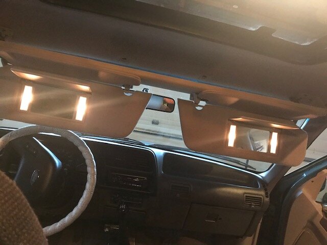

Next was extending the wiring for the light in the mirror section - - nothing special, but takes time since the visors are 3-4" lower than OEM.
Proof of "light":
The "center" tab mounts near the rear-view mirror are mounted to the shelf similar to OEM to secure the ends of the visors.
And test fit for the switch panel harvested from the old Sport.
(Full Disclosure: This photo taken before the visors mounted)
Still need to find some larger tan colored fastener push-pin clips to cover the holes in the headliner where the center tabs for the visor mounted.

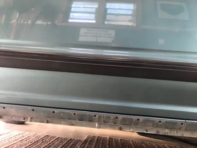

Received a "Christmas in July" package last week from Brian1 with parts for the build, so started some deconstruction - - so off with the plastic cladding. . .
Wheel lip trim also removed:
Saved/salvaged the "unobtanium" Bushwhacker Extend-a-Fender flares from the 'Sport - - will need to be reconstructed as the damage from the wreck added some more scars to them . . . in time.

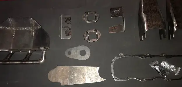

And eye candy from Brian1:

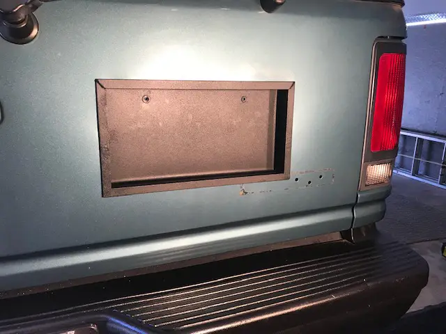

Some more test fitting . . .
(had to rework those top corner edges - - not "clean" enough).
