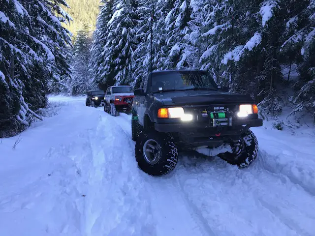

Took the wife on a little shake-down run and recon on part of the route that will run next weekend as a memorial for Phil.
About 12" of snow up at about 2,000' AGL, more dumping now and for the next week. Neat aspect about living out here is that you don't have to deal with snow if you don't want to, rarely snows at sea level, but go to the mountain forest service roads and you'll find it easy enough from November - April.
Have to run down an issue with the ARB airline, but wasn't a "hard" day, locked the hubs, aired down to 20 pounds, and kept it in 4 Hi.
Was able to assist Subaru owner who was stuck, so glad to have added the shackle to the rear bumper in preparation of next week's run.

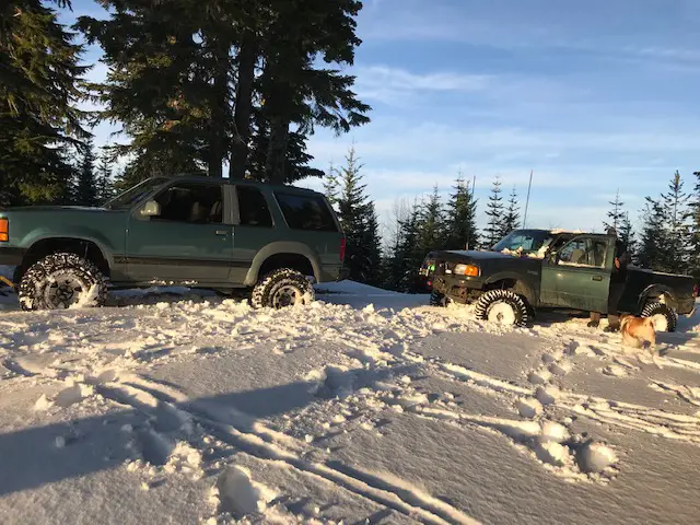

Did a run on Saturday in honor of Phil, aka Albino94ltd, who passed last November. Phil was a long time member of this site, always ready to grab a tool or spare part from his voluminous tool kit to lend a hand for trail break-downs or maintenance on anything RBV.
Phil in Moab, May 2016:
(Think photo taken by Suicide77, maybe Rock Ranger - - just want to assign credit to the photographer). . .

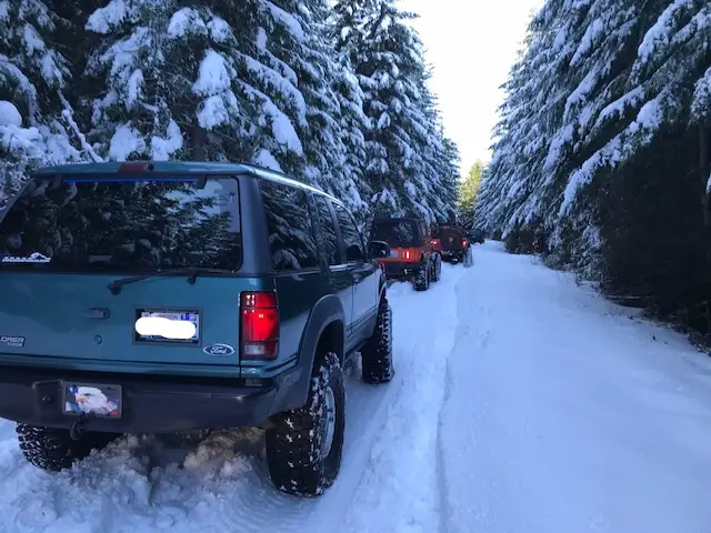

So, six rigs and about ten of us met up to run up to Lonesome Lake, a long-time snow run destination for us in the Pacific Northwest.
Heading up the road to the lake:
Up at the lake, Kevin (DiffWhack) has Phil's Explorer body on his old drive train, I've got Phil's axles and suspension under my rig. . .

Phil's Tool Kit still in the back of his rig, now owned by Kevin. . .
Phil's bumpers went to Jonathon's Ranger:

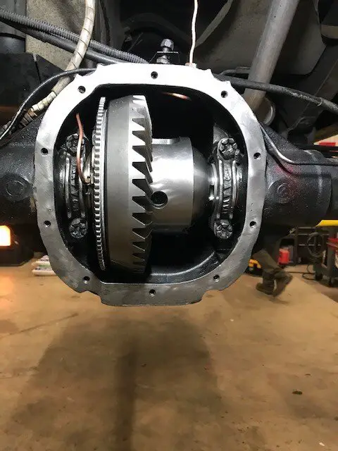

Not much going on since the run. . . Found out the problem with rear locker - - looks like my rear gears chewed up my copper airline so waiting on a part from ARB.
Here's a pre-install picture, airline out of the way - - interested in any advice for those familiar. . .
When we cracked the diff cover, only a few inches of copper tube left - - rest gave it's life to add a nice "coppery" look to the gear oil we drained out . . .

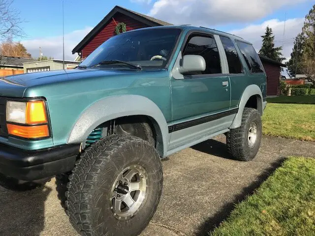

Other than that, had to remove the rock sliders to mount the front fender flares, but the rig looks better with all flares mounted.

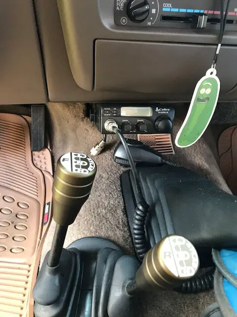

Kept the green/sand/brown "earth-tone" look on the inside, complimented with new green Atlas shift knobs.

How my tube is ran. Don't know if that is the best way, but since installed, it has survived a couple long road trips, and wheeling in the Rockies, and a hardcore off road park.

I have lost a copper air line twice in the FJ cruiser.... that thing sucks because its a 3rd member like a Ford 9" so you have to stab the whole carrier into the housing, it is really difficult to not disturb the air line and move it. They are so delicate! Chase at ECGS changed the routing of the copper line both times I sent it back to him for repairs, the 3rd time must have worked because its been fine for years now.
That copper line should be routed like @gmanpaint posted, your routing is asking for trouble with fluid and bouncing going on in there
I always say ARB air lockers are only as good as the installer, so true!!
Yep, - - Kevin's assessment as well, too much fluid movement affected the airline, allowing it to contact the hard bits. . . Will post a pic from the ARB manual later, it's install photo shows pretty much the same routing as the guy laid out for mine. . .

From the ARB RD81 Manual:

Been away for a few weeks, but back now and got a chance to run up to Kevin's shop to re-work the rear ARB. Here's the new airline routing:

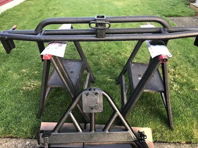

Currently rehabbing the rear bumper from the wreck back in 2017 to install on the rig, been running without a spare for a few months now. . . Pics to follow.

"Deja Vu All Over Again . . ."

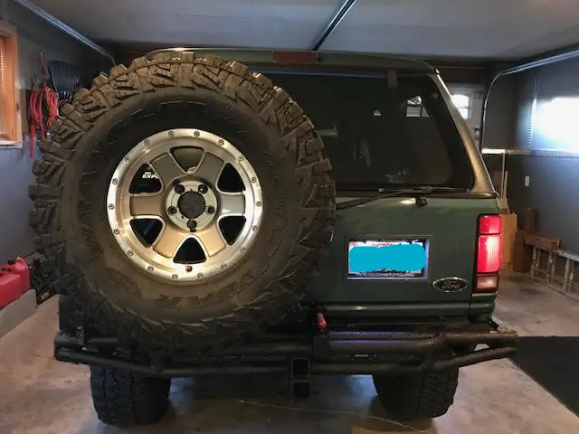

Had to massage the bumper to get it fit up correctly - - either from the wreck or there is a slight difference in the frames. . .
That 33" tire looks yuuuggge!
Still not done, have to wire up the back-up lights (barely visible between the tubes) to a switch on the panel and some other stuff. . .
