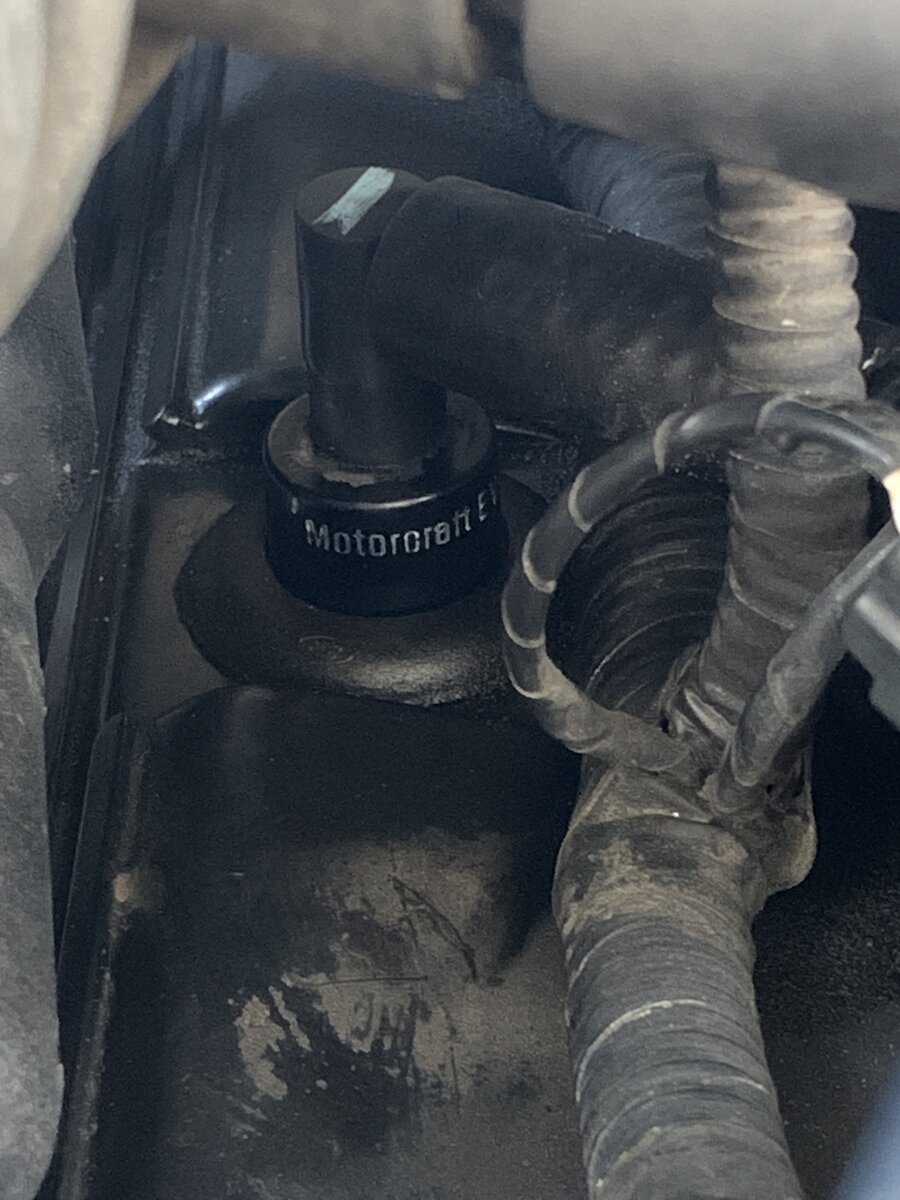

No worries. The easy solution sometimes evades us and at 1115 at night, it certainly did. I'm going to look at mine today and see if there's any part number on it.

Went out to check, no visible part number. But I have another question - and I feel kinda dumb - how the hell do I remove it? Twist clockwise? Pull really hard? The last one I dealt with, it was just a push in. Nothing fancy like this :)

Advance Auto says it doesn't fit an 03 though?
And still need to get the old one removed. I'll be damned if I can get it to budge.
Check rock auto they have ones that look exactly like that also good thing you checked lol mine looks nothing like that mines small black and pops in. You said yours was an 02 aswell? Weird mine is aswell and they use different valves
Also it should twist out be careful though I heard the threads are very fragile on the 4.0 valve cover not sure about the 4.6 but I’m sure it can’t be much better
