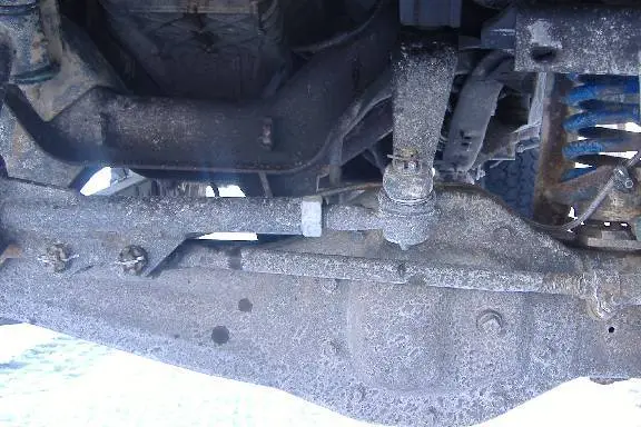

So the pitman arm is drilled out and the tie rod is on and it's ready to go back together. We are going to wait on the other part for later but hopefully we will have that figured out soon. I might be sending Infragate an email with some questions before we are all finished.
The old one, sorry I didn't get a good picture before we cut it up.

It was really easy, we just cut off the old end with a band saw then cut another inch or so off to make sure it was straight once we had the end out and to make room for the newer tie rod that was bigger. The part we used was ES2234R and we got it at Checker but any tie rod that is 7/8" will work. The 18 thread we got because that is the tap/die that he has and you also need to know right or left threads and his tap is right handed threads.
Once you cut the old part off you just tap the new threads and you are done. We did measure the old part to make sure the new part made it as long because you will have some threads sticking out.
Once we get back from Chinnaman this weekend I might take it apart again and start working on the bearings because that would be so much nicer.

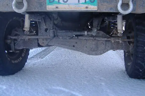

unclemeat said:
Please post additional info. I can have a machine shop fabricate it if i have enough information. Or,
Infragate are you interesed in making one for me?
:D
Lemme see what i can do, im in the process of moving for the next couple of weeks but i know i do have some material around that was left over. Gimme a bit and i will either get back to you with info or maybe i can make one for ya ;)

I got mine done but I didn't use the Chevy TRE. Count on Chevy to use a 7/8 UNEF thread for something. Not one machine shop locally had one. I didn't care to spend $250 Cdn for a tap I'll use for 2 min. Believe it or not but an M22x1.5 tap is easier to come by. By going that route I was able to use a RH D35 outer TRE. It may not be as large as the Chevy unit but if it's used else where, then it cat be all that bad. After checking the taper to the pitman arm, it fit perfect. A buddy of mine had an M22x1.5 tap and he tapped the link for me.
Thanks for the idea. I'm glad I saw this post. ;)
