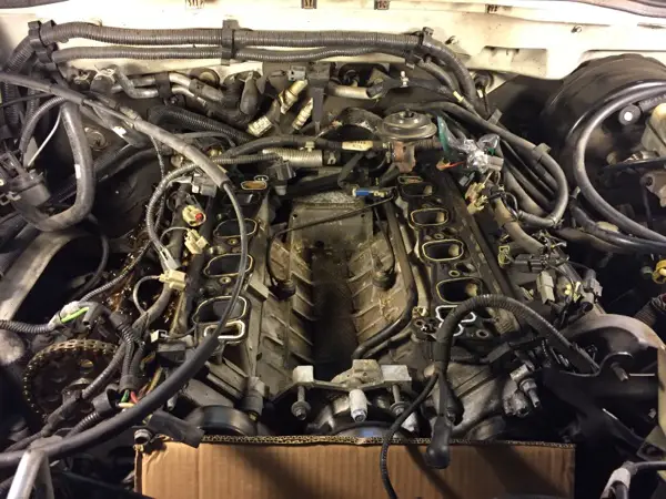

Phase 1 of 3 was to finish rebuilding the '94's engine and get it back on the road.
Phase 2 of 3 has begun. See if the '03's engine is salvageable. Should just have two blown head gaskets. Heater core hose check valve (?) busted on the previous owner causing an over heat.

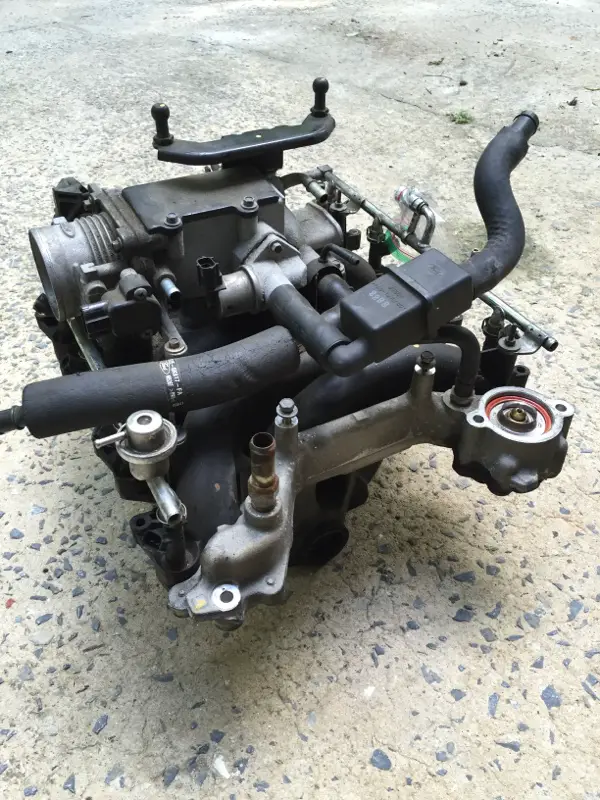

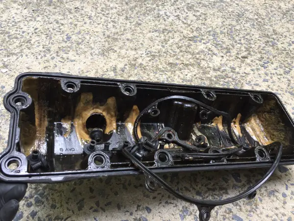

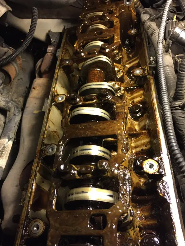

A friend and his 16 year old son came over today. Had is son remove the intake and passenger side valve cover. Definitely some coolant in the oil. Timing chain also had slack, yet no noise at start up.
