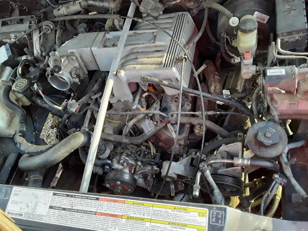

here are two engine pictures
It's hard to see from this view the space between the valve cover and the bottom of the lower intake
Here is another view. Mice have made a mess on top of and below the upper plenum. I can clean it up when installing the spacer. With Don's help I have convinced myself to keep it fuel injected. This will be my 1954 F100s future powertrain so any overspending will be the '54s fault. (LOL)
