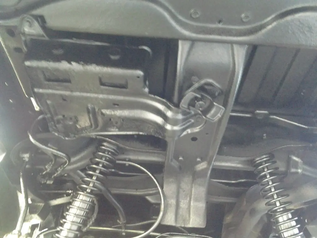

Anyway, a few weeks before the smashing, I put in the warrior shackles and the Coil over shocks the PO gave me with the truck and just haven’t posted the pics/writeup. I don’t know what shocks these were and I forgot the check the box at home but I’ll find out an update the thread. With the before and after measurements It gave me 3” of lift at first measurement. I’m sure it settled back down a bit and when I get the truck back I’ll measure again. I wrote them all down on the work bench. disregard the side to side difference. Truck sits level, I think my driveway is lumpy. Install was very simple, just watch the height of the truck so you don’t pinch a finger or take a leaf to the face… and use jack stands! These bolts didn’t even need pen. Oil! In the after pic it doesn't look like much but my driveway has a slight slope to it. look at the difference in wheel well height.
And onto the pics:

I'm guessing the coil-over shocks are Monroe Load-Levelers. I'm not aware of anyone else offering them.
Good to know. I'm going to run this same setup on my Sport Trac.

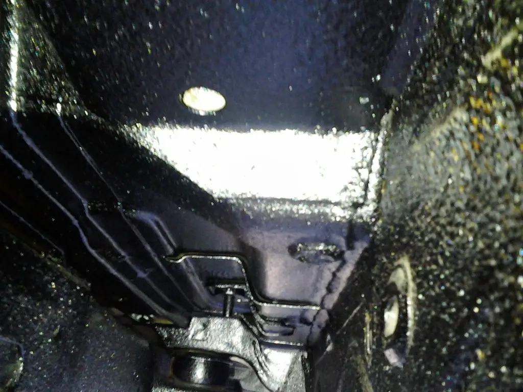

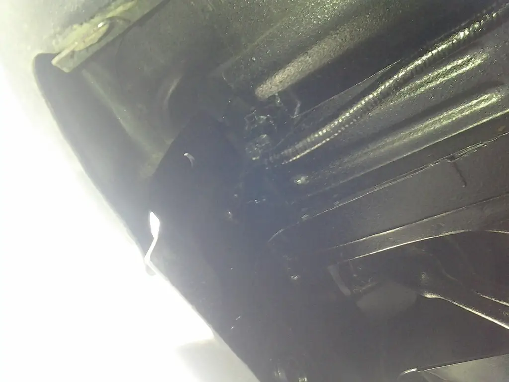

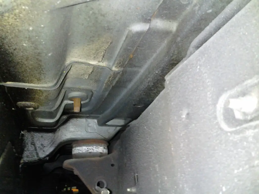

So it’s been a bit since I visited an updated my thread. After the body work I knew it was time to Bullet…er uh Rust Proof the old girl for snow duty. It brings a tear to my eye to drive this thing in the slop and luckily it’s been a mild winter. Also, this has been a second vehicle too so it doesn’t see much duty lately. My main intent was to corrosion proof every nook and cranny on this thing. MY steps were very simple:
1. Clean everything
2. Remove any bit of surface rust to keep it from spreading or bleeding back through
3. Undercoat to protect (before oiling to promote adhesion)
4. Oil or grease all seams and spaces
5. Wash as often as possible!!!

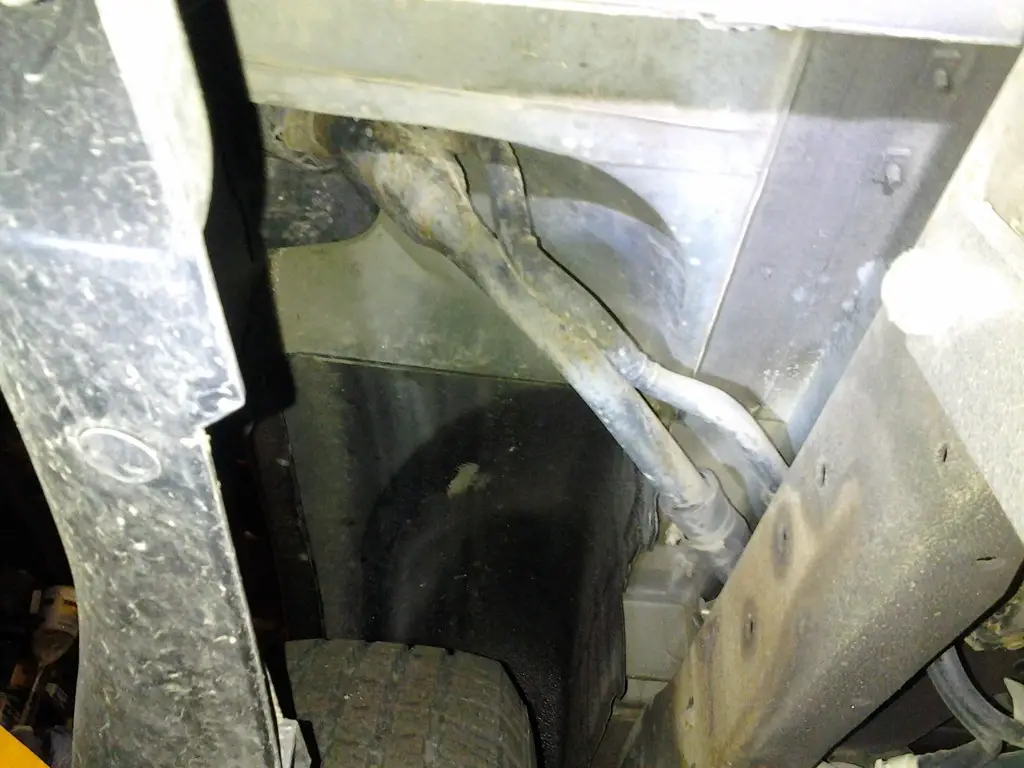

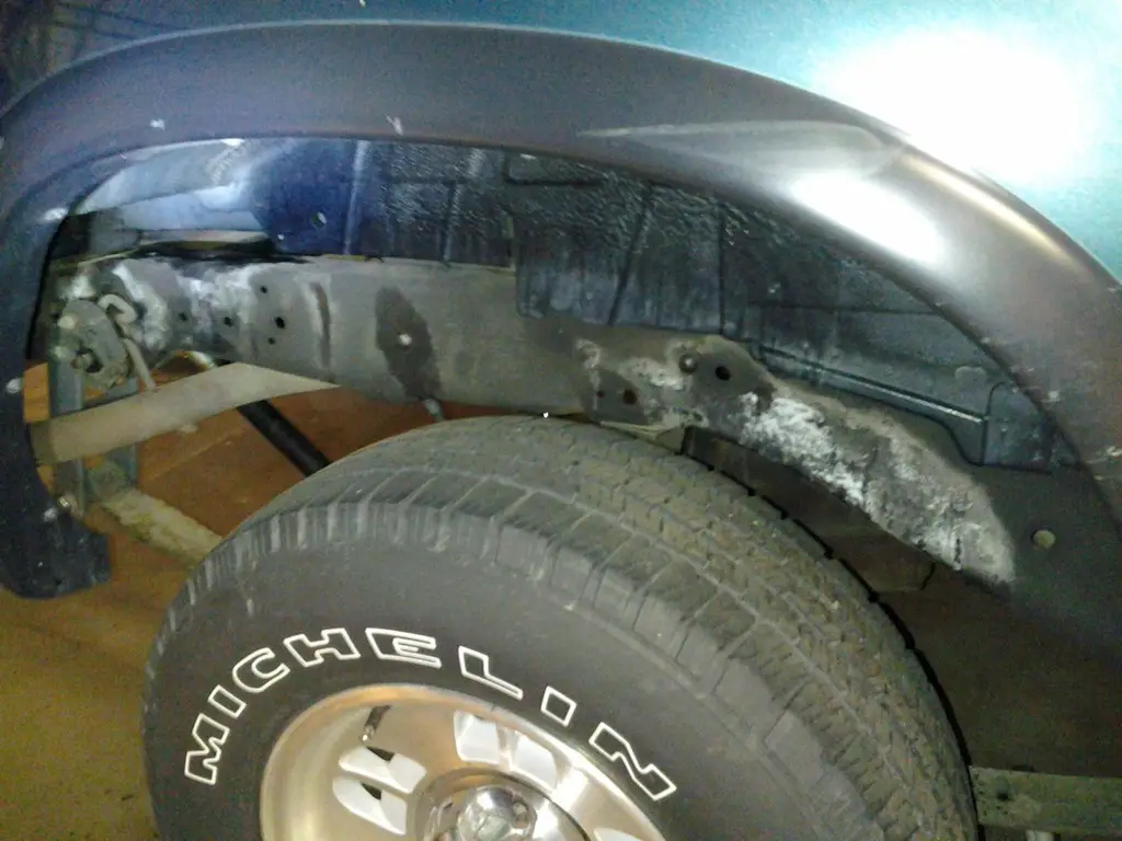

The previous owner had it done with Krown and was very meticulous so I lucked out there too! Most of the hems and joints had a residue already from that. Anyway, first I cleaned it as thoroughly as I could. I crawled under it with a pressure washer and sprayed every bit of dirt an grime I could find. If you seen the undercarriage pics previously you know that wasn’t too hard because this thing was so clean to begin with. After a stretch of a few dry days I then painted ever spot of surface rust (very few I might add) with a chemical called OSPHO to “kill” the rust. This is basically Osphuric (?) acid that pulls the oxygen out of the rust and converts it back to metal (read up on it for like a week first, best stuff out there). That’s the white crap in the pic below just to show how it looks. I maybe used an ounce of it on the Whole truck! LOL just a few tiny spots on the frame…. So, Then the next day I wire brushed that off and sent it into my buddy’s shop to be undercoated. Good to have a friend in the business at this point because he really did a great job on it for me. Also, The body man that did the previous work for me packed that replaced rocker section with rustproofing and undercoating too! Pics below starting with pics of it before I did anything….
Ospho:
Frame Pic:

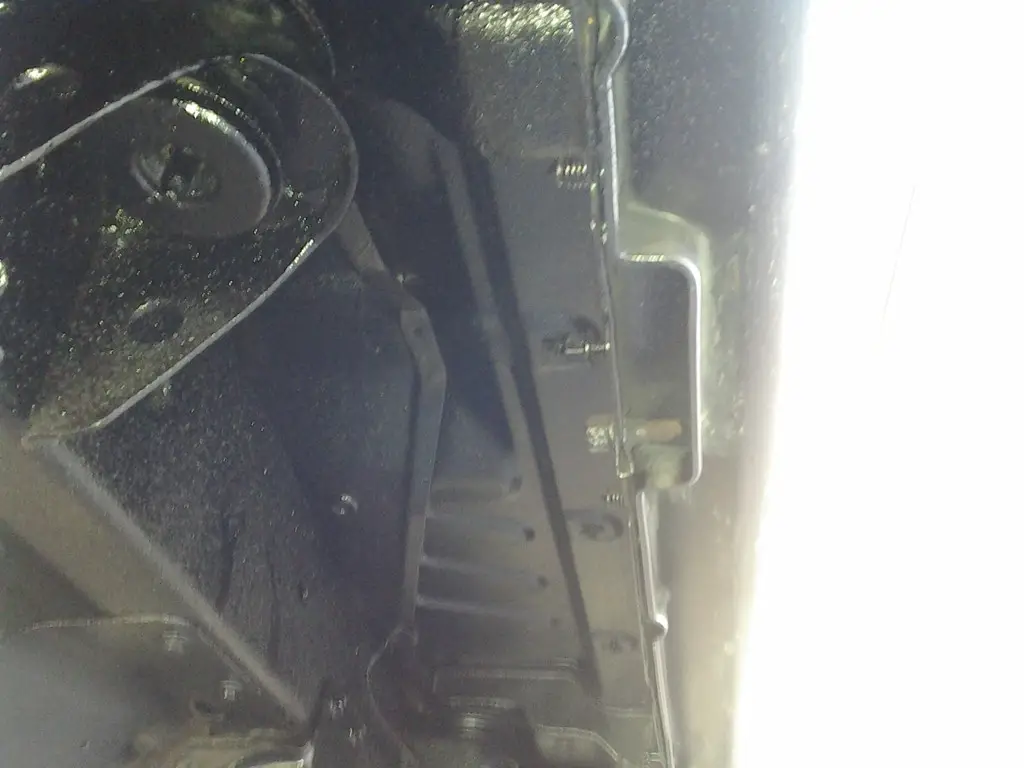

Undercoat pics:

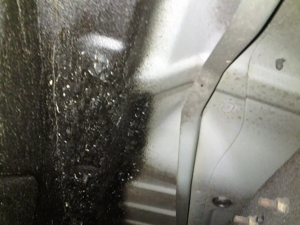

I recently got done going through a bronco (had to sell in my 1st divorce …*sniffle*.. still hurts) that I extensively rust proofed. When I bought that truck the body had a sort of “grease” all over the inner panels that did an awesome job of keeping the moisture and hence the rust out of it. I set out to find that stuff again an came up with 3M rust proofing (#08892). It’s actually a cavity wax that sprays into the panels to protect them. But it goes on like spray grease an after a bit dries to like a wax… anyway, I had a nozzle with an extension left over from a can of eastwood internal frame coating (don’t know if you can get just the nozzle from them) that fit on a gave out a nice pattern. The extension tube is about 2 feet long and I stuck it everywhere and spray it as I pulled out. Went especially heavy in the rear Quarters over the wheel wells till it was dripping out! Stuck it in every hole an filled ‘em up! Went through almost 5 cans! Ddint take any action pics on this but this is what I used:
3m Stuff:
Eastwood extension tube an spray pattern:
